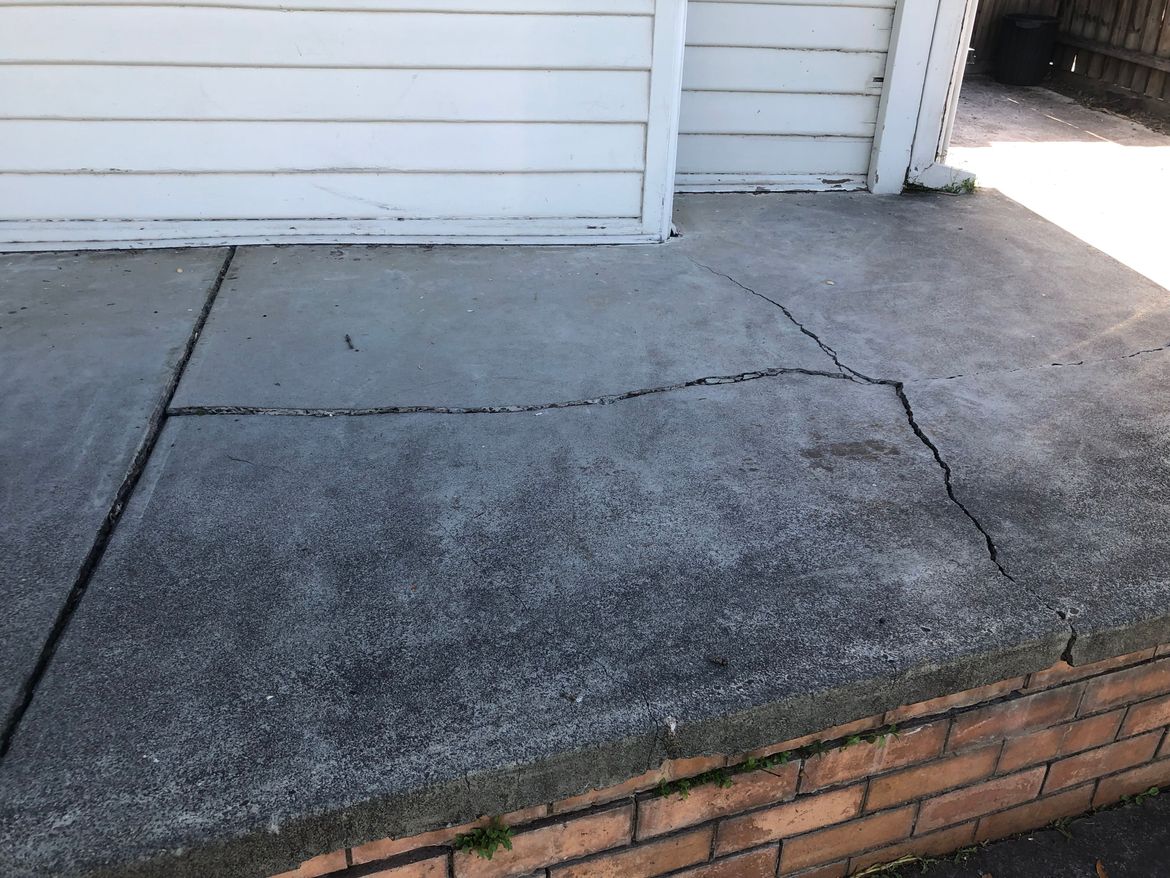

The photo shows the extent of the crack, wondering what my options are here? Also wondering what would cause a crack of this magnitude?
Hi @tigerzen , thats not a pretty sight, looking at the diffence in height where the craks are i expect there is no mesh in that slab.
best is to remove the old concrete and get it re-laid.
you can remove it your self by breaking it up and then get a grano worker to redo it or just pave it
Thanks Wooshka, it's not a pretty sight. It's become worse since we had a minor earthquake here in Melbourne. What are the tools required to remove the concrete, it's only about 100 mm deep, what can I expect to find underneath the concrete?

That's sound advice coming from @wooshka. I suspect that water has entered the cracks and has slowly softened the soil foundation underneath. I propose engaging the services of a professional to put new concrete in that area.
Hi @tigerzen , seeing that it doesnt look like there is any mesh in it, If you are keen for a good work out, if you buy a decent long hand handle sldge hammer, like this https://www.bunnings.com.au/trojan-8lb-3-6kg-fibreglass-sledge-hammer_p0131379.
get a lever under the edge over the concrete to lift it up a bit and then take to it with the sledge hamer , it will crack up into smaller pieces relitively easy.
