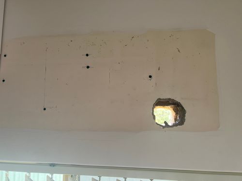

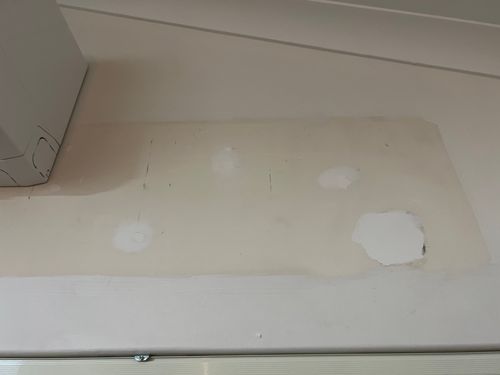

Have a 9cm Diameter Hole from AC removal I am patching today + patching from old screw holes.
Plan is for the interior to fill with Earls Expanding concrete, then UniPro Multipurpose Filler - Sand and Paint.
Was going to apply the same process to the screw holes or it that overkill with the multipurpose filler being sufficient?
How long should I wait after applying the expanding concrete before the filler?
