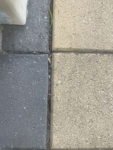

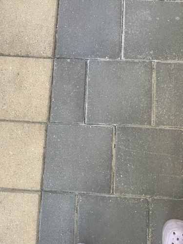

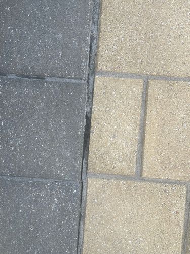

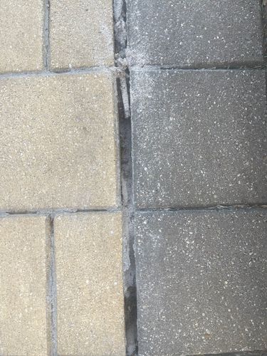

@JacobZ95 has touched on some quite relevant points there. Pavers are moving objects, so anytime you add something between them, it's only a temporary solution that needs to be topped up. However, I suspect what's happening here is the pavers were laid, and later, the "gaps" were filled. There are gaps shown in your images, like numbers 2,3 and 4, that should be filled with polyurethane sealant. But, the area between many of the pavers is not a gap per se. It's a depression left when their sides are hard up against each other. You're effectively trying to fill the rounded edges of the pavers to give it a grouted look. The polymetric sand is dislodging as there is not enough gap between the pavers to lock into. However, I can see that there is a large enough gap in some instances, and the sand has still deteriorated.
I suspect that it's along the lines of what @JacobZ95 suggested, and the movement in your pavers due to inadequate compaction has caused the polymetric sand to crack and then deteriorate over time.
