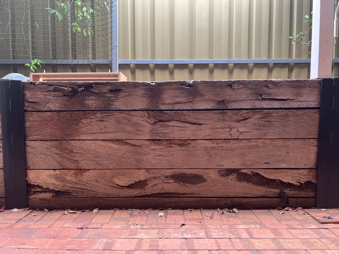

Hi Team,
We are planning to do a DIY renovation in our pergola and want to hide these old worn out sleeper retainers.
Will we be able to use https://www.bunnings.com.au/specrite-1800-x-902mm-pre-oiled-merbau-alternating-slat-fence-panel_p8500281 Pre-Oiled Merbau Alternating Slat Fence Panel to these using just screws.
This would be our first DIY project and we're so impressed looking at so many innovative uses of the Merbau panel.

Hi @anubakshi
Those are nice panels too use good choice.
I would pre drill your panels so the screws dont split the timbers.
Use about 40mm long wood screws as those logs will bow in and out and at places the extra length will be needed.
Now as a DIYer you will quickly discover those panels wont be a perfect fit for your existing opening. so there panels will lend them selfs to be trimed to size. But we might need to add extra timber stripes behind the slats like whats already there to support your cut. There four cross slats per sheet, just add new ones near the cuts at need.
When you use extra ribs you can trim your panels to any size.
So buy your panels measure the cross timber rear bits and buy a length of that if you need it. I would use Liquid nails exterior glue only to hold the new rib in place Before you cut it. wait 30 mins for glue to partially set.

Hello @anubakshi
It's great that you've received excellent advice from @Jewelleryrescue and @diy_hausdesigns. Just to add to the suggestions made, I recommend installing the SpecRite 1800 x 902mm Pre-Oiled Merbau Alternating Slat Fence Panel at least 25mm off the ground to prevent it from getting wet.
Not only will it prevent the panel from getting constant wet feet, but it will also extend its service life. I also propose doing a test fit of the panel, this will give you an idea of where the gaps will be or where might need to add timber inserts. This will help you get a uniform straight installation along the length of your retaining wall.
