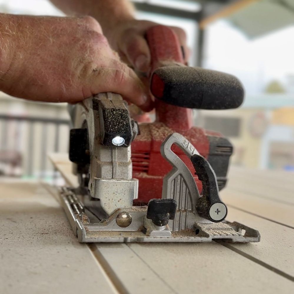

Make sure you measure up the space. We used 2.5 boards here, so we needed to cut one panel down (with the circular saw) to fit the space.

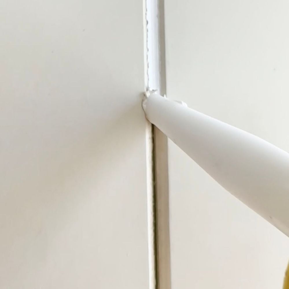

These boards will hold with Selleys Liquid Nails. We have a nail gun, so we did tack in a few places as our walls, being very old, are not a smooth/straight surface. Don’t forget to use No More Gaps on the joins.

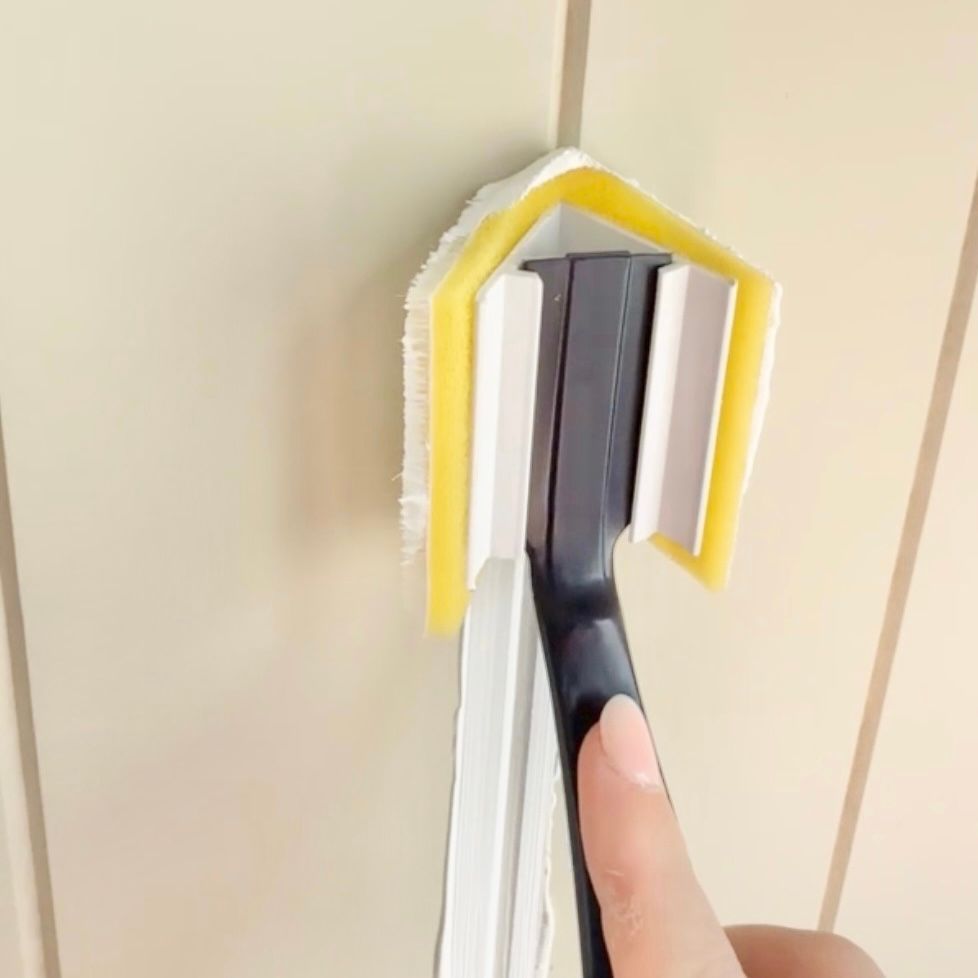

Time to paint. Using the corner pad applicator will make painting in the grooves so much easier and gets much better coverage than a paint brush. Make sure your roller isn’t too overloaded with paint. There is no need for primer on these boards but to get a crisp white, a coat of primer will prevent you needing additional top coats.

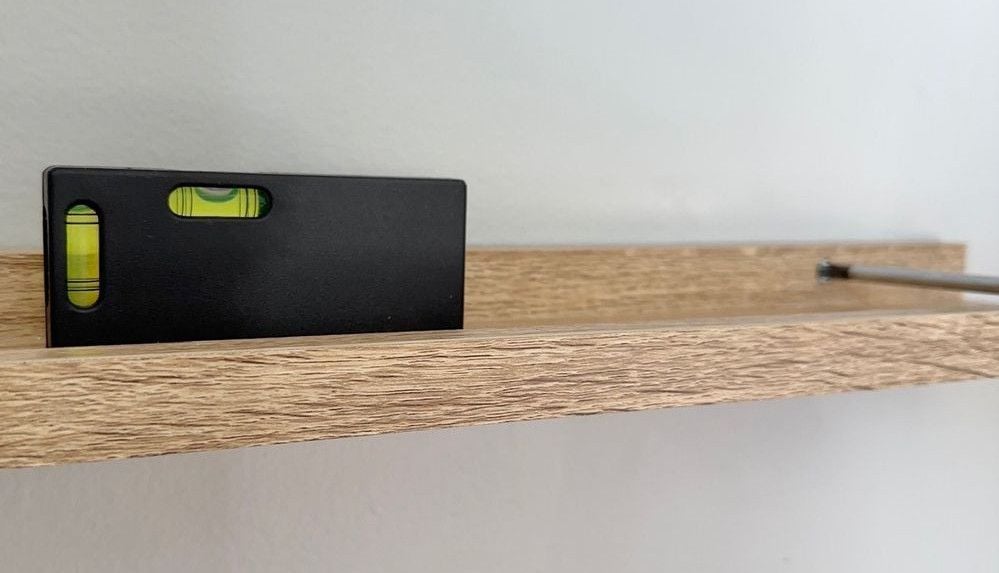

Time to add a shelf. Flexi Storage photo shelves are so easy to install and come with instructions. Just make sure you have a spirit level to ensure the shelves are level.
