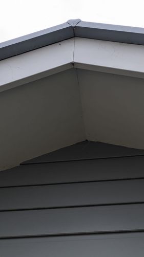

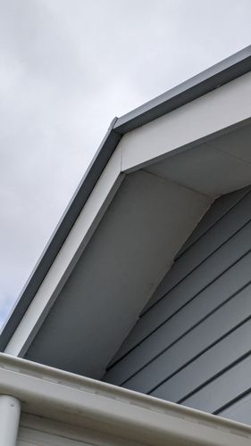

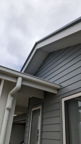

Looking at doing some maintenance on my front facade and I've spotted the truss joint looks in need of maintenance.
I was thinking external seal, prime and paint.

My apologies for the late reply. If the paint is starting to peel, I suggest sanding the damaged section down and then prime and paint. You can then place the sealant at the very end. Sealing and painting over a damaged section is not advised as the damaged portion will get weaker and fail.
