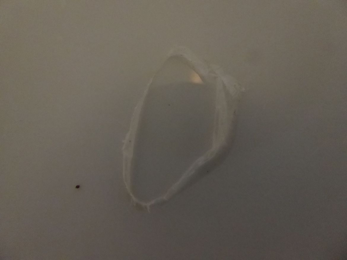

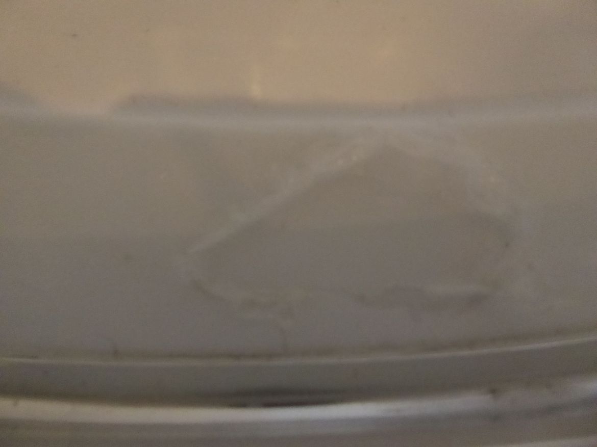

I have discovered that my acrylic shower base is coated with plastic, which is starting to peel, so I have some questions to ask. Do i pull off the plastic? If I do, do I need to recoat the base with something and if so, what do I use?

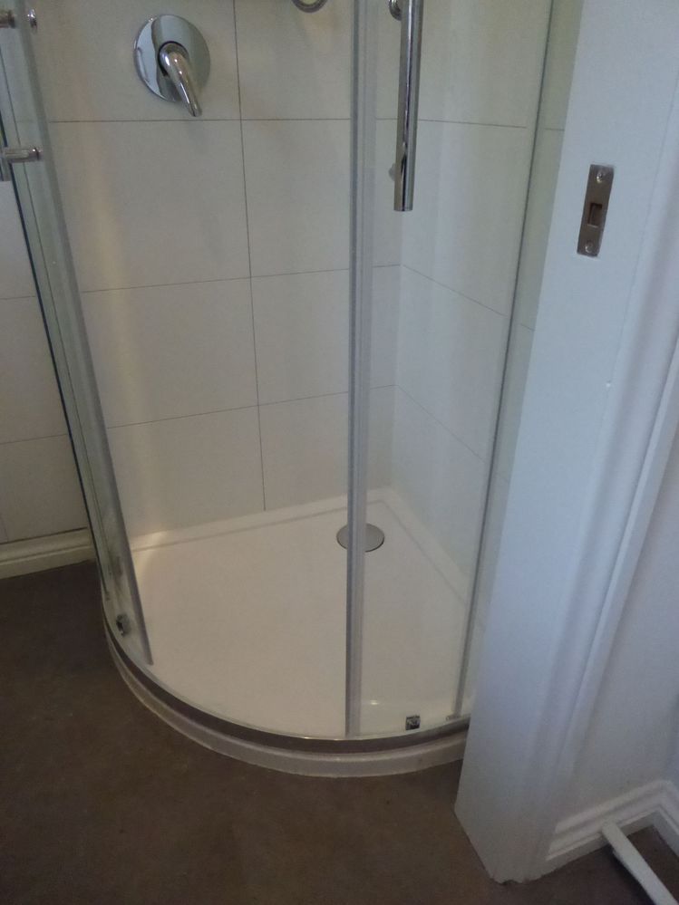

Do you have any more information about your shower base that might help members assist you? For example, do you know how old the base is? Could a previous owner have applied something on it as a repair? Do you know the manufacturer of the base?
It might also be helpful to see some wider photos of the whole base so members get a better idea of what you are working with.

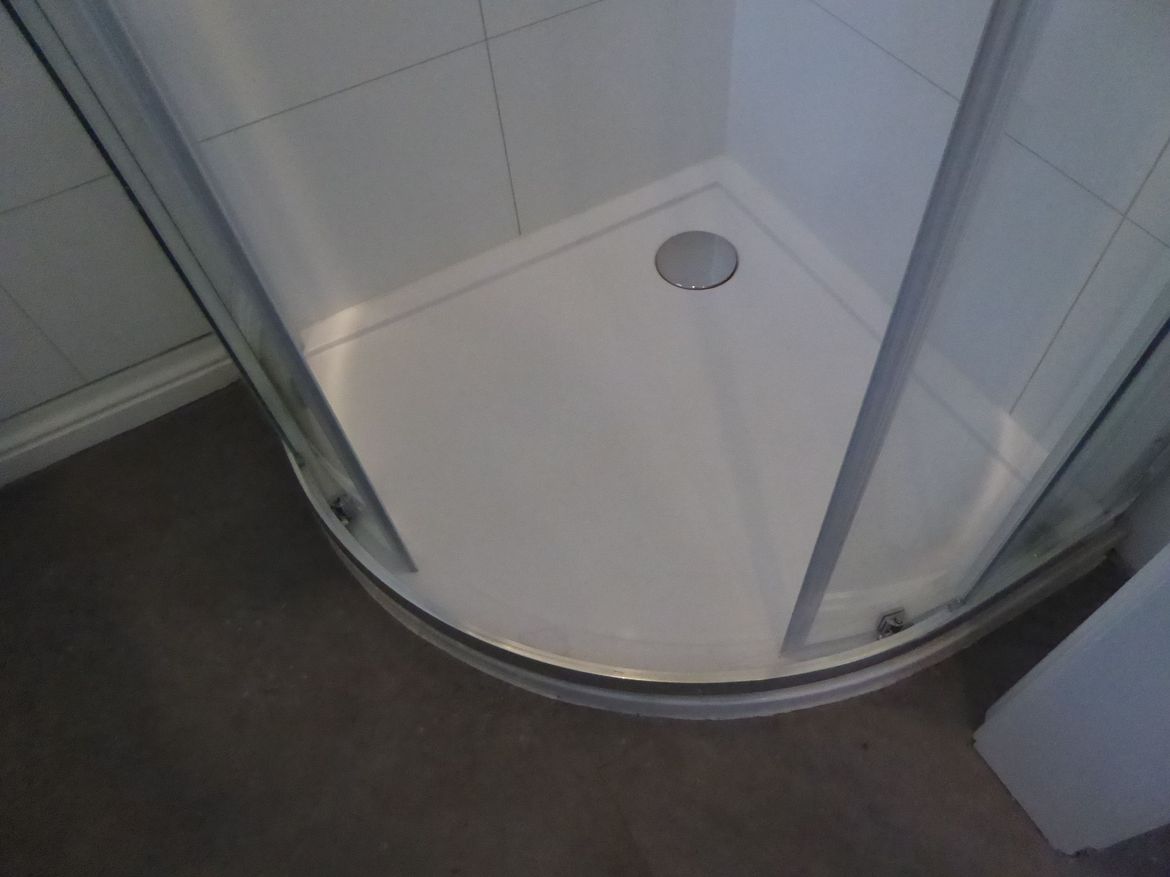

Hi Jason,
The shower base is probably 3 years old - not certain. It has not been used more than twice as it's in a 2nd bathroom. I had it installed.
Please see the added photo attached.
Is it possible that this was just plastic designed to protect the shower base during transportation, and should have been removed before installation @Rocjo?
If you could find the documentation from the purchase and it was a Bunnings product, we would be more than happy to confirm with the supplier.
I have wondered whether it was meant to be peeled off as well. I'll check through my receipts to have that confirmed by the seller - which is probably Bunnings!
I'd be inclined to be thinking along the same lines as @Jason that it's a protective coating. There's no reason I can see that a shower base that is three years old and has been used a couple of times would have a layer delaminating from it. I've also never come across an older acrylic base with peeling layers. My money is on its a protective coating that was never removed.
If you come across a manufacturer name and it is one of ours, I'd be happy to confirm. Typically, most acrylic bases would have protective plastic on them when shipped that needs to be removed. The installer might just not have noticed it.
If it peels off relatively easily, I'd be happy for you to just remove it.
