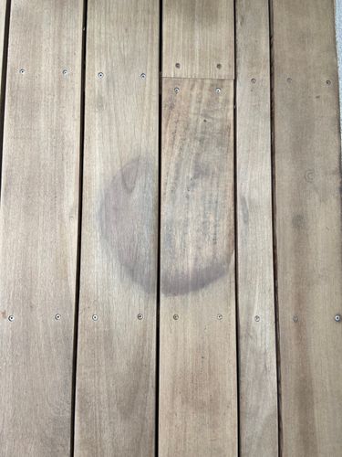

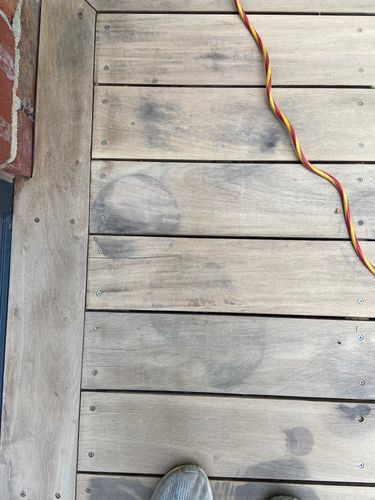

Hi Legends. I’ve just sanded back my deck and there are stains left from the bosses pot plants. I’ve tried vinegar, bleach and metho with no joy. How can I get ride on them? I have tried sanding back more.
Cheers,
Graeme

Sanding is going to be the best approach for this problem, but you say you've already sanded the boards. It seems the damage is deep into the timber. If you can't sand any further, I suspect there's nothing further you can do, but let me tag some experienced members such as @JacobZ95 and @EricL for their thoughts.
Hey @Coaster,
What @Jason has said is correct, unfortunately it looks like the stain has penetrated deeper into the timber and stained the fibres further down in the wood.
You could try using an aggressive grit sandpaper on a belt sander and really “give it some”, but it’s likely that by the time you got rid of the stain, you would have a few boards that are considerably thinner than those around them.
It is likely that the only real way to get rid of these stains is to replace the boards.
Happy to help further if you’ve got other questions.
I'd recommend giving Feast Watson 1L Woodclean a go. I've used it for various stain removals on timber, and it works like magic in certain circumstances. I'd be rather hopeful that it would either remove or minimise those stains enough that they'll be disguised once you've re-oiled and stained the deck.

After you've oiled your deck you might like to invest in some terracotta feet to get the pots up off the deck.
