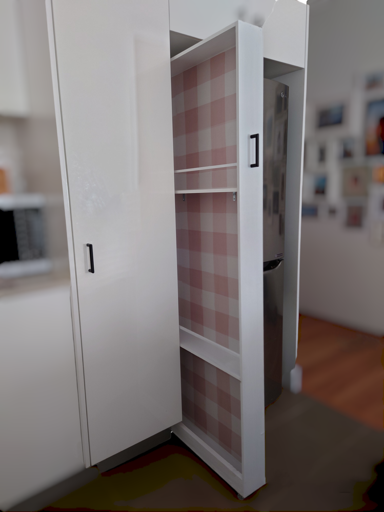

A rolling pantry built from painted MDF panels, Pine trim, swivel castors and lined with wallpaper.
The project
I had this empty space between fridge and kitchen cabinets so I wanted to fill it with a roller pantry to make it look better and create extra storage room.

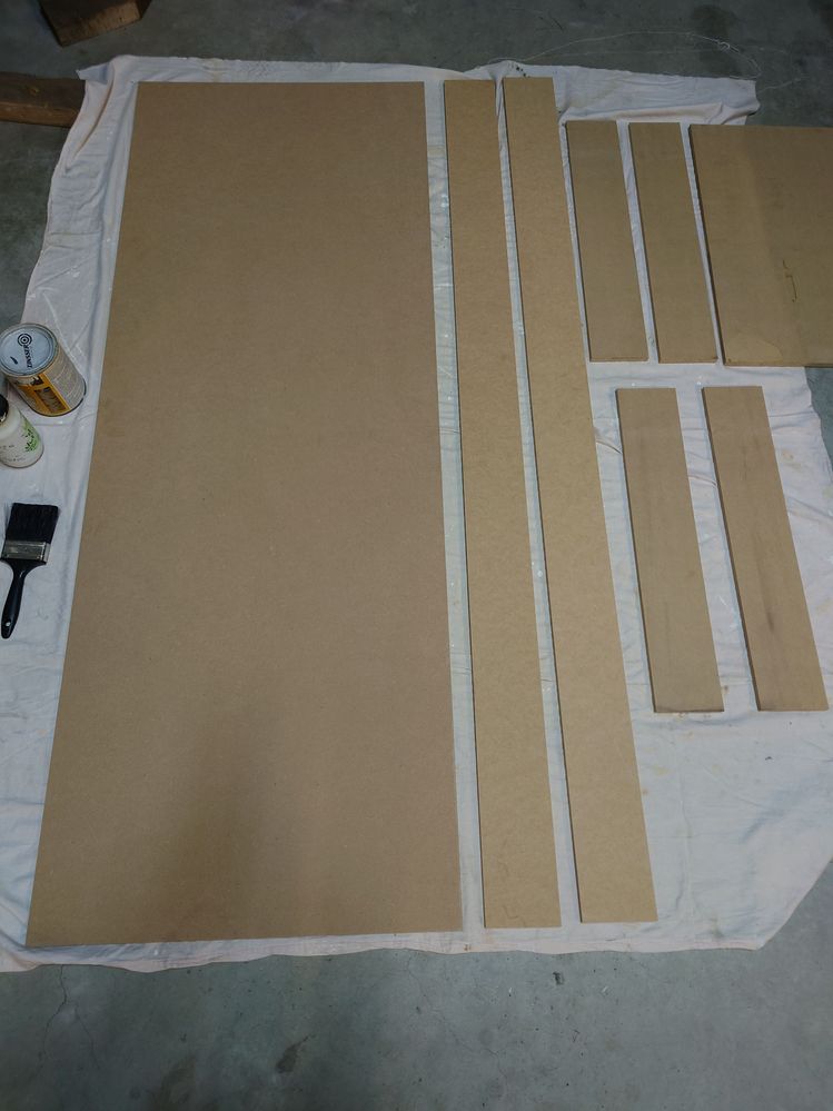

Cut the MDF board to the length you want or ask Bunnings to cut it. Prime the MDF boards and paint them. I didn't paint the splashback because I used wallpaper, but it was recommended to prime it before adding the wallpaper so that's what I did.

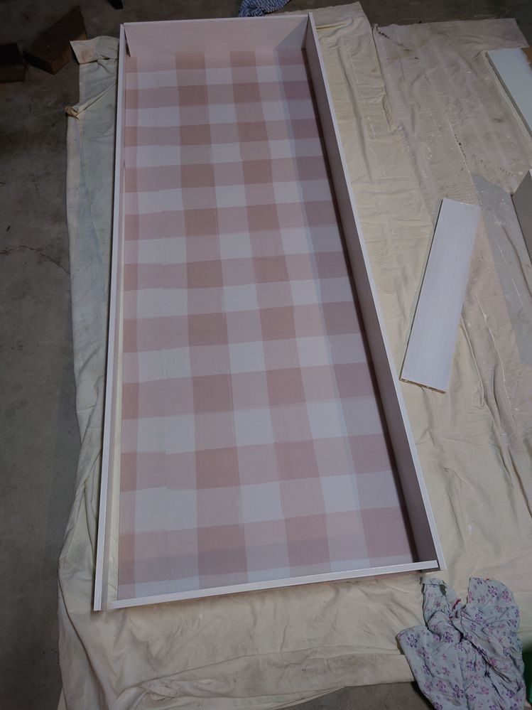

Build the outer edge of the shelf. Make sure the corners are at a 90 degree angle. I did add wallpaper to the back of the pantry to bring up some colour to this otherwise white pantry.
Attach the outer edge to the splashback. I used liquid nails first to make sure it stays in the right place, and then used flat head nails to nail it to the splashback.

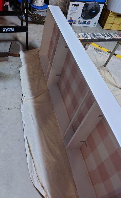

I then added the right angle brackets under the shelves and added the shelves to the splashback. I also added Pine trims to the top of the shelves so it would look better, and secure the items so they don't fall down. I added a piece of timber to the bottom to balance the weight.

Then I caulked the edges and gave a last touch with the paint. I never caulked before and it really makes the joints look better. Then it was time to add wheels and lift it up. One final thing was to add a handle and I was ready to carry the rolling pantry to my kitchen.
