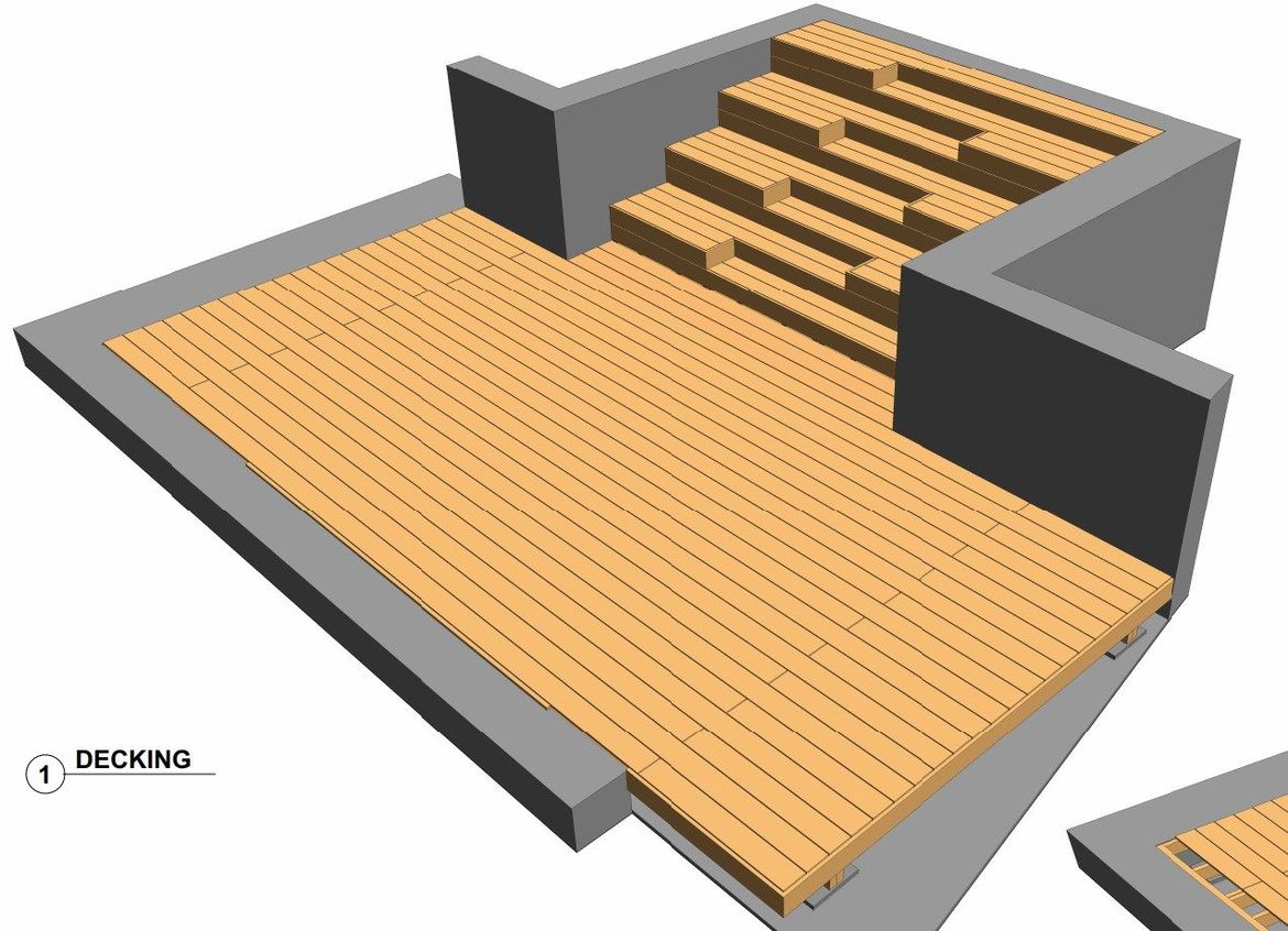

Hi, I'm building a low deck soon. The design basically is to have a 2-45x140mm bearer with a post base at every 1300mm centre to centre. Footing dimension is at 300x300x150+(depth). The bearer seats on the post base and has a vertical clearance of 50mm - 200mm from the ground as it slopes towards the drain. I'm using H3 treated pine for to all my timber. Above the bearer is a 45x90mm floor joist with a 450mm distance from centre to centre. 140mm merbau will be used for decking. Additionally, the deck will eventually be covered with roof in few months later. I badly need a professional advice on this as I already purchase all the materials need in Bunnings. Thank you very much and more power to you.
