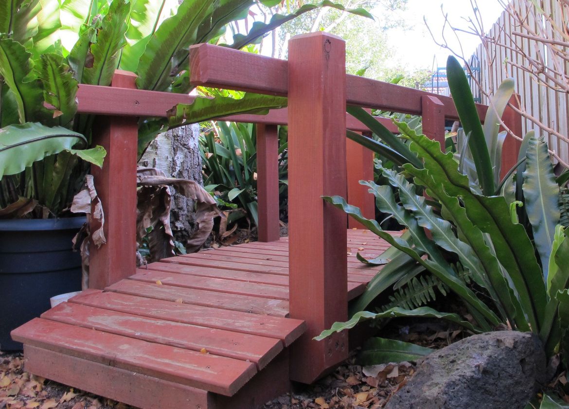

I decided to have a go at building a bridge for the garden the problem was this project needed tooling I did not have. To swing the arc for the bridge I need some extra tooling, clampe big enough to hold the job, a jig to mount it all on, brackets to fit the router and an arm long enough to swing the router. I finished up with a swing arm 1.5m long to get the small arc and 1.8m for the large arc. Much fun. The weather has taken its toll and now needs a new coat of decking oil.
I have posted this bridge in its full splinder of autumn
