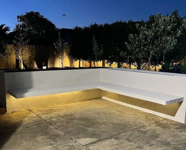

Step 1
The first step was clearing the area and cutting down all the sleepers to size, and then building the frame of the seat from the ground up. The seat measures 3m on the outer side and around 2.5m on the inside where the seat is. The offcuts were used to fill in the smaller ends of the whole bench.
Step 2

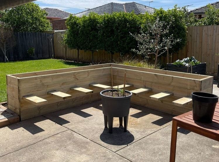

Once I had put together two rows of sleepers, it was time to add in the supports for the seat itself. I can't recall at what intervals I placed these, but they were all spaced relatively evenly along the way. These pieces would go right through to the other side and be bolted down and I suppose be "cantilevered" so the seat appears to be floating.
Step 3
The next row of sleepers required me to notch out the space for the horizontal sleeper that was just added for the seat support to add the next row. This was probably the most time consuming part as I didn't have a decent enough jigsaw, but once I borrowed a Bosch jigsaw, I was able to get through it much quicker.
Step 4
The completed frame of the seat was four sleepers high, or 800mm. At this point, I made my final adjustments to the level overall and allowed for a bit of fall so any rain water would run off towards the stormwater drain nearby.
I had some spare timber, so we decided to add some extra support to the seat.

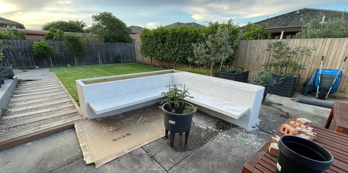

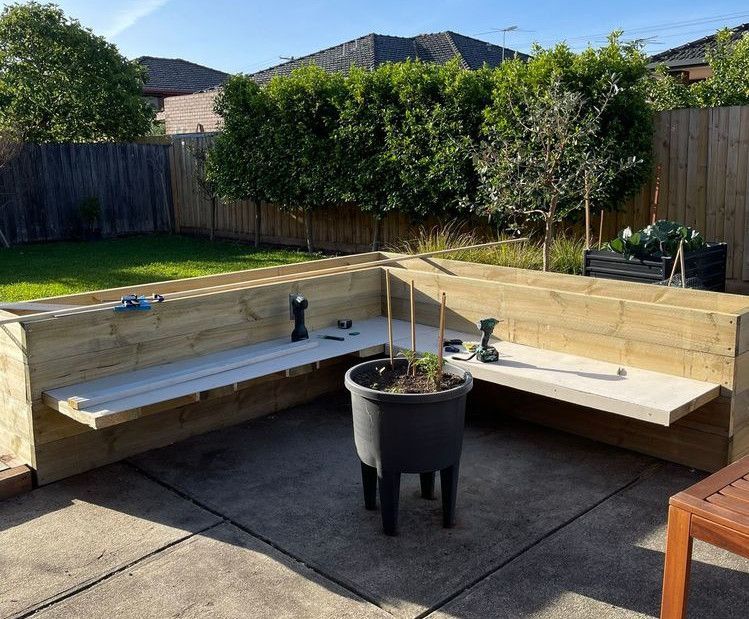

Step 5
It was now time to clad the seat in the fibre cement. I didn't feel comfortable cutting the sheets with my track saw due to all the dust, so I opted to score and snap the sheets. This was a lot easier than I was expecting it to be. It may have taken longer but I wasn't to set back by it.
Step 6

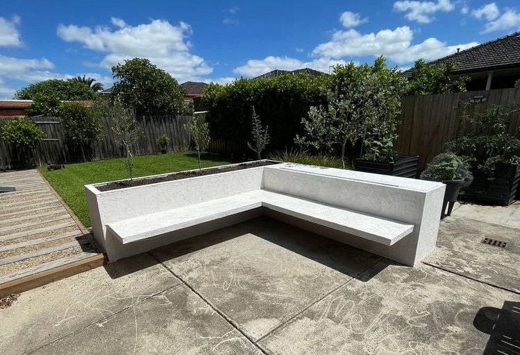

Once the frame was completely cladded, I added some angles to the external corners and some fibre cement jointing tape to any joins and internal corners (sorry, I didn't grab any pictures). Once this was done, it was time to add the render. I opted for the Dunlop pre-mixed render, mainly because I had never rendered before and I was planning on completing the render in the evenings and I didn't want to annoy any neighbours using my drill to mix the render up at that time. Another reason was it was already in the white we wanted, so there was no need to paint.
Step 7
Once the majority of the seat was rendered, I added the lid for the storage section and gave that a render also.
Step 8

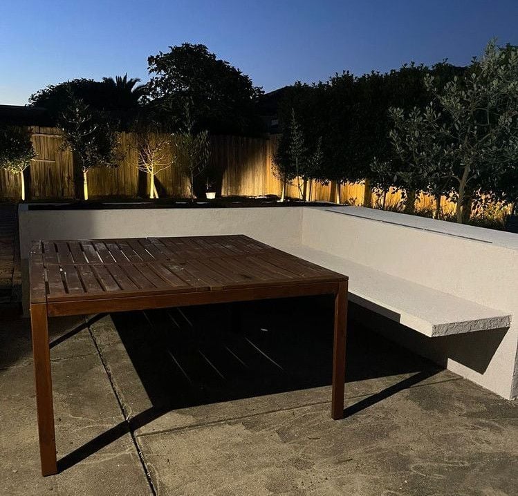

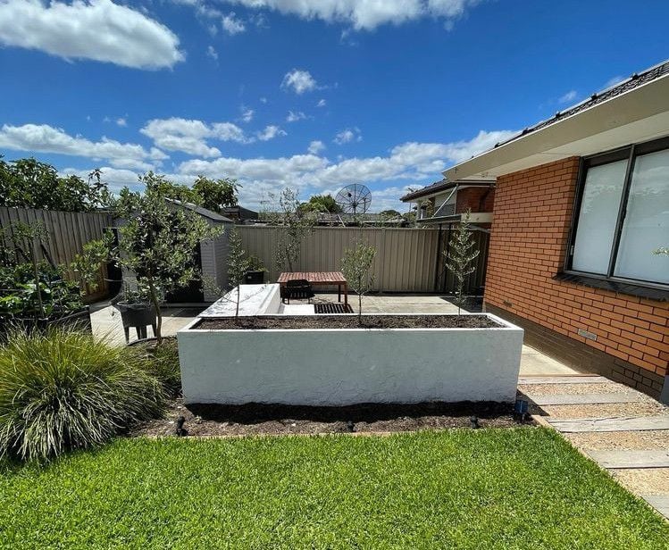

Finally, we had some soil delivered and filled up the planter section of the seat and planted three dwarf olive trees to finish off the Mediterranean look. I also decided to add some strip lighting under the seat to add to the ambience.
Step 9
And that was it. It's a little rough around the edges with the render but overall I couldn't be happier. It has elevated the area and created a great spot for lounging and entertaining.
Our future plans would be to add a pergola over the top and create a sort of cabana feel. I hope this inspires someone to do the same.
