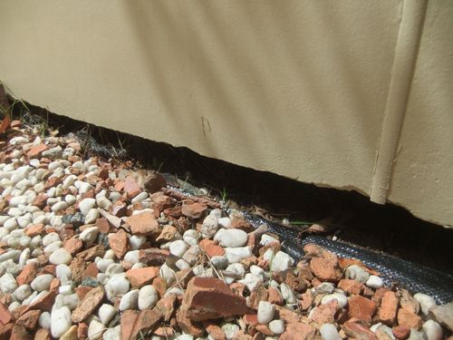

I'd like to use this mesh similar to:
https://www.bunnings.com.au/jack-190mm-x-10m-fire-guard-gutter-mesh_p3040312
to cover a 10cm gap along the base on a house. The walls are fibro.
What would be the best method to attach the mesh? Would a separate timber frame be best?

I like your suggestion of a timber frame actually. I hesitate to drill into fibro, mainly for the chance of cracking it and then the issue of what to do.
If you made a few long rectangular sections out of timber the same height of the wire and then stapled the wire/screwed or even nailed it t could look pretty nice.
Or maybe some metal pegs into the ground next to the fibro and then wedge the mesh down between both?
Hello @diyallday
Thanks for sharing your question about building a mesh screen for your house. I propose having a look at using 100 x 16mm 4.8m Edging H4 Treated Pine Wet. I suggest cutting it down into 25mm strips to create a frame where you can staple the Jack 190mm x 10m Fire Guard Gutter Mesh.
I recommend using the Jack 450mm Sleeper Peg Steel Flat Stake to hold the frame in place. This will save you from having to nail or glue into your fibro walls. I've placed a sample sketch below to give you an idea of how you can build the cover. Please note that the measurements are for reference only. Please adjust them to your needs.

It could work, but I'm now thinking about garden edging, perhaps:

with pegs. I'm hoping small gaps with the corrugated shape will allow sufficient airflow.
Hi @diyallday
The Tuscan Path 150mm x 6m Eucalypt Garden Edging is a good way to block off the gap. However, its solid construction will impede a great deal of airflow. The corrugated surface will allow air to pass over it but not through it.
Between the two, I believe the mesh screen will provide better ventilation underneath your house. However, if this is not issue for you then the garden edging should work nicely.

I do like the idea of multi using aproduct tho I think in this case you could end up with dam/humidity issues down the track. @EricL nailed it when he said it would impede the airflow greatly. It would look tidy I admit but in a year or a bit more the dampness could becomne an issue. I dont believe the corroragetd channels would allow too much air through.
How about RapidMesh 900 x 1200mm 25 x 25mm Silver Wire Mesh Panel and trim it down so it just sits over the edge of the wall down to the ground. It will let air through and is course enough to stop mulch from falling through when the mulch is up against it.

While browsing the aisle, I spotted this garden edging:
https://www.bunnings.com.au/matrix-400-x-900mm-charcoal-foliage-garden-edging_p3321779
It should be the ideal compromise and easy to install.
