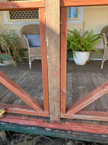

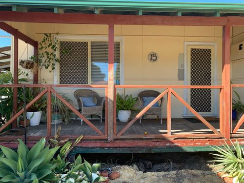

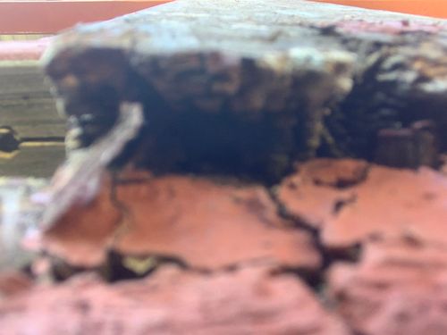

I am replacing half my veranda floor due to wood rot and thought while I’m at it I’ll replace my 4 x veranda posts .
The Verandah measurements is
6m x 2.2m.

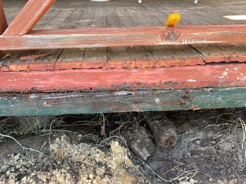

The previous owner had used colour bond sheeting around the base of the house which over time caused the wood rot due to limited ventilation.

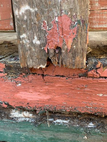

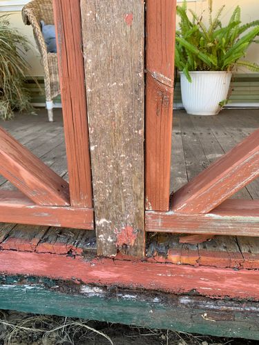

The posts are the same age as me lol 66yr old 95 x 95 old jarrah post but are showing wood rot on about 3cm on the bottom of them.
Do I use H3 or H4 Treated Pine
100 x 100mm Post H4 Treated Pine Radiata CCA
OR
90 x 90mm Post H4 F7 Treated Pine DAR CCA
OR
88 x 88mm Post H3 Treated Pine Laminated LOSP FJ
The timber (green and brown face board?) will be replaced as it’s not repairable. Also 1 stump has rotted in half so will be replaced also.
