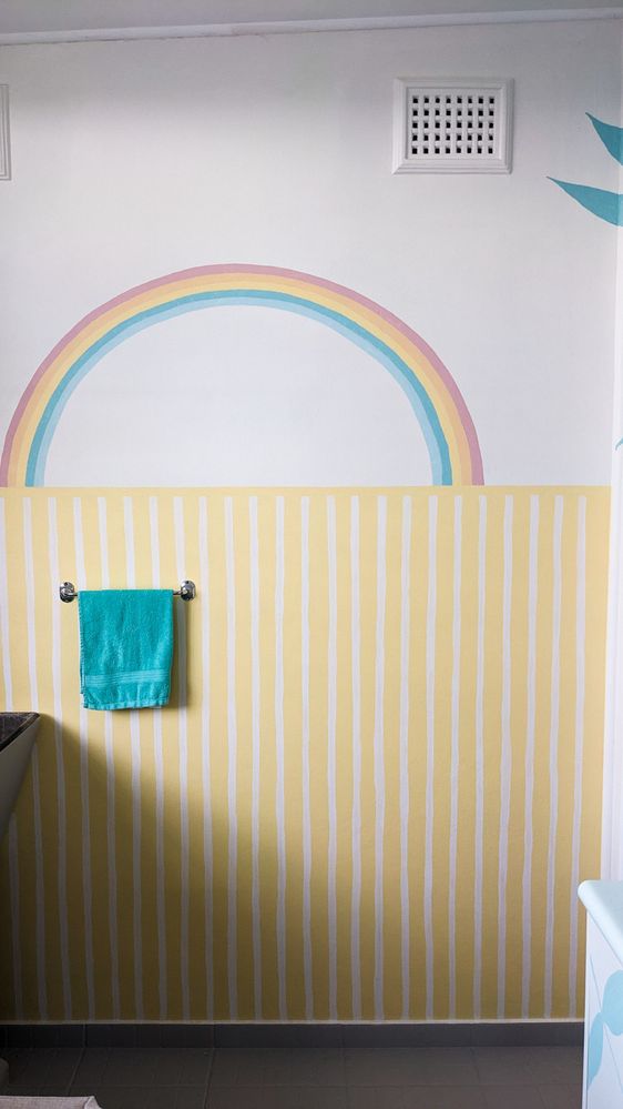

I used a pencil to roughly sketch my design and got to work first on the large blobs - two coats. The next day I painted the leaves and flowers, followed by the yellow dots.
To draw the rainbow, I used a pencil on a piece of string to mark one arch, and then freehand painted the rainbow to the approximate width of 2 x the width my paint brush bristles. I wanted the hand-painted look for the yellow stripes, so I marked up the lines in pencil using my spirit level but didn't tape them. They are imperfect by design and I love it.

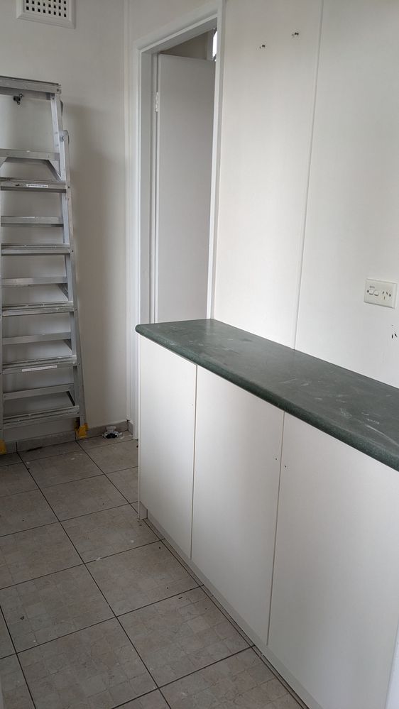

The cupboards and benchtop were a very easy clean up and painting job. I used Selleys sugar soap for the clean and sanded by hand to rough up the surface for priming. As we had a lot of Dulux 1step prep already, I used this as my primer.
For the cupboard paint, I went with Weathershield again in Antarctica Lake Quarter. I could have used the Dulux Renovation Range cabinet paint as we have used in our kitchen before with great results. However, I had the Weathershield already and had already used it to paint the exterior door and liked the colour continuity. For the benchtop I used Dulux Renovation Range tiles and benchtops in Sea Foam.
I cut in with a small paint brush, and then used a small microfibre roller to lay on and lay off the paint. This gives a smooth even finish. I always do two coats.

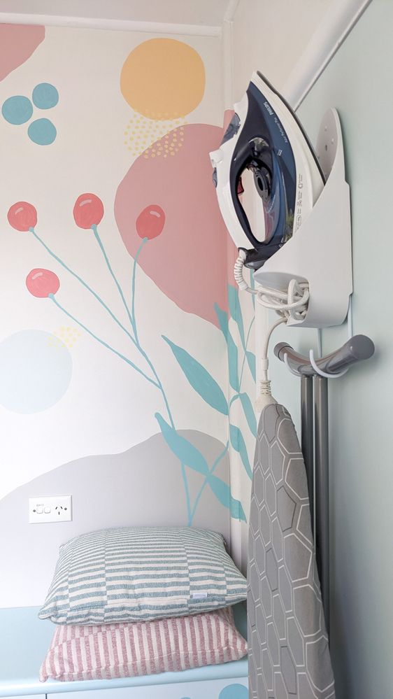

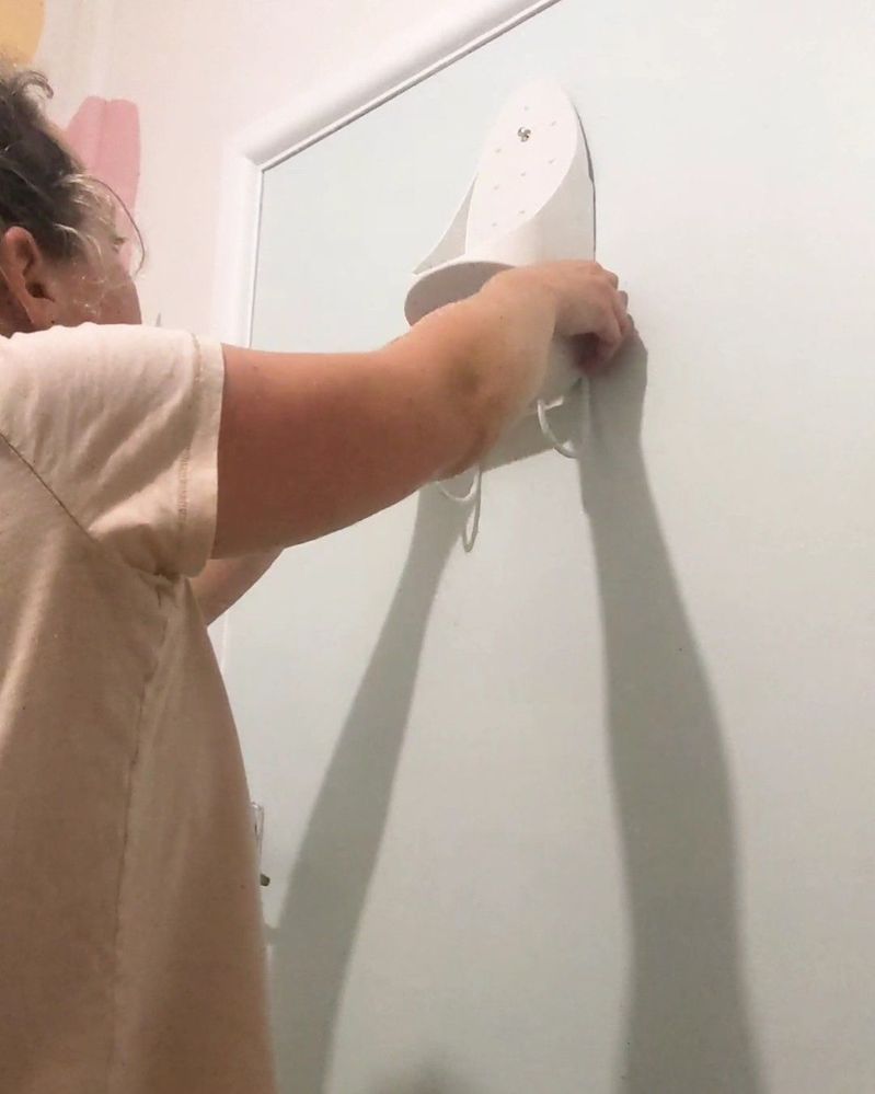

The cabinets already in the laundry were decent, but there wasn't anything for long or awkward shaped items. I picked up an excellent iron and ironing board holder which I then mounted to the back of the exterior door. Similarly, I mounted the broom and mop to the other door. This keeps the items neat and off the floor, easily accessible and didn't require additional cabinetry or drilling into the asbestos.
I pre-drilled the holes and inserted wall plugs, and then simply attached the fixtures with screws. Sometimes the simplest solution is the best.
