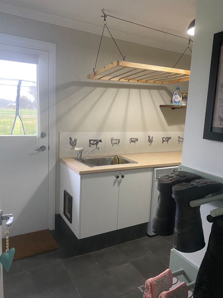

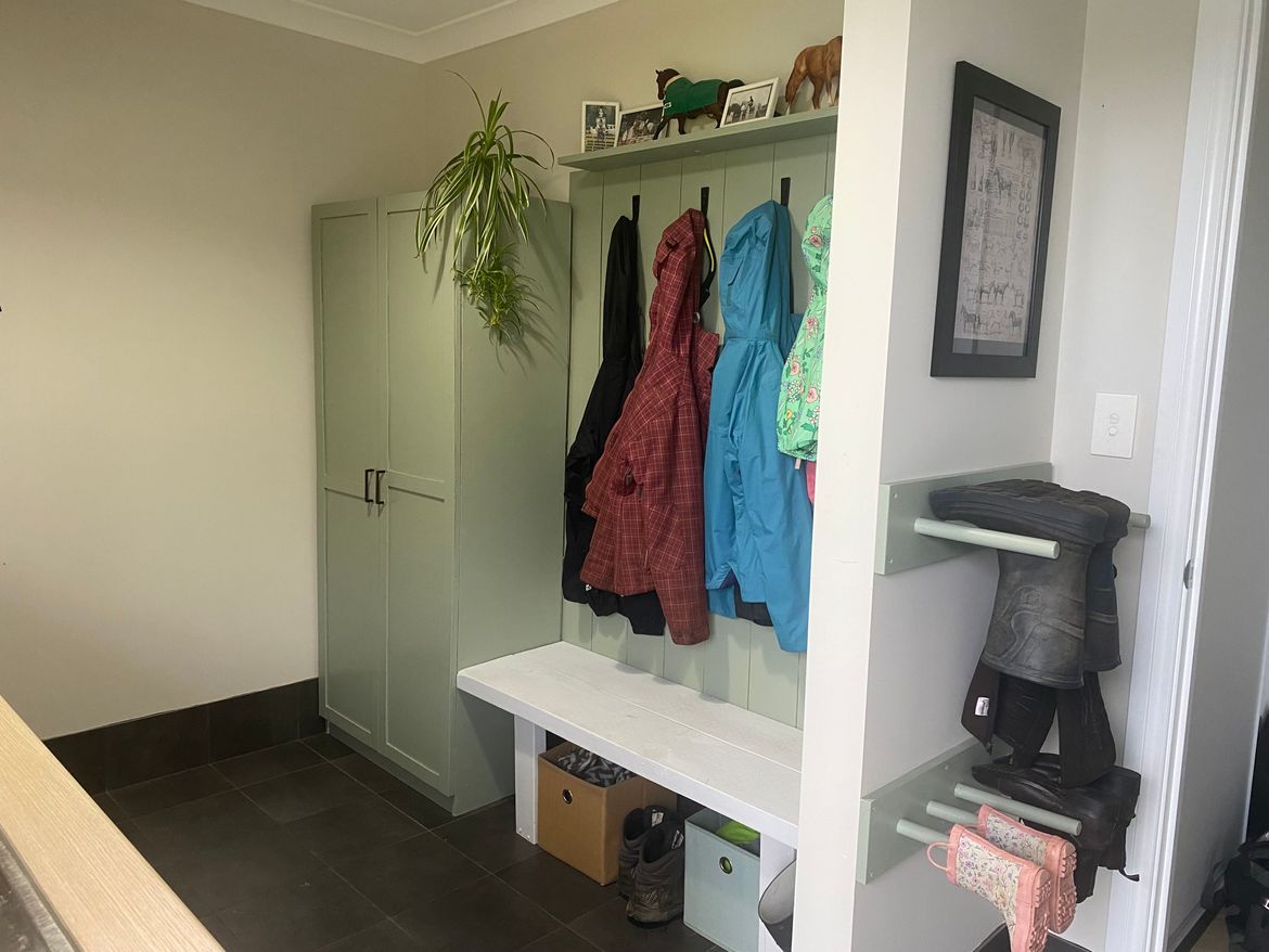

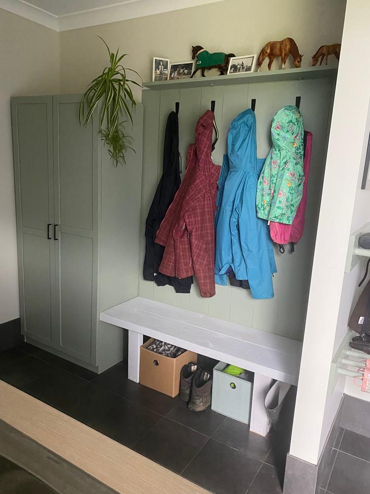

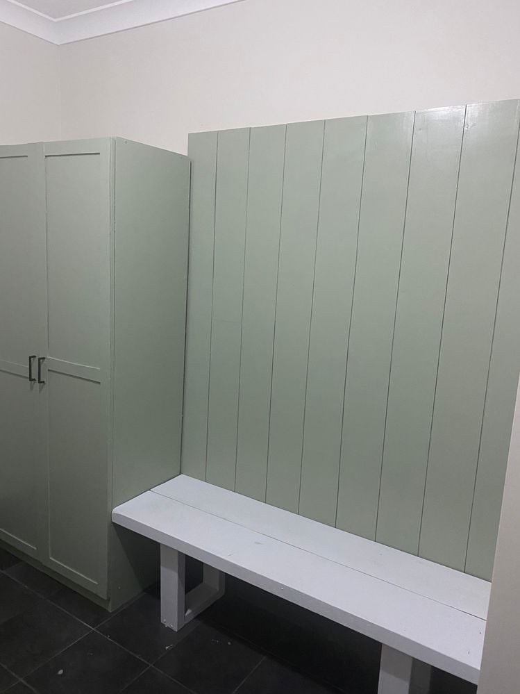

When we built our house six years ago, we made the laundry room bigger than usual, as I had grand ideas of making a mudroom to dump wet jackets and boots, since we live on five acres. I only just tackled the project this year and I’m very pleased with how it turned out.

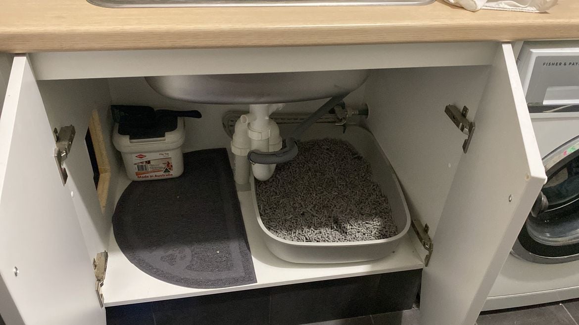

I added a renovated cupboard for the vacuum and other utilities, a bench, a boot rack, coat hooks on a shiplap wall, retrofitted a cabinet to be a hidden cat litter box, and painted boring tiles to add to the farmhouse look.

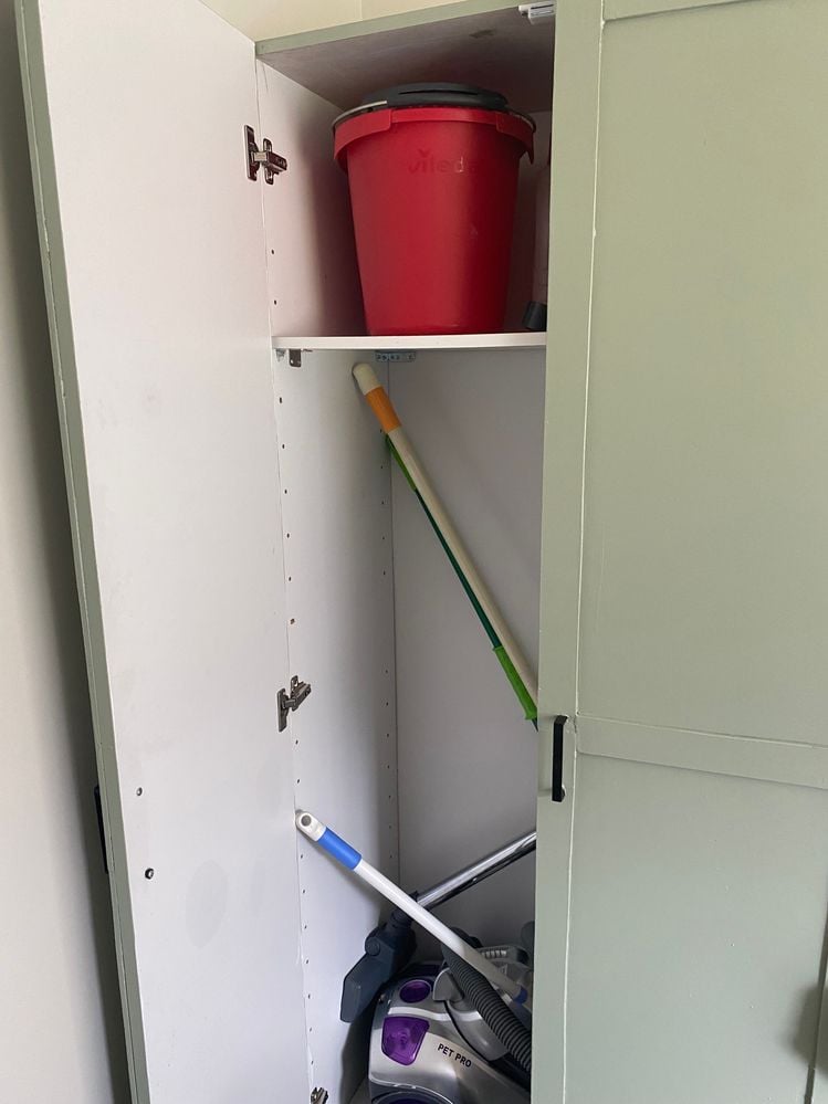

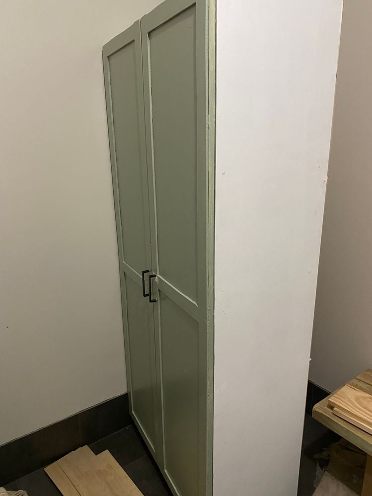

Cut thin ply into strips for border around cupboard. Glue on with liquid nails and clamp overnight. Prime and paint. Attach your style of handle on the doors. Attach with brackets to wall.

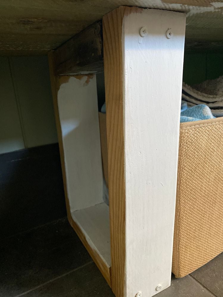

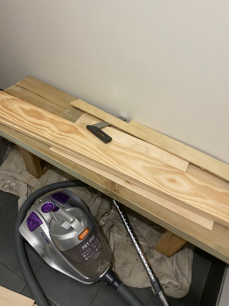

To make the bench, use the handsaw or other tool you might have to cut sleepers to size. Use spare wood, at least 40mm thick, to build squares for the legs. Attach with screws then screw onto sleepers. Then paint.
Bracket to wall after wall is completed.

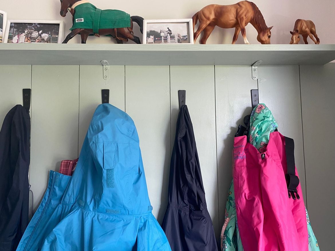

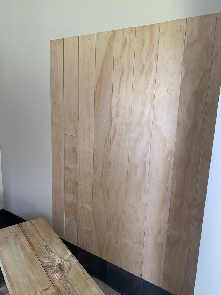

For faux shiplap wall, cut ply using straight edge into 15cm strips. Sand the boards.
Attach to the wall using liquid nails and bullet nails (depending on if you are brick or timber framed walls). Allow a spacing of a 20 cent coin to keep consistent.
Prime, paint and then attach the coat hooks. Then attach the shelf using brackets.

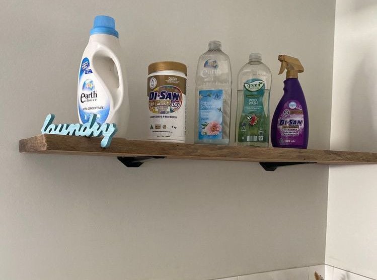

For live edge shelf, find where your studs are and attach the shelf bracket. Then sand and wax your live edge wood piece, then attach to the bracket on the wall.

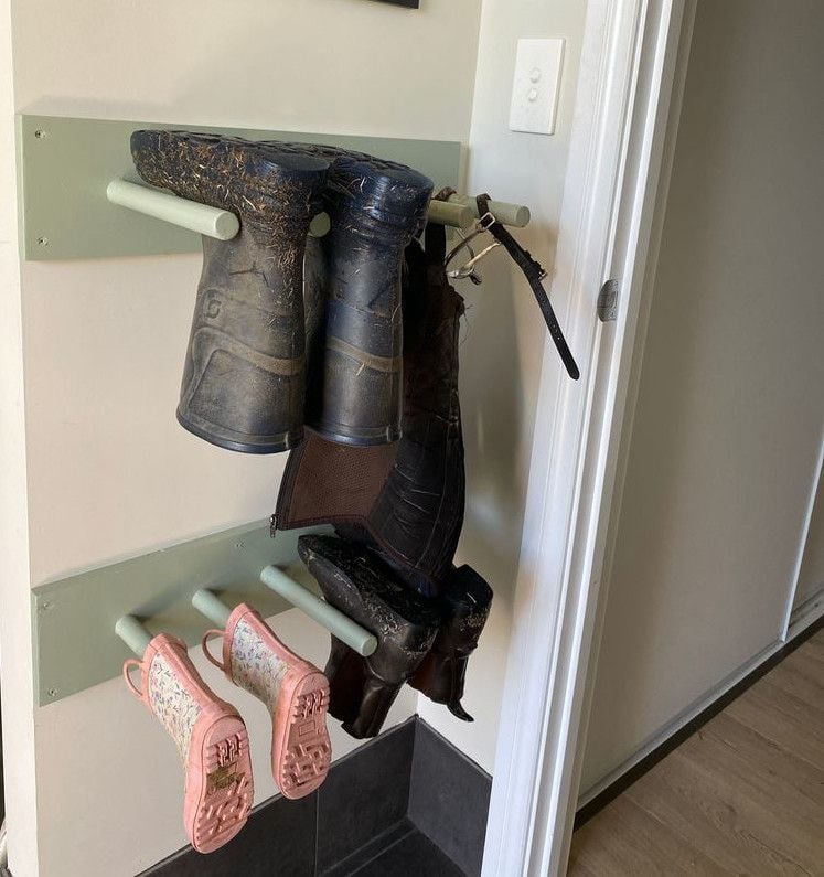

For the boot holder, cut 22mm dowel into 22.5cm lengths. Cut 1.2m Pine board into 60cm lengths.
Sand both. Use the spade bit to make even holes in the board, going almost all the way through. Attach dowel using wood glue and a small screw through the back.
Prime and paint and then attach using wood screws.

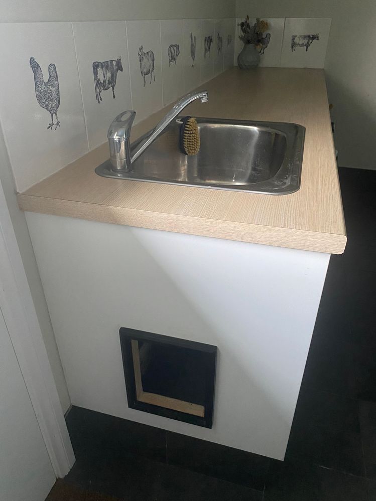

For the hidden cat cupboard, use an old picture frame for the frame. Use a jigsaw to cut the frame out in the cupboard. Sand the hole. Attach the picture frame using liquid nails.
Step 7

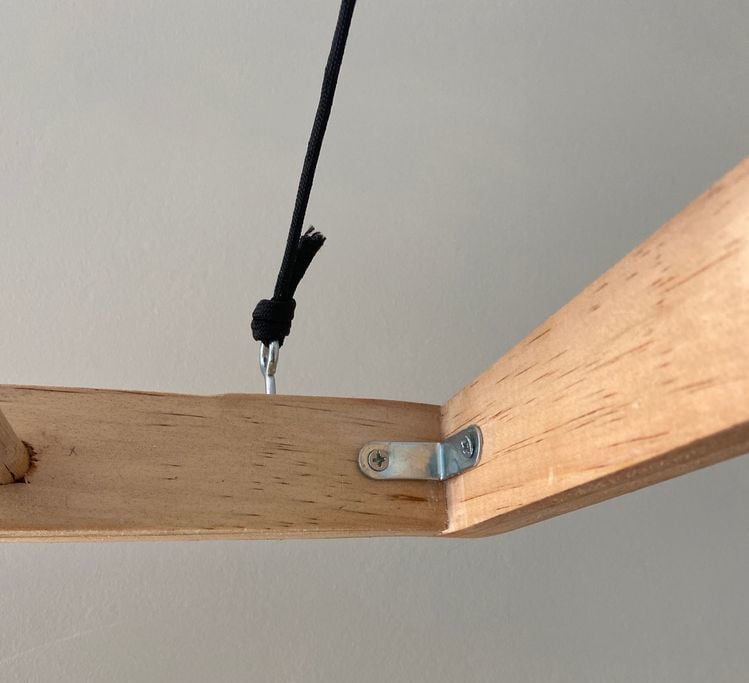

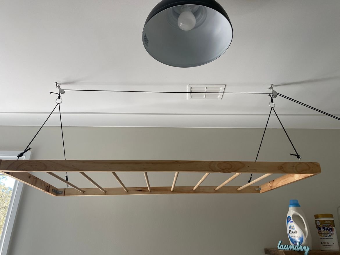

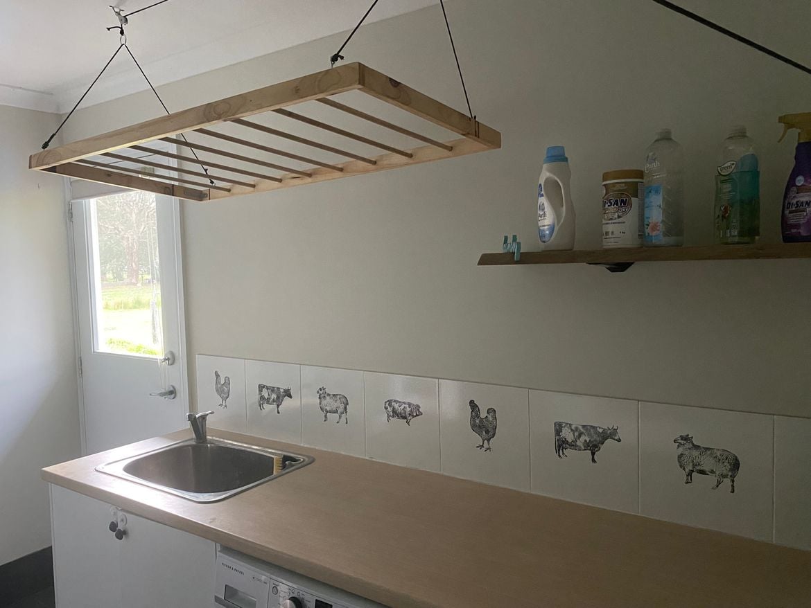

For the hanging laundry rack, I followed a Bunnings tutorial for ideas then I altered it to work for my laundry room.
Step 8

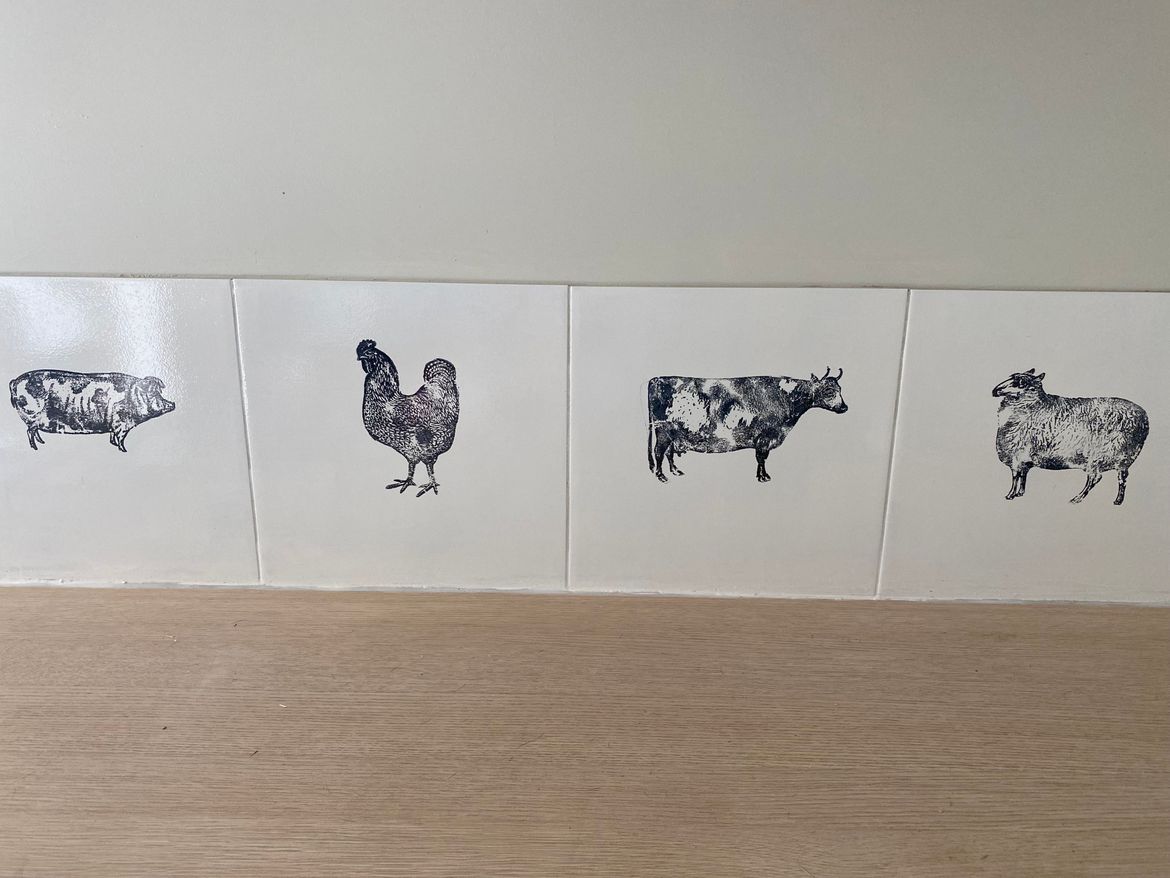

For the tiles, I sprayed ESP easy prep on the tiles then used white tile paint. I also used the IOD stamps with permanent stamp ink to create the animal designs.

Completed project.
