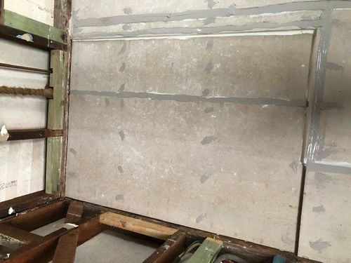

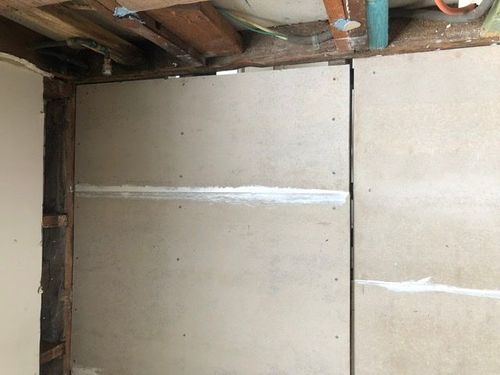

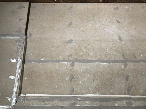

Hi there, I just got new floor laid in the bathroom (James Hardie Secura on timber frame) and just wondering if I can get some advise whether these gaps are acceptable and ready for waterproofing. Here is the gap between the shower recess and rest of the floor (~10mm)

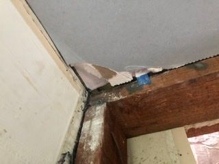

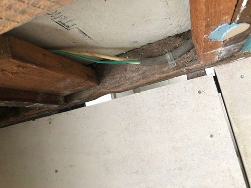

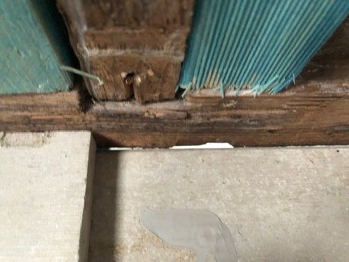

And here between the floor and bottom plate (19mm widest point):
I’m planning to sheet with villaboard so that’s 6mm less gap but still…
The tiler/waterproofer says the gaps are too big and the carpenter/builder says this is build to code and that the tiler is not worth his salt if he can’t deal with it. I’m not sure who is right but it does seem like there is no reason for gaps like that… any advise is much appreciated!
