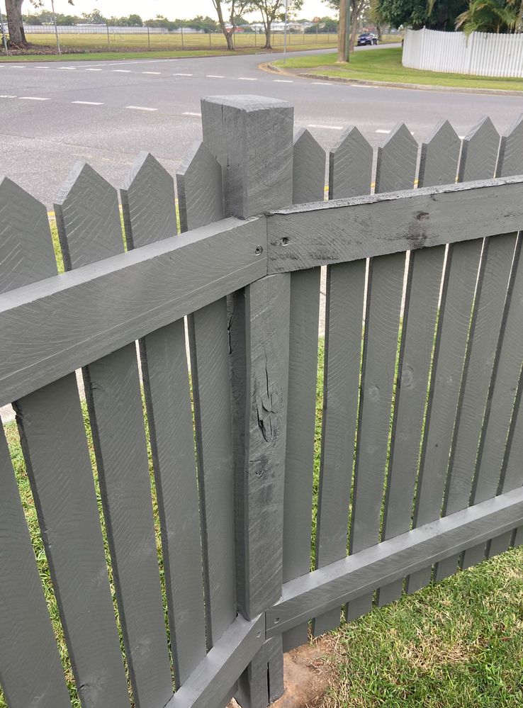

I want to update a fence by removing some aluminium panels and replacing them with rails and pickets. The existing posts are in good condition, so I'm planning on reusing those - however there's one challenge I'm struggling to wrap my head around.

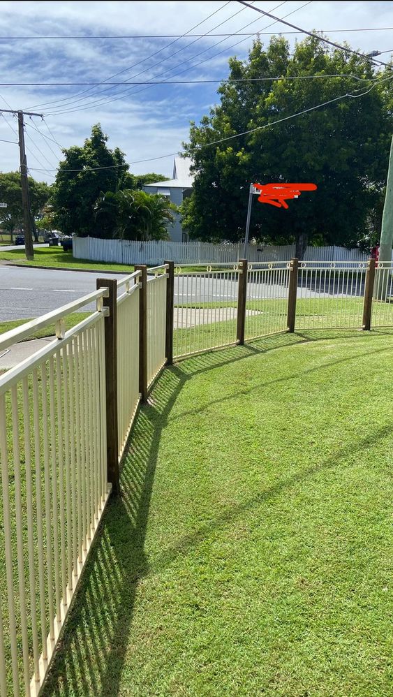

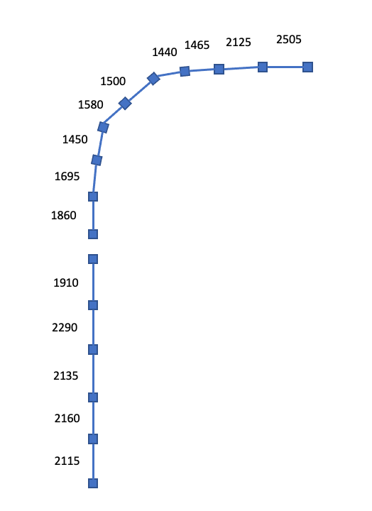

I live on a corner block and the fencing wraps around a corner in a bevelled/gradual way (pics below for reference). I've watched a range of online tutorials videos and understand that I should notch the posts for the rails to sit in. However, I'm struggling to work out the best way to do this for the sections that curve around the corner. I have found one video that did something similar - however, they opted to cut the rails to match the distance/angles of the inside of the posts and then simply screwed them into the side. I imagine this is not as strong or durable?
Any thoughts on best way to approach?
