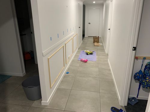

So this platform has been very helpful to me in reading about the wall moulding and seeing projects. I am on my way to start the home improvement journey and stage 1 is the panel mould trim in the hallway walls which at the moment look dull.
I just need clarification / assistance with the below queries:
- I will be using liquid nails as adhesive for the mould. Is it better to just use the nails ( I have a Ryobi brad nailer) at the studs instead of the liquid nails. I have heard removing liquid nail adhesion will ruin the wall. Also i only intend to nail at the studs and not drywall.
- The over spill and the squeeze of the liquid nails. is it easy to remove?
- Where do I nail the mould panel at? is there a specific location i need to be aiming at and what angle is the best? perfectly horizontal will be fine?
- The panel mould i have got is not primes. I want to install on the wall and then paint afterwards. will this be problem? the top rail is primed. the profile of the mould is this : Porta 30x12mm 2.4m Panel Mould Clear Pine - Bunnings Australia
- Do i need to clean the walls or do any pre work on the wall before hand? Thats because the paint is fresh on the wall when i bought the house a couple of years ago so i want to painting the walls again but will paint the panel moulds.
