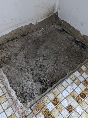

Hi there,
I've recently removed an old metal laundry (with difficulty) and wanted to know the best way to fix the floor. Can I use a self level cement?

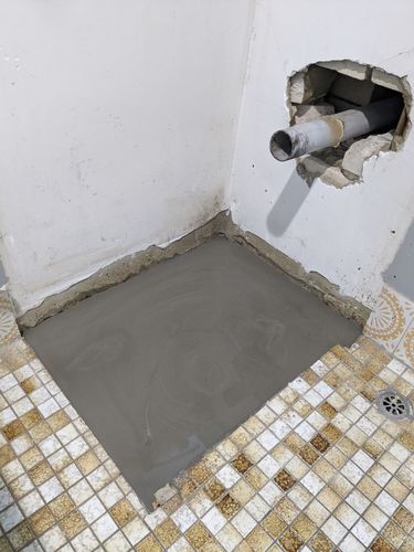

Worked brilliantly. I purchased the 1L primer instead which was plenty. Did 2 layers but probably could have added an aggregate as mentioned on the concrete package as it was a small area but relatively deep. Still happy with the outcome. Thanks a lot.
