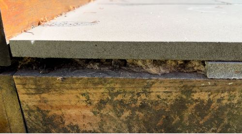

I would appreciate any advice on filling a newly formed gap that’s formed underneath our outdoor pavers. Pieces of concrete (and other stuff?) have just come off and look like they might keep falling off.
Welcome to the Bunnings Workshop community @jackle. It's great to have you join us, and many thanks for your question about filling under pavers.It appears that cement-based grout has been used to fill this gap. However, due to the expansion of the pavers and timber, the grouting has failed. You might like to remove the remaining grout and replace it with a flexible polyurethane filler such as Sikaflex 11FC. This flexible filler would be much suited at dealing with the stress and movement of pavers over timber.Please let me know if you have any questions.Mitchell
Thanks @MitchellMc!
The remaining grout to the right is still quite set. Should I still try to remove it and break it apart with something like a chisel and mallet? Also, the timber below is a long board that is no more than 2 inches thick. Beyond that, the pavers are sitting on the cement-based grout. Is Sikaflex still the right product for this?
The grout to the right has already delaminated from the tile, as seen by the gap @jackle. So, I'd be inclined to try to remove it with a chisel before it just falls out. Remember your PPE, including safety glasses, a face mask and gloves.
Sikaflex would still be suitable as it likely has the best properties of the available options.
