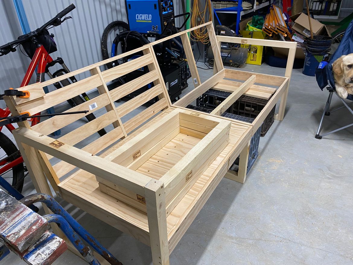

Step 1
Start by cutting all of your leg pieces so that they are identical in length. Secure all leg pieces using 75mm 10G timber screws and external wood glue. Repeat the same process for the bench seat and back supports for each piece of the modular setting.
Step 2
This project came together perfectly with everything cut to size and labelled prior to the build. Make sure to use some clamps to assist in ensuring you are able to secure each joint so that it remains aligned.

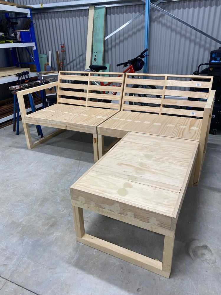

Step 3
After constructing the frame, patch any screw holes and fix imperfections in the wood (only if you are wanting a perfect finish).

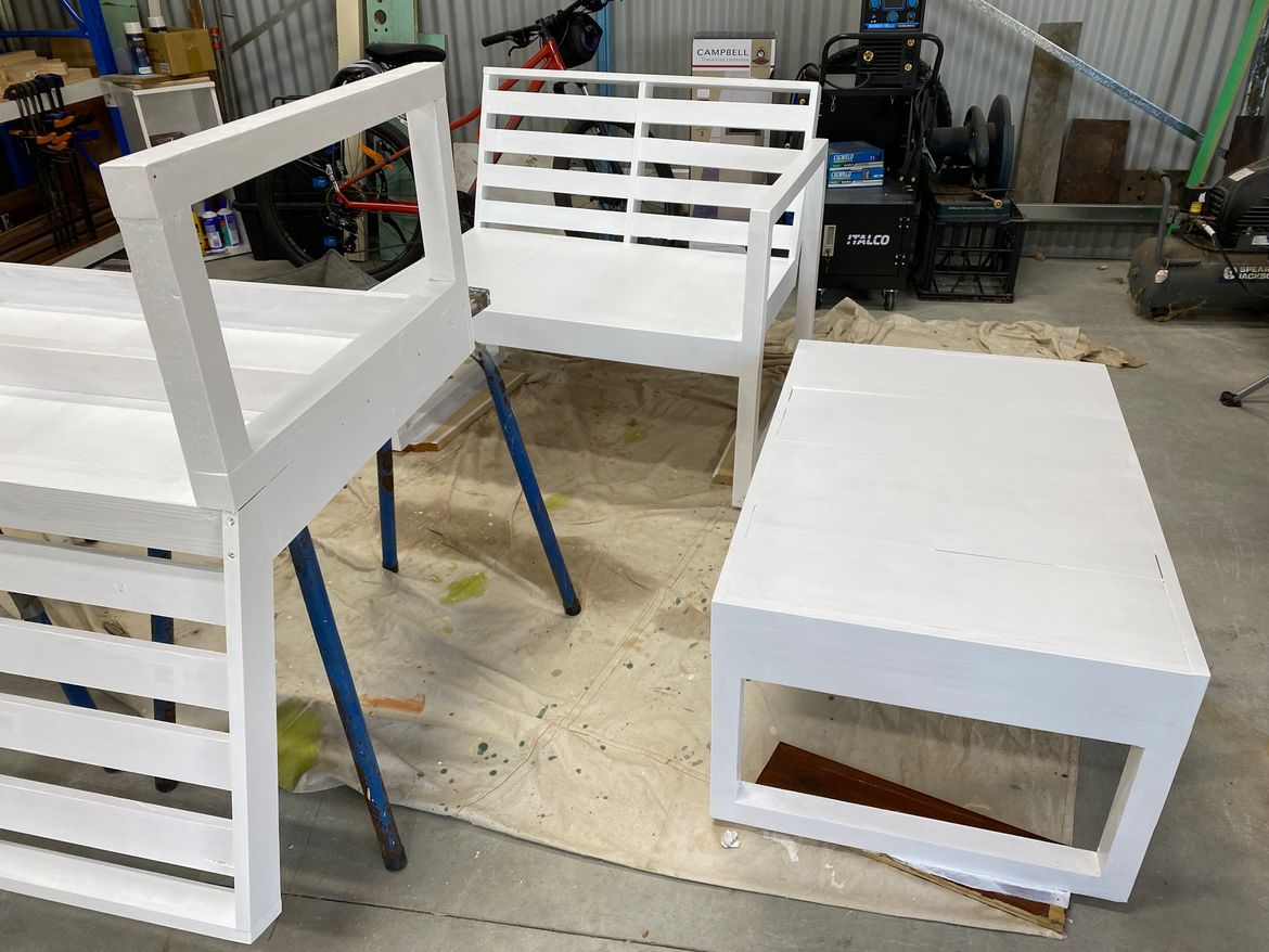

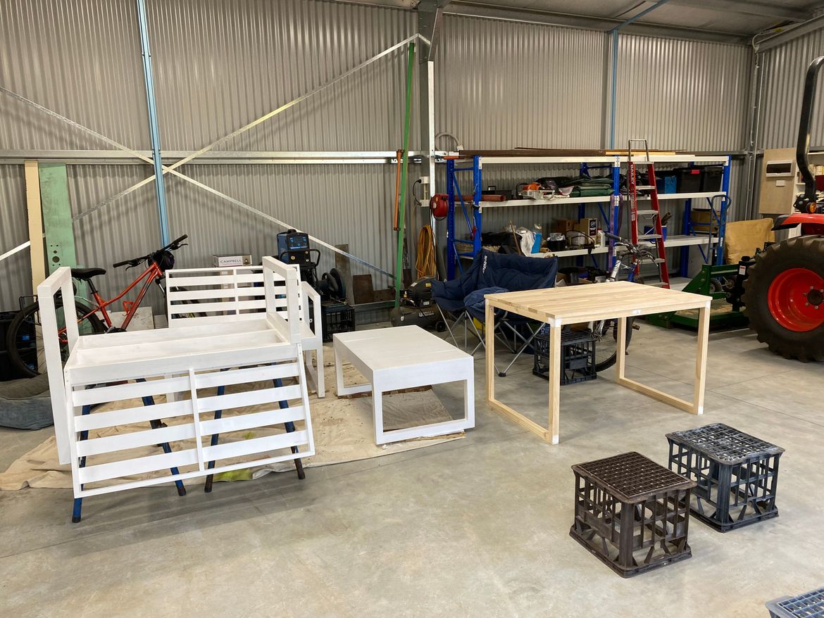

Step 4
Sand all pieces thoroughly, using a fine sanding paper to achieve a smooth finish. You can then begin painting. I used a British Paints outdoor paint which came up perfectly. Tape around the table top if you are after a wood finish, so that you can keep the paint lines neat.
Step 5
Put the final coat of paint on. As this is an outdoor furniture piece, I worked hard to ensure all cracks and joints were sealed to reduce water damage.

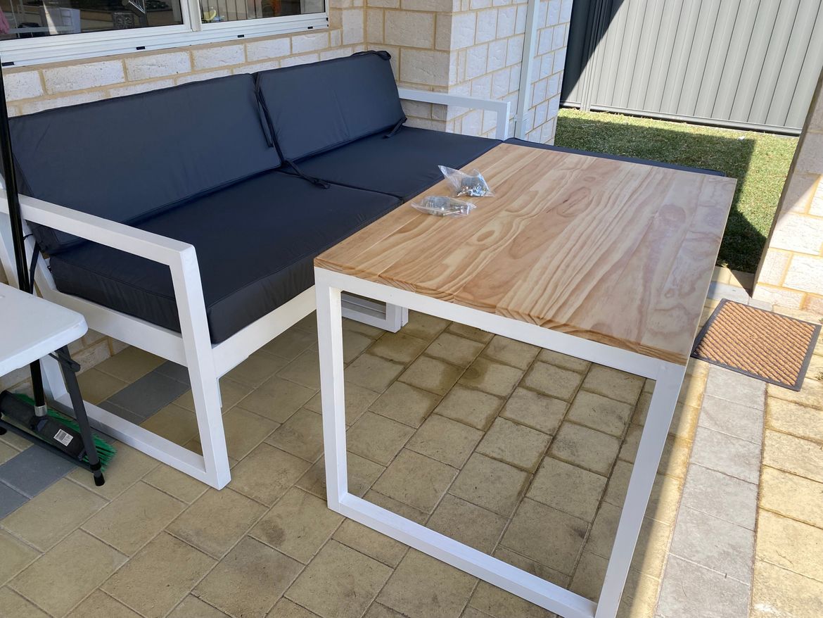

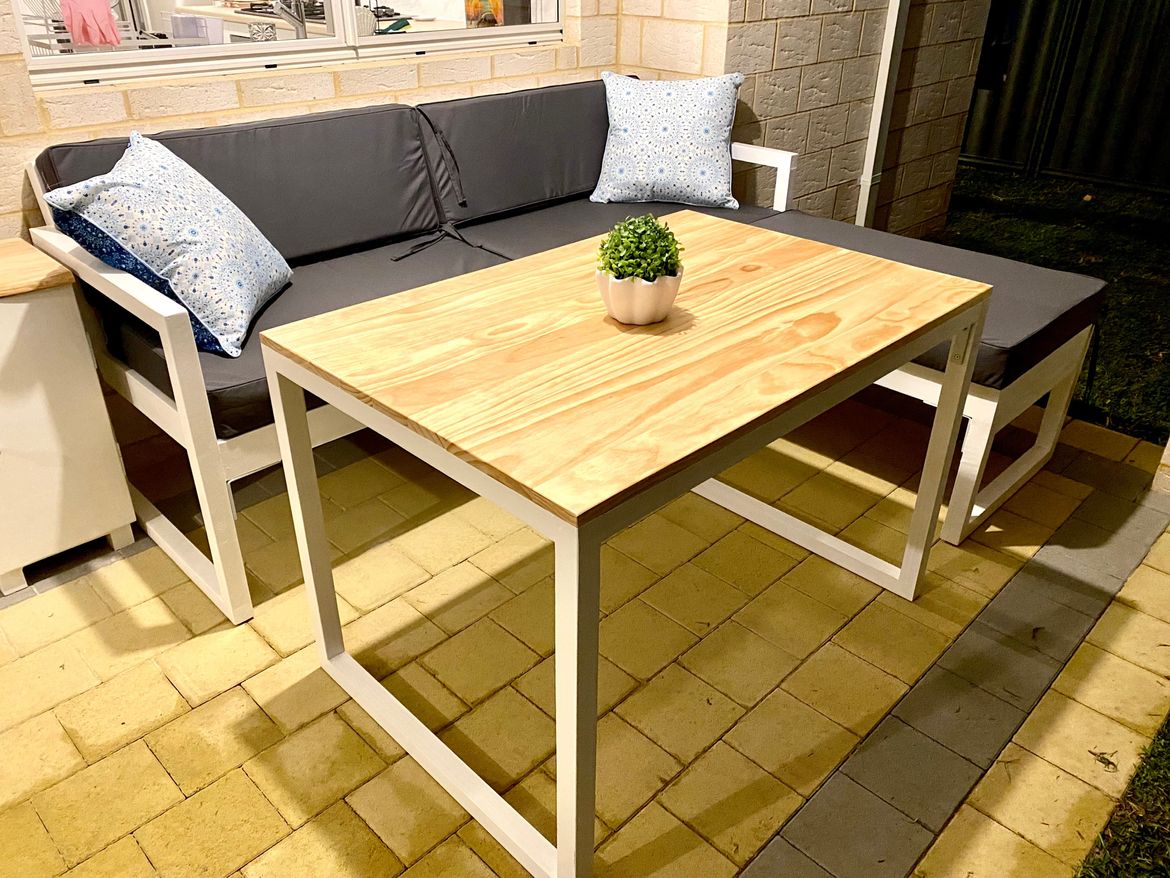

Step 7
Add your cushions. For this, I bought the pieces of foam and custom ordered some covers online.
Step 8
Dress and decorate. She’s now summer ready.
