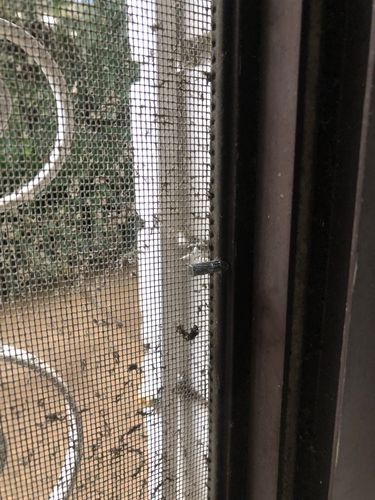

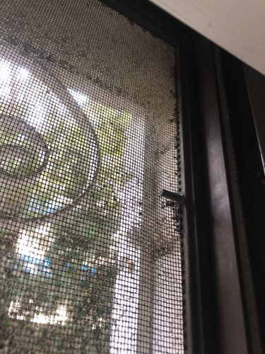

Happy Easter. Trying to undo fly screens and it looks like it’s secured with spring loaded pins. Can’t undo with pliers - have tried twisting and pulling and WD40. Maybe it’s just ancient and stuck for good? Advice appreciated.
Hi @fraser,
You could attach a pair of locking pliers tightly onto the pin. They would give significantly more grip on them. You might even be able to tap the side of the pliers with a hammer to encourage the pin out of its home.
Is there any gap between the fly screen frame and the window frame? If so, you might be able to slide a mini hacksaw blade in the gap and cut the pins. A fine flathead screwdriver could be used to lever the screen away from the window frame to provide that needed space. Be very careful not to damage the window frame whilst cutting.
Let me mention a few of out talented members, @TedBear1, @Dave-1, @Nailbag and @Jewelleryrescue, to get their thoughts.
Morning @fraser
I must admit I have not seen a flyscereen with locking pins before. Trying to pull the pins out with a pair of lockable pliers (vicegrips) may work. While I was thinking about it I stary thought came across my mind, Have you tried lifting the screen upwards? Either pushing the top of the screen up or levering it from the bottom (Be careful as it does bend easily) I am thinkingthat the weight of the screen is clamping the pins tightly so if the weight is lifted off the pins they may come out easier?
Hi @fraser
It's great that you've received excellent advice from our members. Just to add to the suggestions made, I recommend tyring to twist the pins first to loosen them up. Using the lockable pliers would be ideal for this. The likelihood of the frame sitting on the pins is is a definite possibility.
Please keep us updated with your progress, we look forward to seeing your flyscreen uninstalled.
