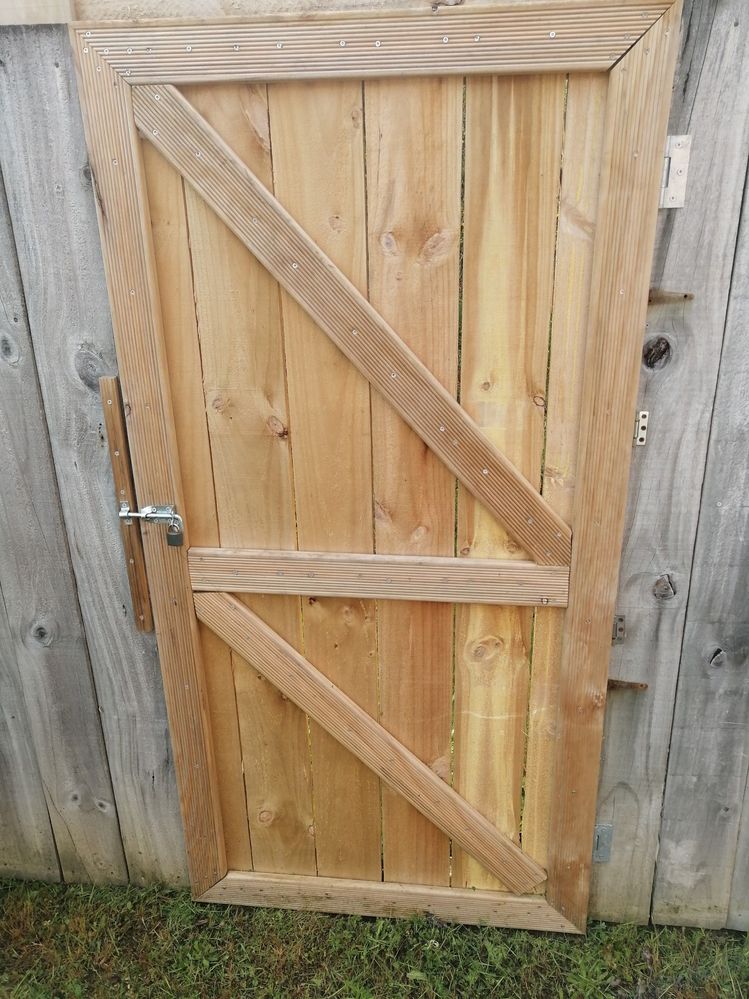

I made this 1.8m high x 900mm wide garden gate to match my 1.8 m high fence. It gives me access to a reserve at the back of my property. It was very cost effective. I was quoted $550 - $650 for someone to make a similar gate. I bought all my materials from Bunnings Botany (always great staff in the the timber yard) for a total cost of approximately $80.

Step 5
Garden gate hung on fenceline.

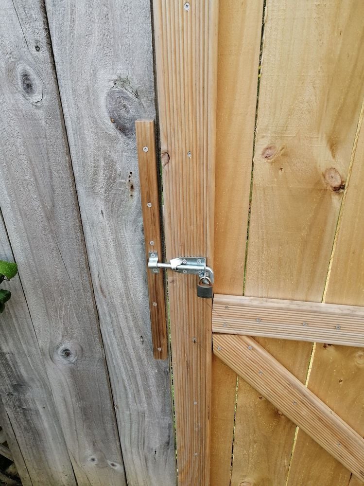

The lock mechanism attached to the gate.
