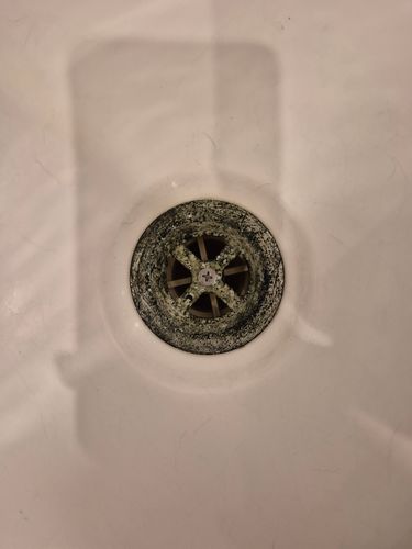

The drain grate in my bathtub is very rusty. I would like to replace it if possible.
I've unscrewed and removed the grate, this is what it looks like underneath:
This looks like there is a second plastic grate (or is it?). What can I do next?
Hi @weirdwhiskers,
First of all, welcome to the Bunnings Workshop community and thank you for your question.
Let me start by saying, "Yes!", the drain grate can be replaced. However, you must note that the plastic piece of the waste that you see after removing the metal grate, is connected to the waste pipe through a screw mechanism from underneath the bathtub. To replace this, it would require gaining access to the underside of the bathtub, which can be quite an invasive endeavour.
With this project, I think there are two main options to restore the look of the drainage grate without being too invasive.
Please always remember to wear your PPE and to use caution as even small tasks can lead to injuries.
Let us know how you go,
