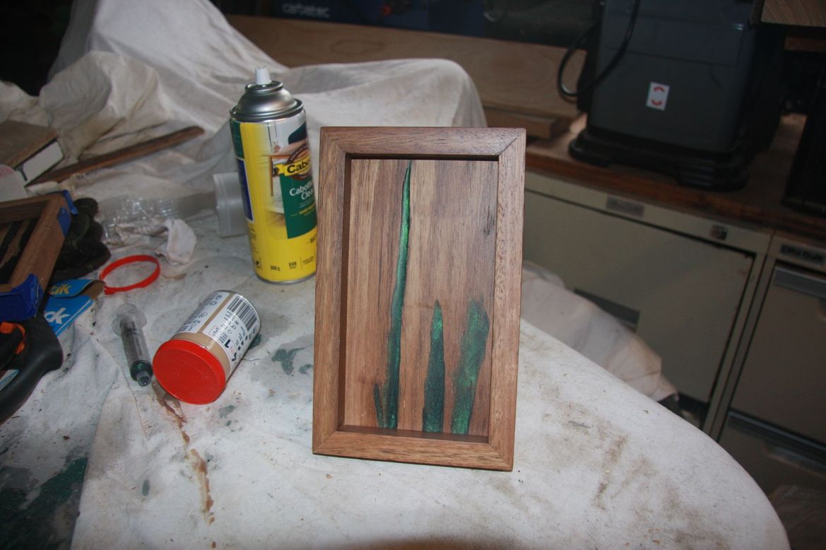

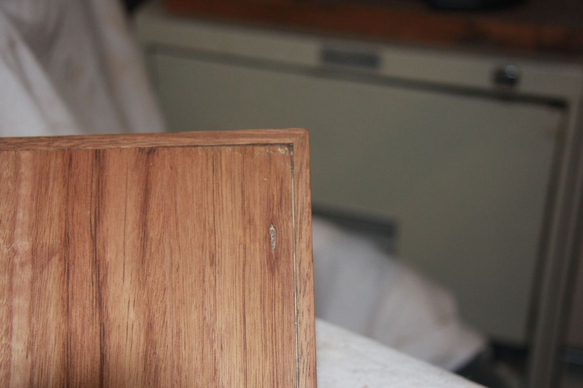

I made these trays from some old wood which had grub damage. Should I treat the wood for borer before finishing?
It does sound like old damage, @Paul_H. Personally, I wouldn't worry about it; if you've sealed the holes with resin, that should take care of it.

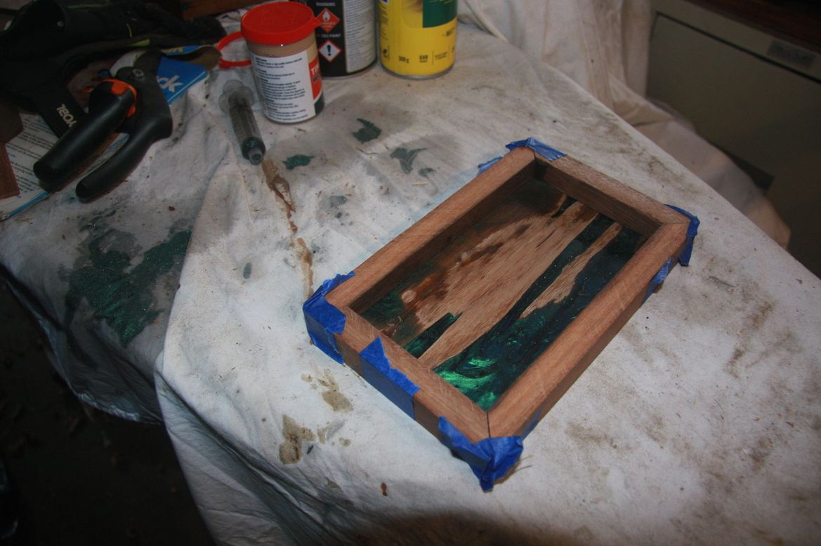

I think that the damage was sometime ago. The timber was in the men’s shed that I go to and it has been sitting around for a number of weeks in my shed. I filled the holes with resin.
Welcome to the Bunnings Workshop community @Paul_H. It's a pleasure to have you join us, and many thanks for your question about wood borer damage.Do you have any idea how long ago this damage occurred? If you stick a pin or a thin bit of wire down the holes and there are no alive larvae in them, I wouldn't bother treating the timber. It's like damage from some time ago, and the borers have long since moved out or died.
If the borer is active, you can treat it with Hovex 1L Ultra Lo-Odour Termite Concentrate. Please remember your PPE, including gloves and a respirator, while applying the product.Please let me know if you have any questions.Mitchell
