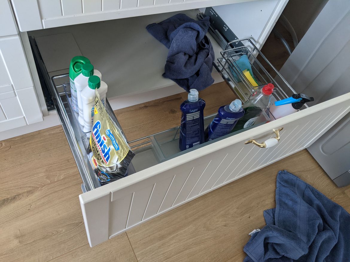

Can I get some information on how to remove this drawer? It is not the standard drawer runner as my other Kaboodle kitchen drawers.

They appear to be the same drawer runners shown in the below video, which would mean the drawer runners do not separate in the same way a standard drawer runner would.
Installing a pullout basket and attaching a pot drawer panel | kaboodle kitchen
As you can see at 1:10, the baskets are attached to a tab on the drawer runners using small bolts. Once you've located the bolts and undone them, you'll be able to remove the basket.

Thankyou JacobZ,
I managed to get to the dishwasher plumbing without removing the drawer, although awkward! But I'll keep this in mind for next time. BTW, do you know if I can get a pull out pantry for my 2200x600 pantry cabinet?
