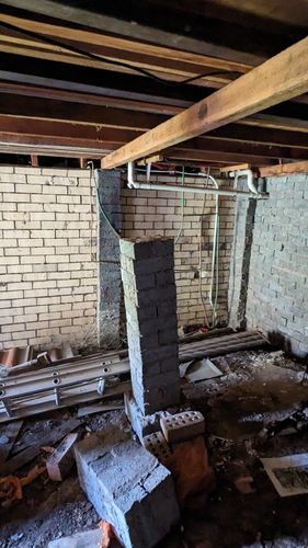

They have a brick house, well above the soil, sloped land (not a steep slope). Big space under the floor, supported on brick piers.
I think there's been some movement, and I've suggested an engineer, but thats costly, in the meantime, ONE of the piers has deteriorated, the remaining brickwork isn't firm (it rocks when I move it- so I think the soil has washed away. `I checked the other piers, and they seem to be plumb (straight) via a spirit level, but I'm worried about this pier. Image below.
I think in the short time, something like this Uni-Pier might help, or at least be remedial. I think we might have to get a better cement layer. My own opinion is to get a structural inspection done, but I want to get them reassured first. I doubt home insurance covers this, because it's something people should inspected regularly.
Any advice from Workshoppers welcome.
Here's the photos:

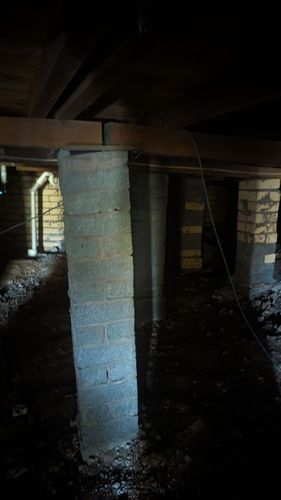

This neighbouring pier is plumb:
