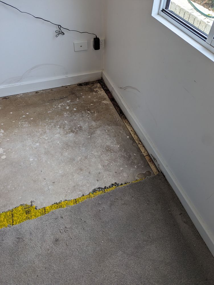

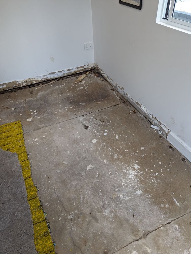

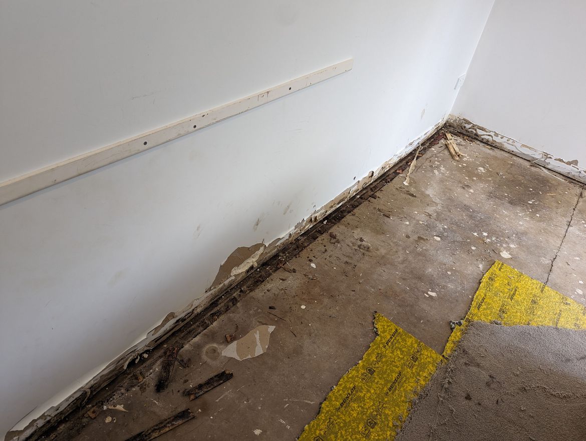

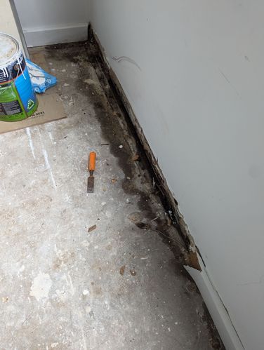

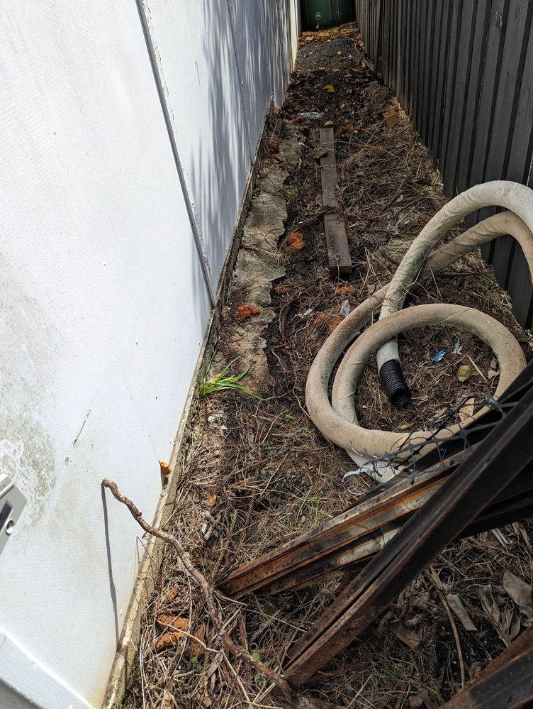

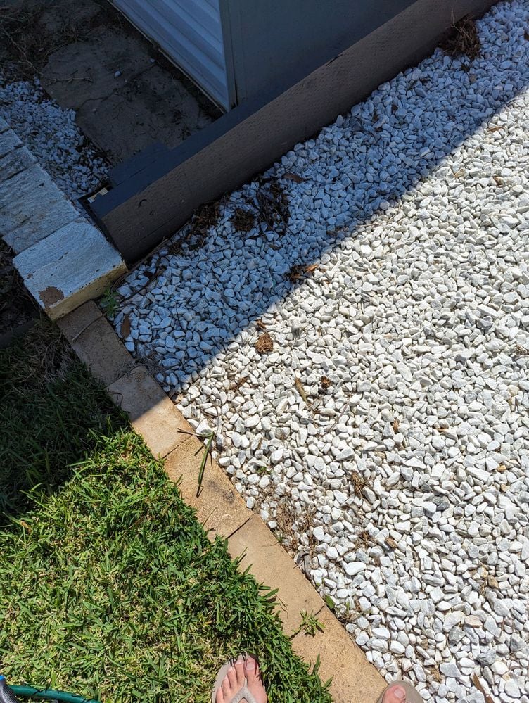

This part of the garage is used as a study and unfortunately it appears water has been getting in via the rear and right side of the garage for quite some time (without us knowing it). The excess rain over last week got in so bad that our carpet and some of our stuff got completely ruined.

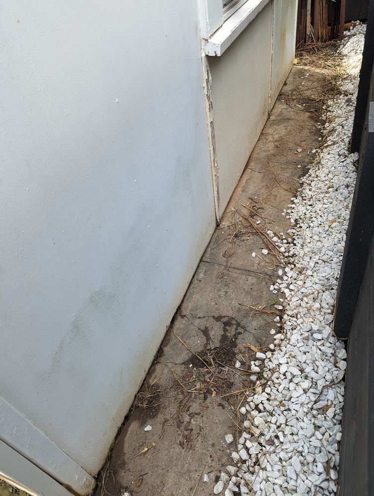

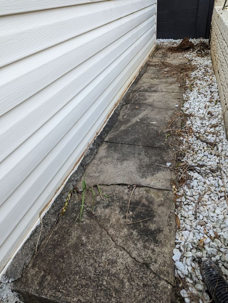

What I will point out is Agi line was installed on both sides and rear a couple of years ago, however I am aware that it is problematic that the height of the outside concreate and dirt are at the same level as the garage slab.
My question is should/can I do one of the following options
1 - cut out part or all of the outside concreate and just decrease this part below the garage slab (say 100-200mm depth and width) and attach hardiplank to go a below the slab outside to stop incoming water?
2 - Run a channel drain instead of agi line or over the concreate area to help with water flow plus cut below for the above hardiplank solution
3 - something entirely different
