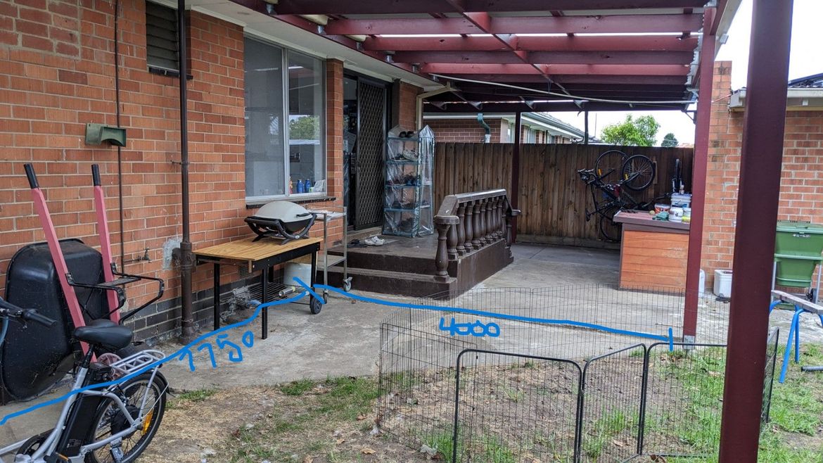

I'm planning on building a low level 4000mm x 7750mm deck that will run along the house under cover of a verandah. The existing area is a combination of grass and uneven concrete.

Ideally I'd also like to remove the brown concrete banister and have decking on the stairs for better flow. How do you suggest I attach merbau to the concrete stairs and create an extra step in front of the existing banister?
