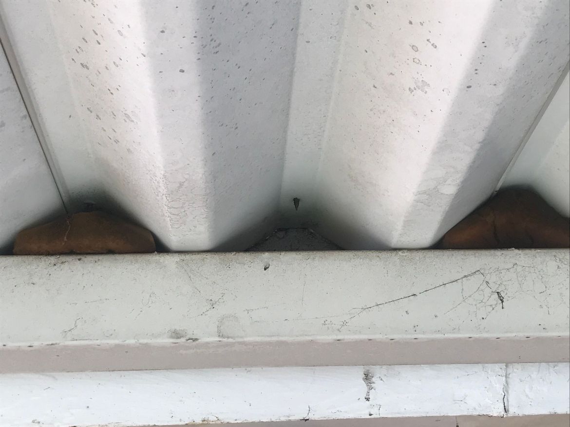

Looking for a solution as to what to use to close off the gaps under the colourbond sheeting. I've temporarily squashed foam pieces in the gaps to stop the birds flying in and building a nest in the beam that has been affixed to the fascia board.
Hello @dee36
Welcome to the Bunnings Workshop community. It's sensational to have you join us, and thanks for sharing your question about your Colorbond roofing sheets.
I suggest using the Bastion 1200 x 600 x 30mm XPS Multi Use Foam Board. The foam board is made from extruded polystyrene and is ideal for use as an insulation which is light weight and strong. With a 50mm closed cell thickness it has high water resistance and thermal performance. Plus, excellent compression adaptability.
I suggest using cardboard to trace the shape of the gap and then transfer the shape onto the foam board. Use a craft knife to cut the foam. Make sure to cut the foam board slightly larger so that it fits very tightly into the gap. Keep in mind that it is better to cut it larger rather than smaller as you can't add on to the foam once cut.
