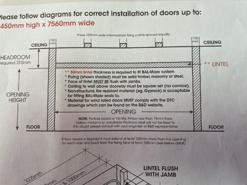

I have been given the schematic in the photo by the garage door people I will be engaging as to what I need to do to create the opening for the garage door. It all seems pretty straightforward. The only question I have is what is the most secure way of joining the 150 mil jams to the 50mm lintel. Nuts and bolts? Metal plates and connectors?
Thanks in advance
