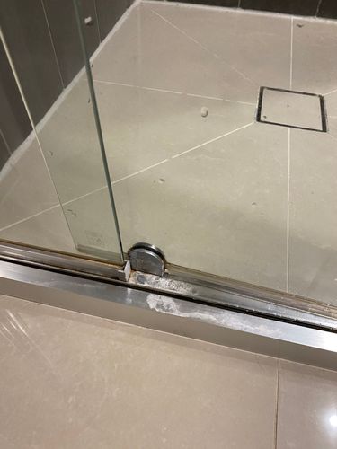

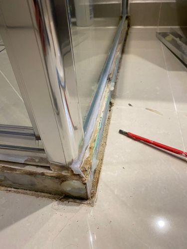

can someone tell me what is it on the aluminium trim is it corrosion or something else
than you
Hello @brinkley
Welcome to the Bunnings Workshop community. It's sensational to have you join us, and thanks for sharing your question about your aluminium shower frame.
What you are possibly seeing are calcium deposits, soap scum or corrosion caused by chemical damage. I propose getting a green scrub pad and see if you can remove the stain at the bottom of your shower frame. If it feels smooth with the scrubber and none of it peels off, odds are the surface has been damaged.
This sometimes happens when very strong cleaning chemicals are used. It strips the protective coating of the polished aluminium and delaminates the surface. You can try to remove the blemish with steel wool, but you will never get the original polish back.

Can this trim be removed and replaced?

If you are referring to the plastic drip strip at the bottom of the glass door yes, it can be replaced. I suggest removing the drip strip so that you can compare it to the ones available at the store. As to the aluminium surround, it is integrated to your shower frame and replacing it would be equivalent to replacing your shower.
Thanks for the reply Eric. Yes we are referring to the Aluminium surround. We were worried it was connected to the water stop or
waterproofing membrane.

As I've mentioned earlier in the discussion you can use steel wool to remove the tarnish on the aluminium frame. You can also try to sand it using a high grit sandpaper such as Flexovit 100mm x 1m 600 Grit Wet And Dry Sandpaper Roll. Just make sure to sand in a straight direction and not in a circular fashion. Please note that it will remove the tarnish but will not restore the original shine of the aluminium.

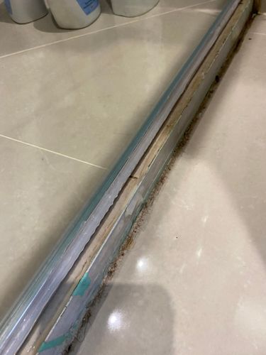

Hi Tony, just wondered what your result was with this, as have same aluminium trim that I would like to remove.
Welcome to the Bunnings Workshop community @Jaycam. It's wonderful to have you join us, and many thanks for your question about shower trims.Let me mention @TonySmith so they are alerted to your question.
It'll depend on the trim’s function in your shower door design. In some cases, the outer trim might be permanently connected to the lower frame, meaning removing it could affect the structure. Even if it can be taken off, it would likely expose the edge of the lower frame, which may not be the most aesthetically pleasing result. Your best bet is to try restoring the trim—if there’s corrosion, you could look at polishing it off, or if it’s looking worn, a fresh coat of paint might help bring it back to life.Please let me know if you have any questions.Mitchell

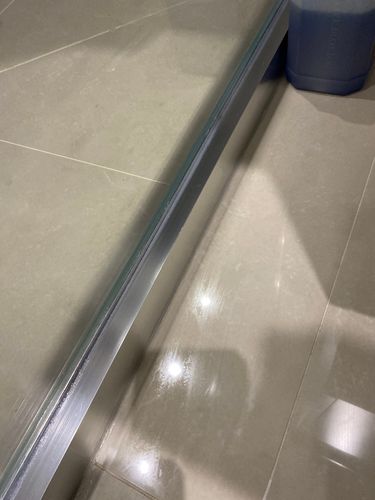

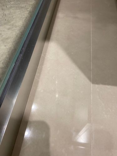

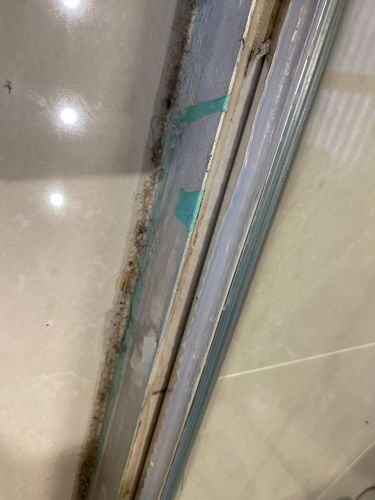

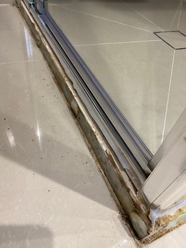

The trim was carefully removed, cleaned, resealed and replaced.
The trim was siliconed on to cover the exterior.
Hello @Jaycam, I have attached some photos. Hope it goes well.
