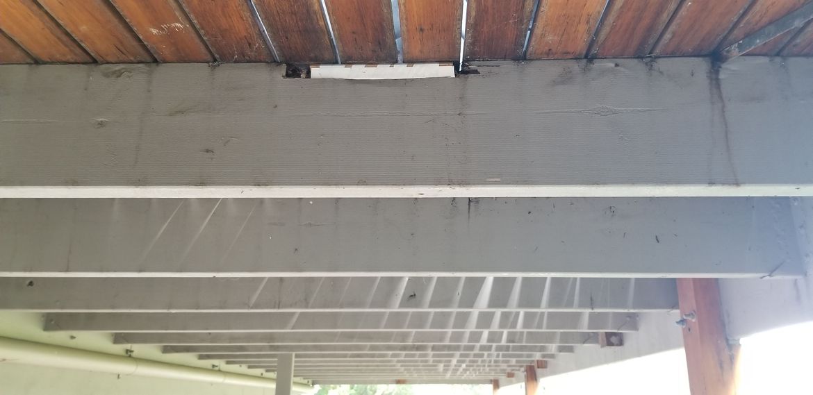

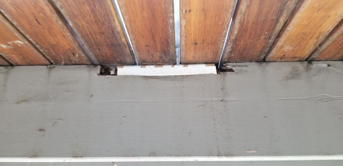

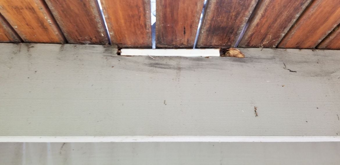

I am looking for advice on how to address wood root in deck supporting structure.
Having read some of the posts in this forum I was going to take the steps below to address it.
1.remove anything soft or spongy with chisel (already done, see photos)
2.apply wood hardener to remaining timber and let it dry
3. source timber to replace empty slot, cut to size, apply waterproof primer undercoat and paint to match.
4. screw or glue the timber of same size into gap
5.fill any remaining gaps with builders bog
6. Seal edges with wet area silicone
Keen for some feedback on whether or not those steps are appropriate?
What type of timber do I need to source for outdoor frame?
At what point do I need to be concerned about impacting structural of remaining timber ?
I attached some photos where I have completed step 1 above and just put a supporting piece of timber as interim measure and covered up the area with a tarp to prevent further rain exposure until I hear back from this forum.
Thanks
