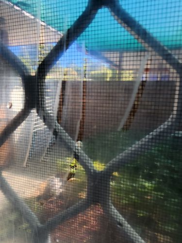

how can I get old film off my window. I have tried almost everything and still won't come off?
Just to add, make sure the surface is well and truly wet when you scape it off so the glass wont get scratched

The actual film was taken off by previous owner and they didn't remove the sticky part.

If that's the case, then removing the sticky adhesive should be straight forward. Spray the De-solv-it onto a small section and let it activate then slowly use the scraper to remove it in sections. Don't spray the whole window, only do one section at a time to get full use of the spray as it dries fast. If left alone the spray dries off and the adhesive goes sticky again.
