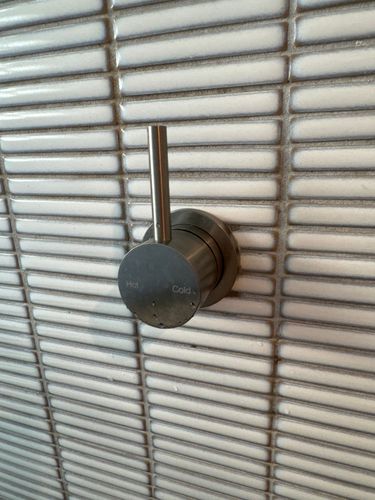

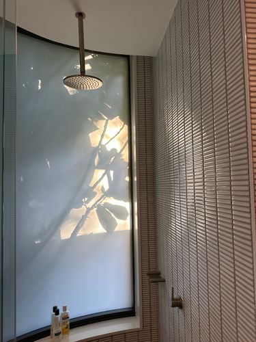

The issue with adding a second shower head is isolation control. You've got to be able to turn off the rain head on the ceiling in order for the other head to function. Placing connections to the existing head won't work as you would not be able to reach the controls as they are near the ceiling.
Rerouting the plumbing would be an option but that would mean that the rain head on the ceiling will need to removed. You could replace it with a Flexispray WELS 3 Star 9L/min Chrome Havana Short Twin System. This has an integrated controller, and you can still use your existing shower mixer attached to your wall.
I propose speaking to your plumber and showing them the shower head and asking them the best way to reroute the plumbing.
