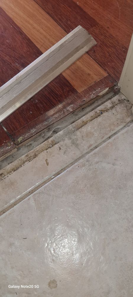

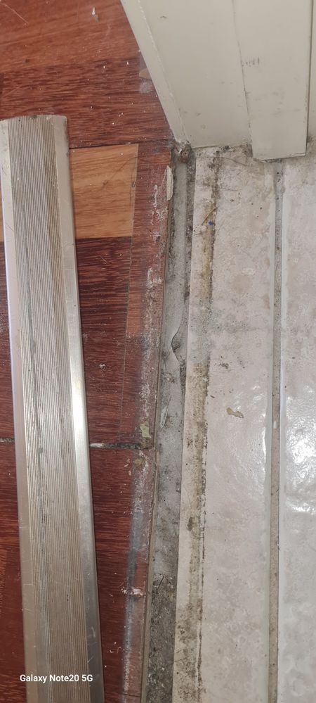

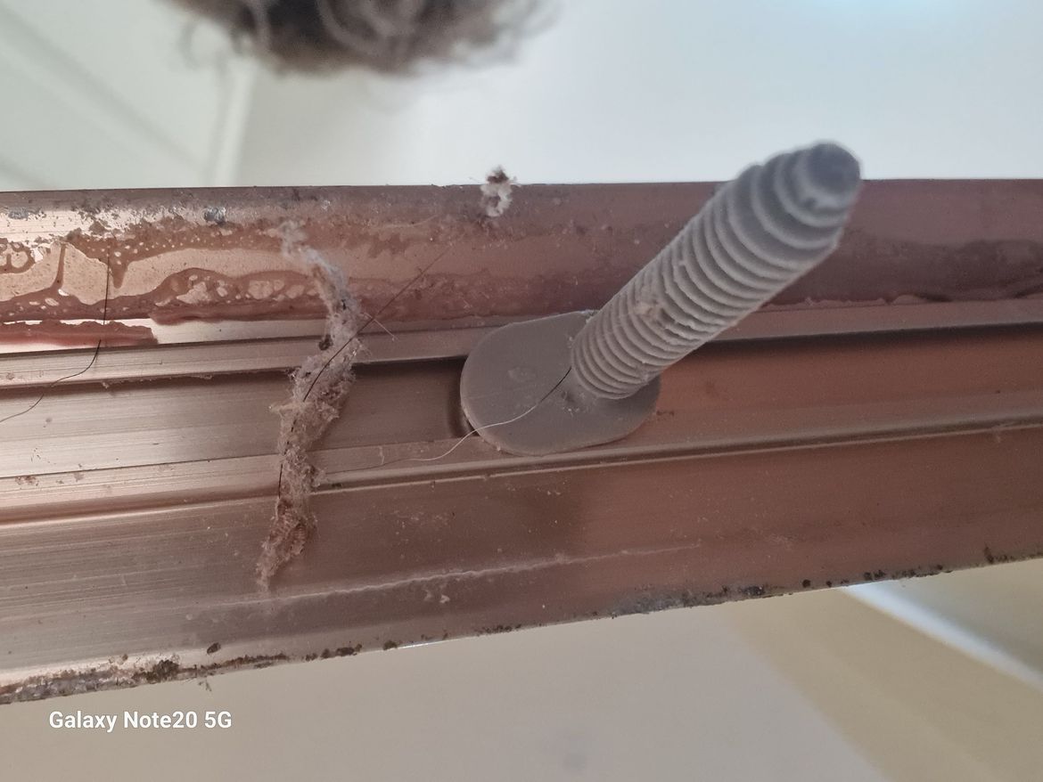

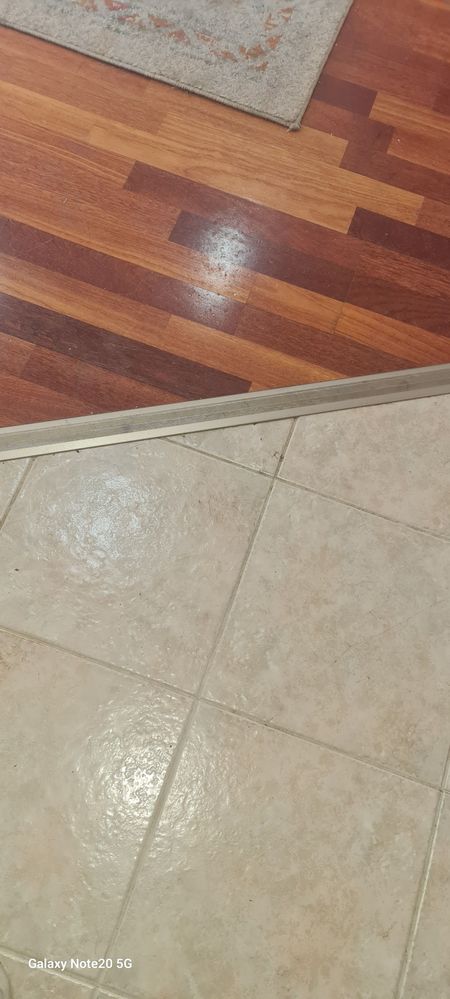

We have metal transition strips between tile and floating wooden floors. I hate them - to make matters worse, the builder (years ago) used different styles so they are not consistent. Would love to replace them with wood transition strip or wood effect strip. Any tips on what to use? I pulled one up and the wooden floor board level is about 6 mm higher that tile level. The metal strips are T-transition strip I think which were fixed into the concrete slab with a couple of whacking big screws.
PS I think the gap between the tile and wood is also too wide for one of those trough shaped transition strips but open to suggestions for a more modern look (other than replace all the floors, which is not an option unless we win lotto)

It appears that some of the gaps you have are quite large. I'm sorry but our transition strips have a limited size and might not be able to cover such a large distance.
However, if you have a router or can borrow a router, it would be possible to make a custom transition strip from timber. This would allow you to stain and seal the timber and have a uniform finish through the entire house.
I propose looking at 116 x 11mm 5.4m Moulding Pine FJ DAR Clear. Using the router, you'll be able to cut channels and round corners to create the perfect transition piece.

There are transition strips at the doorway at the moment - I pulled it up for the photo. The current strip is 4 cm wide, it that helps. It looks like a t-shape strip, with the addition of a screw into the concrete.
Mainly changing for aesthetics 🙂
Unfortunately I don't have a lathe or any experience shaping wood.

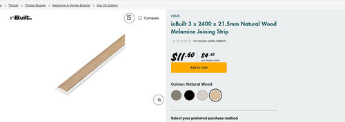

Hi @HJS If the original strip is 25mm wide you could change it for something like this, otherwise I agree with @EricL to fabricate your own dividing strip.
There are many other styles online that may give you some ideas of design you require.

There are a number of transition strips available at the store, I suggest bringing some of the strips you have and compare it to the ones available at the store. Your goal is to find compatible strips in the same size and style as the ones you have.
Thanks Joe and Eric,
I'll take the strip fully off and bring it in as you suggest. Thank you for your help.
