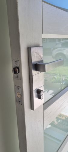

Hi Bunnings Workshop Team,
I want to install a smart door lock. What is the appropriate lock for below?

My apologies for the late reply. The closest smart lock I can suggest to your configuration is the Lockly Duo Compact Satin Nickel. It is WiFi compatible, and you get full Control with Smartphone Unlock, lock, check door, track access history, and unique users in real-time from anywhere through free LOCKLY smartphone app.
Configuration and latch distance will need to be double checked before installing the lock. If you need the door lock to be installed by a professional. I suggest speaking to the special orders desk at your local store regarding the door lock installation service on offer.

As there are 2 bore holes, could I use a normal lock on 1 and use a smart lock on the other?
Hi @badmojo,
The lock @EricL has linked utilises both holes, including the handle lock and the deadbolt lock. You'll need to verify on specifications whether the current holes can be used or if they need to be filled and new holes to suit the lock must be created. If the holes do not correspond, I'd encourage you to take advantage of our installation offer and have a professional do the install.
Thanks. The suggested lock seems too thick for the door so now keen to just utilize one hole for smart lock and one hole for a normal lock.
The Lockly Duo Compact Satin Nickel suits the standard thickness of a front door. Is there some information you ran into that suggests otherwise?
Here's our range of smart deadlocks.
Some of the reviews online mentions that the overall profile is thick. Thanks though for the suggestion and will take a look in store.
Most digital smart locks are significantly thicker than traditional locks due to housing the electronics @badmojo. I'm unaware of the Lockly Duo Compact Satin Nickel being much thicker than other smart locks, but as you mentioned, it's worth checking them out in-store.
