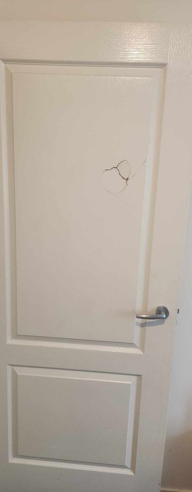

I am wondering what is the best way to fill a palm sized hole in an internal wooden door?
Would you use a foam filler with putty over it? Or should i cut out the broken pieces out
and fill the hole?
Doors will be painted after!

Welcome to the Bunnings Workshop community. It's sensational to have you join us, and thanks for sharing your question about your damaged door.
I suggest having a look at this discussion - How to repair a hole in this hollow internal door? by @beebee. This discussion pertains to door damage that closely resembles yours.
If the damage is not too severe, I propose trying to glue the edges of the damaged pieces using Selleys 130g Liquid Nails Ezi Press. Otherwise, the recommendation of using a filler such as Builders Bog will be your other repair alternative.
If you have any other questions that we can help with, please let us know.
