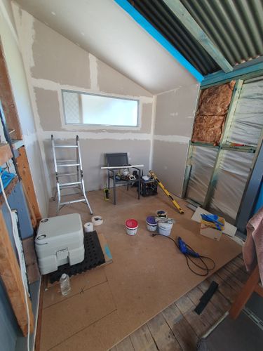

Hi guys, I am currently extending and fully renovating a bathroom in a house that is 100 years old.
I have couple of questions before I go any further.
I am having an open shower which will have 1 glass shower panel from a yet to be built wall. I do not want a shower base. I have a horizontal drain for the shower which will be installed against the wall of shower.
Question1 is can I tile the entire bathroom floor including shower continuously with no lift or base for shower?
Question 2 is once I've cut the drain holes and tap/faucet holes in floor/walls do I just go ahead and waterproof or am I missing steps?
