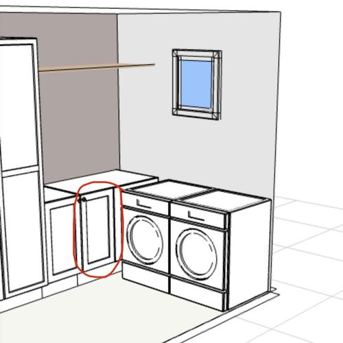

Planning our laundry, can the door go on the blind corner base cabinet as shown in the pic from the designer? If so, how? (As in, where do the hinges go?)

The door hinges are attached to the included panel, which encloses the concealed area right next to the door. The panel will be hard against your appliance. If you watch the video below showing the assembly steps, I trust that will become clear.Please let me know if you have any questions.Mitchell
