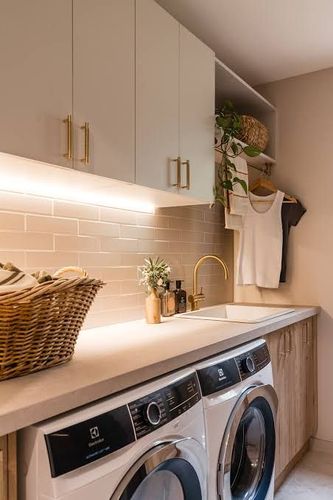

Hi, I am looking at doing something similar to the below image. I’m looking at having the front loader wash and dryer side-by-side. I’ll have Kaboodle base units (400mm and 200mm) either side of the washer+dryer. I’m looking at using the Think Solid bench top. My questions are; how would I have support for the bench top over the washer/dryer as the gap for the two will be 1300mm? Also would I need to install kick boards or end panels on the inside of the washer/dryer gap?
Thanks!
