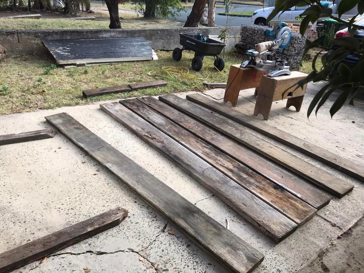

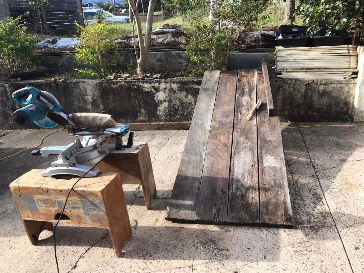

I had never built a freestanding table from scratch. I was super worried about it being high enough to be comfortable and easy enough to sit with your legs underneath it. I was also worried about getting everything right and being solid enough to sit at.

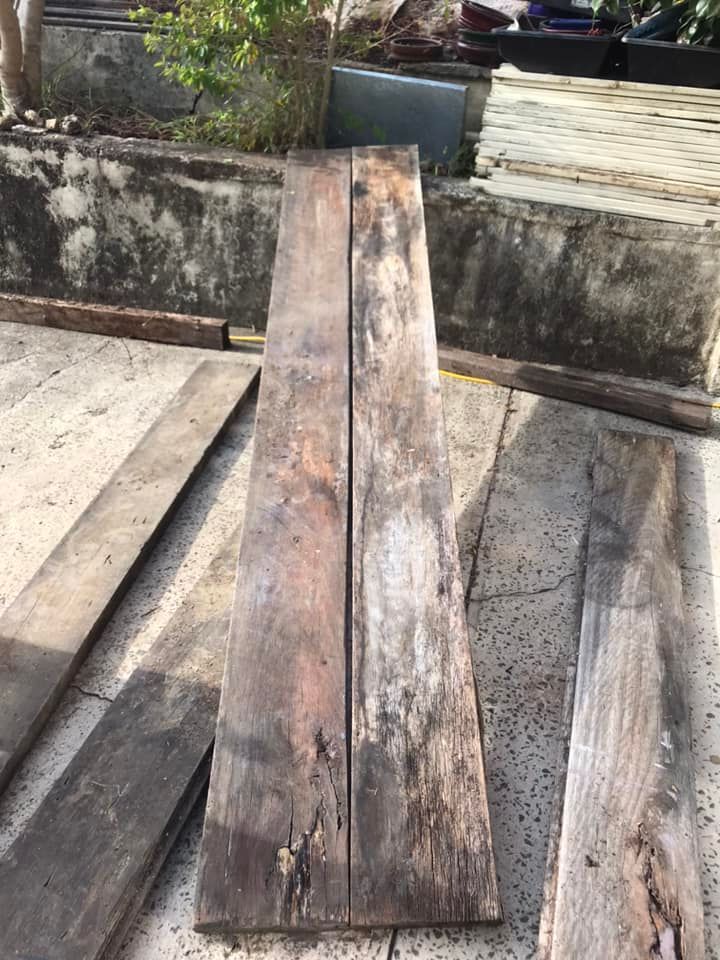

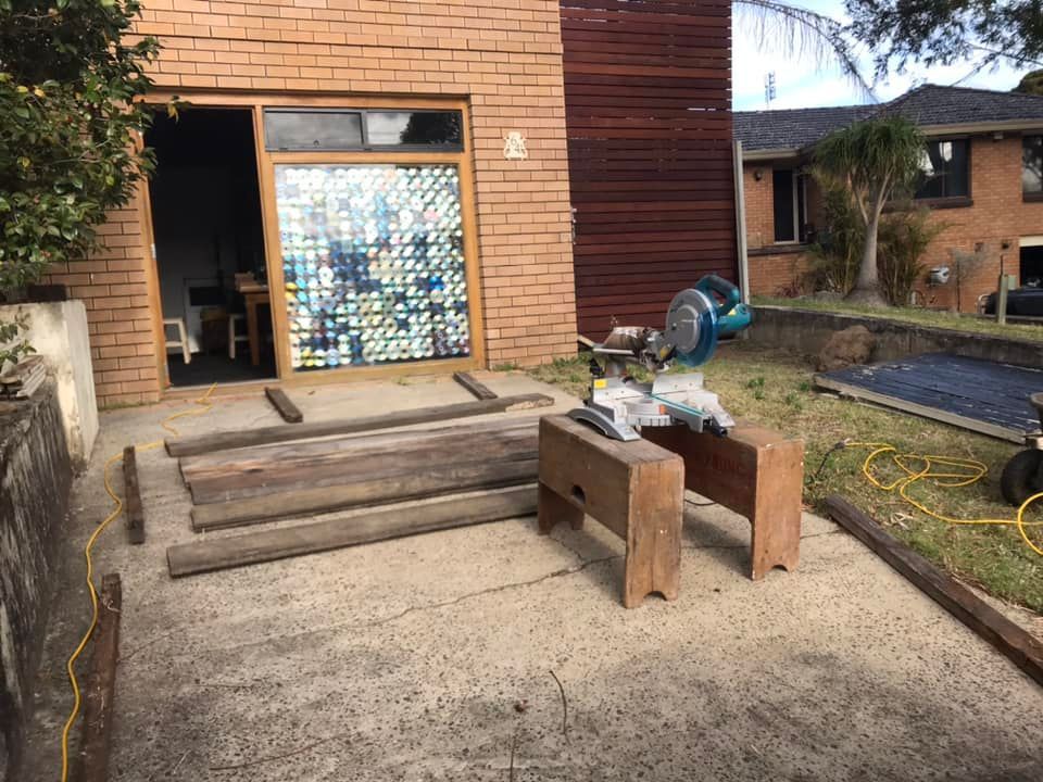

As the old boards I had picked up had been used for concreting, I was reluctant to plane them as I figured there could be dirt/concrete/rock embedded in the timber. That would chew the planer's blade like crazy. It felt smooth to touch, so I decided to oil it instead.
Working out how to put the table together with what I had.
The timber planks had a tongue and groove to them.
Even though they have a bit of a twist, some went together easily enough. Others had a bit of a gap.
Tapping the timber boards together with the mallet really helped.

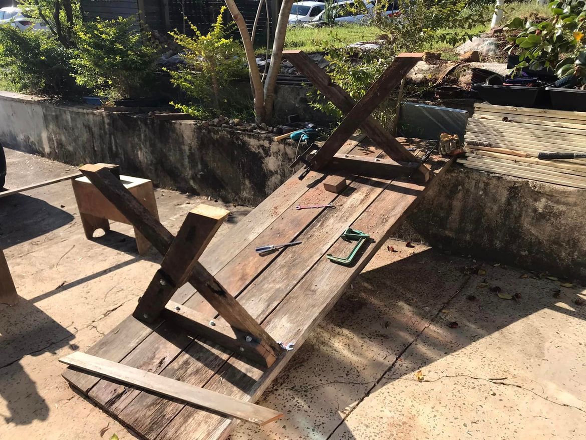

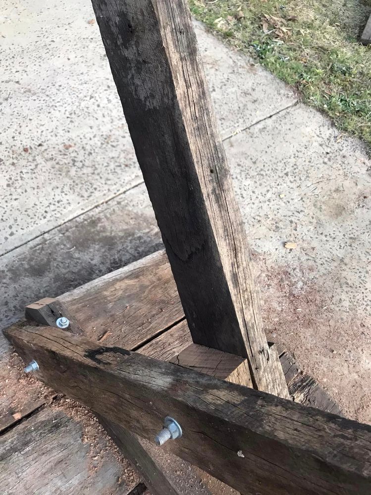

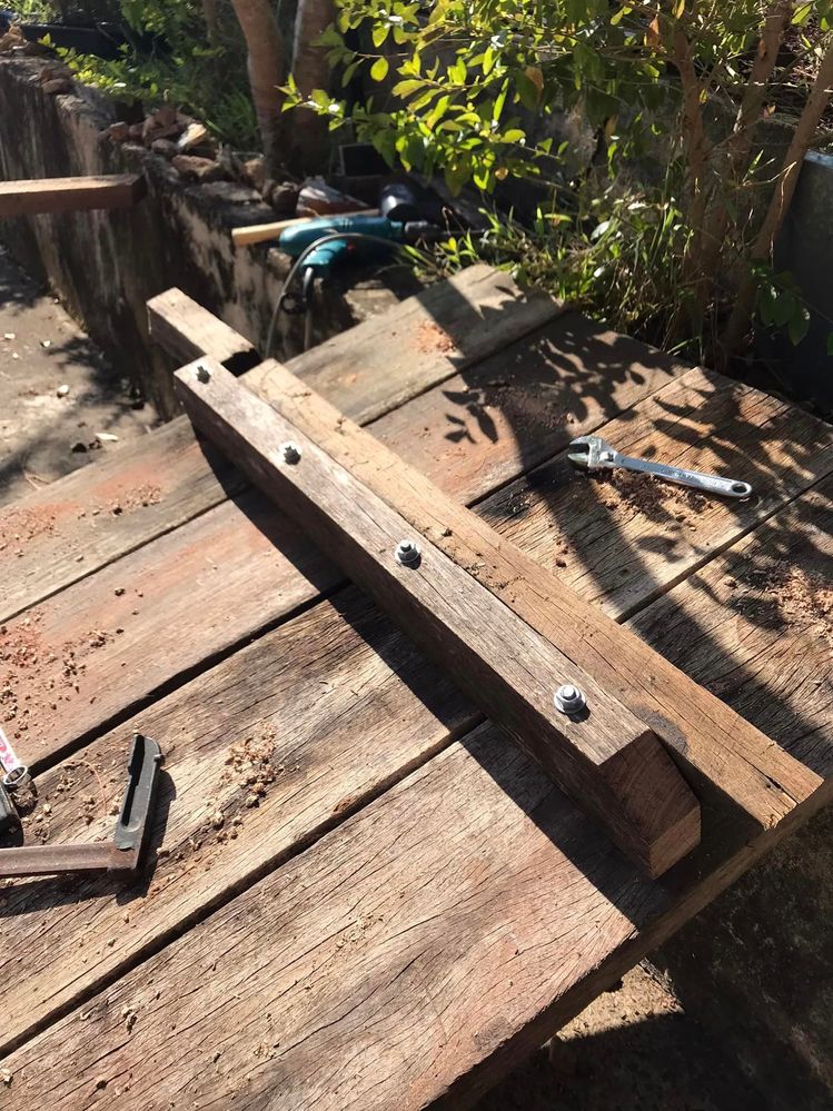

Working out the supports across the underside of the table. I decided to use coach bolts down through the top and through the long side of the 50 x 100mm timber.

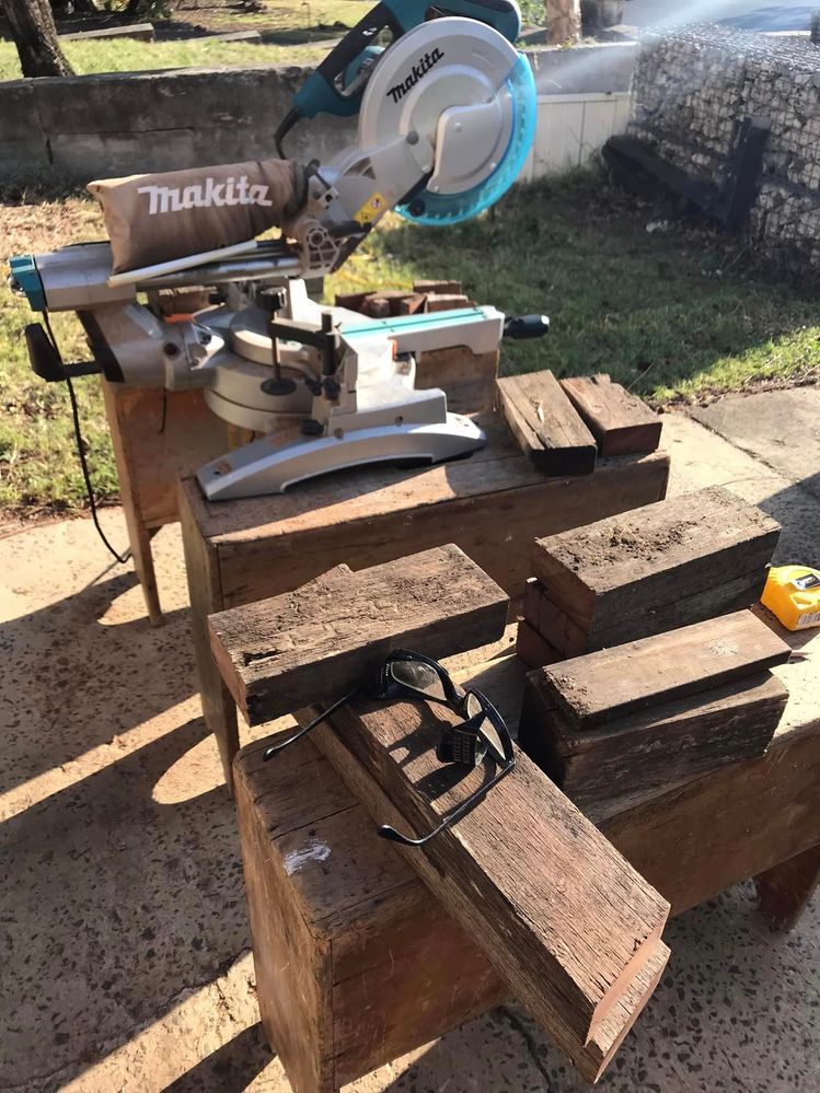

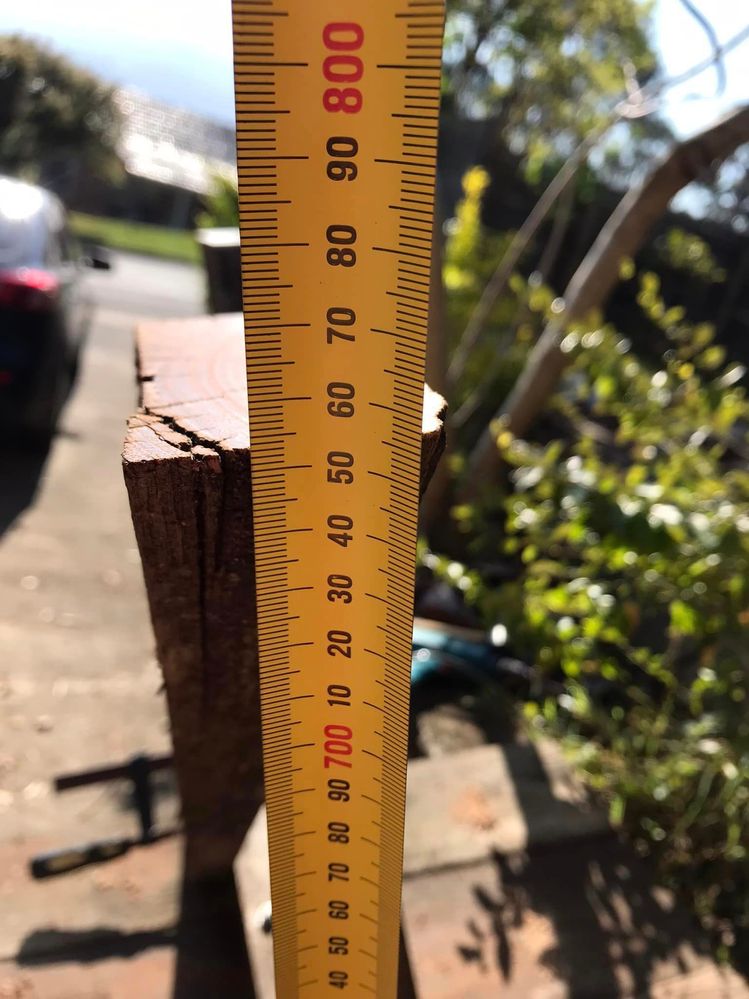

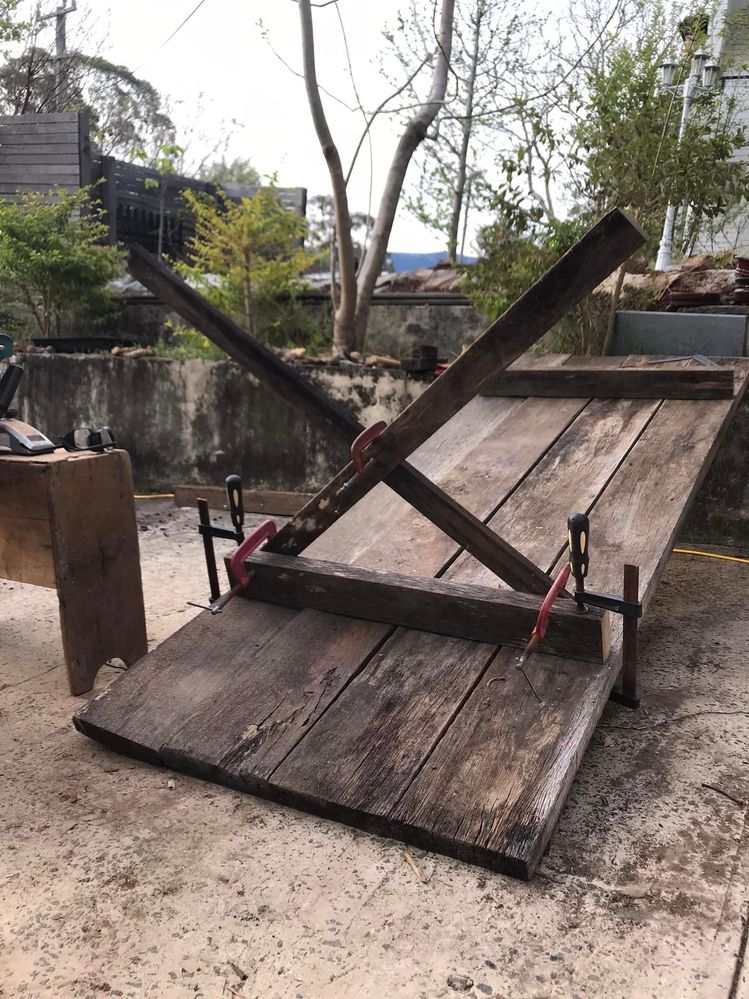

Having never made legs for a table before, I was using test pieces to get the angles right.

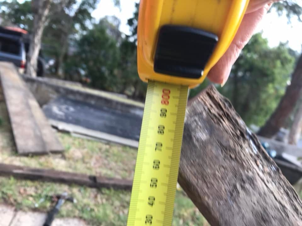

The height I was thinking of was 790mm from the floor to top of the table. It ended up being 790mm.
Step 2

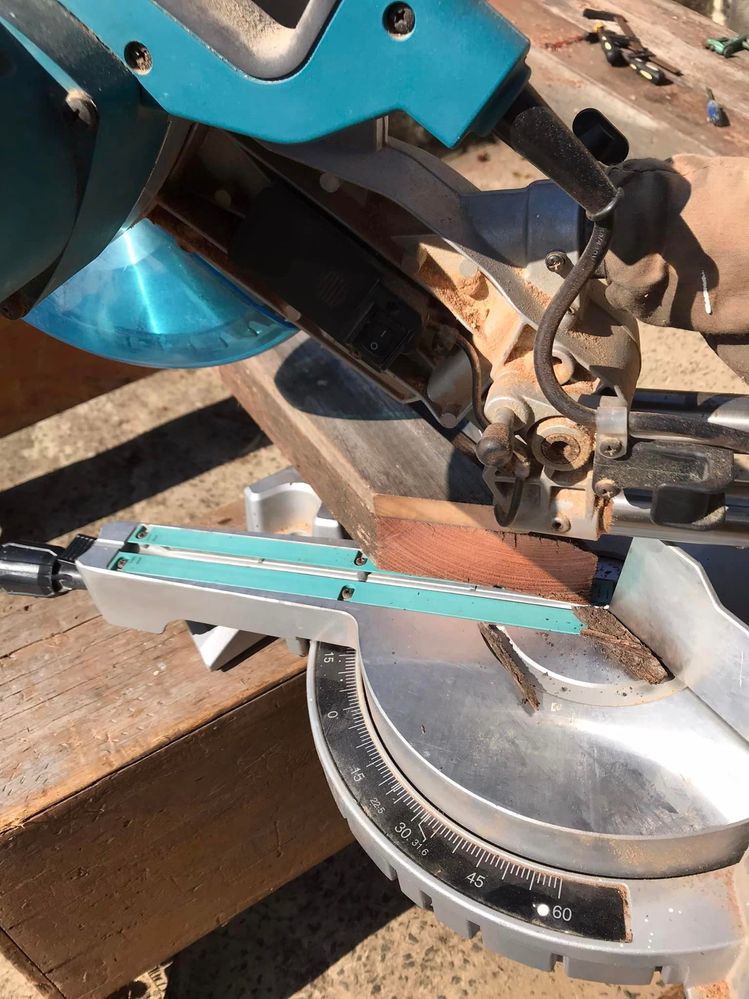

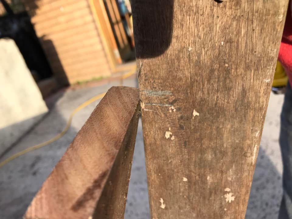

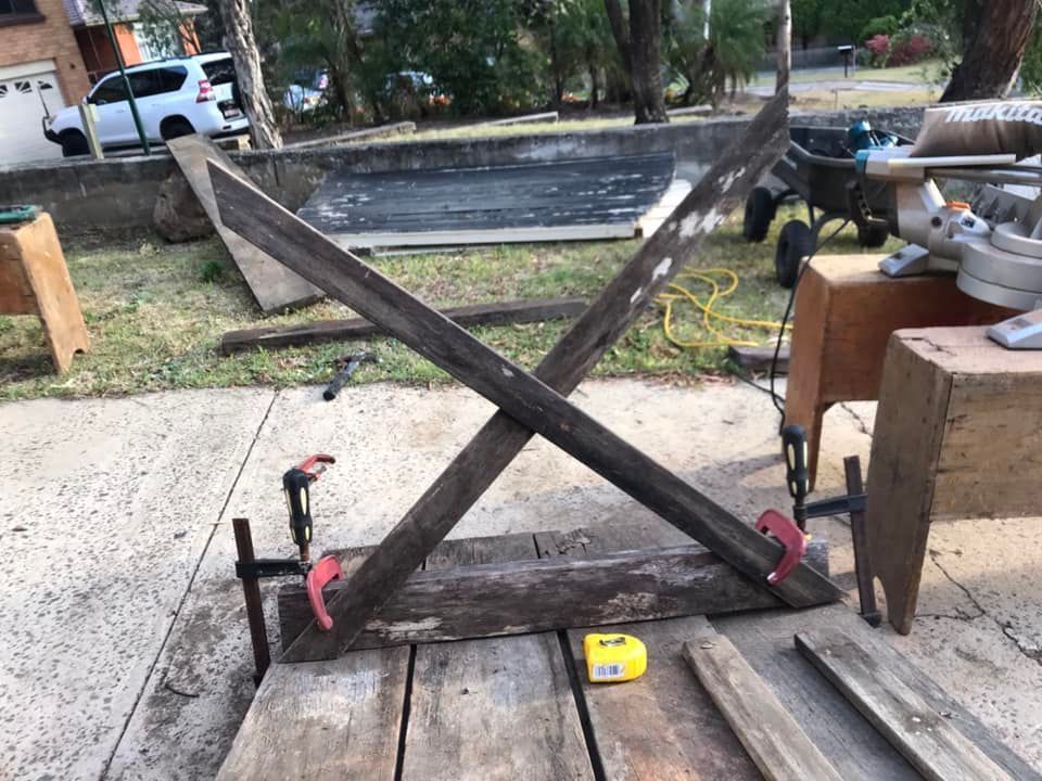

I had worked out the angle to cut was 45 degrees and I had it worked out how to cut both ends of the legs.
I was surprised at how it worked out. So I cut the other end of the legs.
Unfortunately, I messed up. I thought I had figured it out but somehow I cut the legs the wrong way. It was an easy fix as these were only "test" pieces. Here's my measuring stick to make sure all the legs were at the same height.
Step 3
The test legs worked out. Now to cut the true legs.

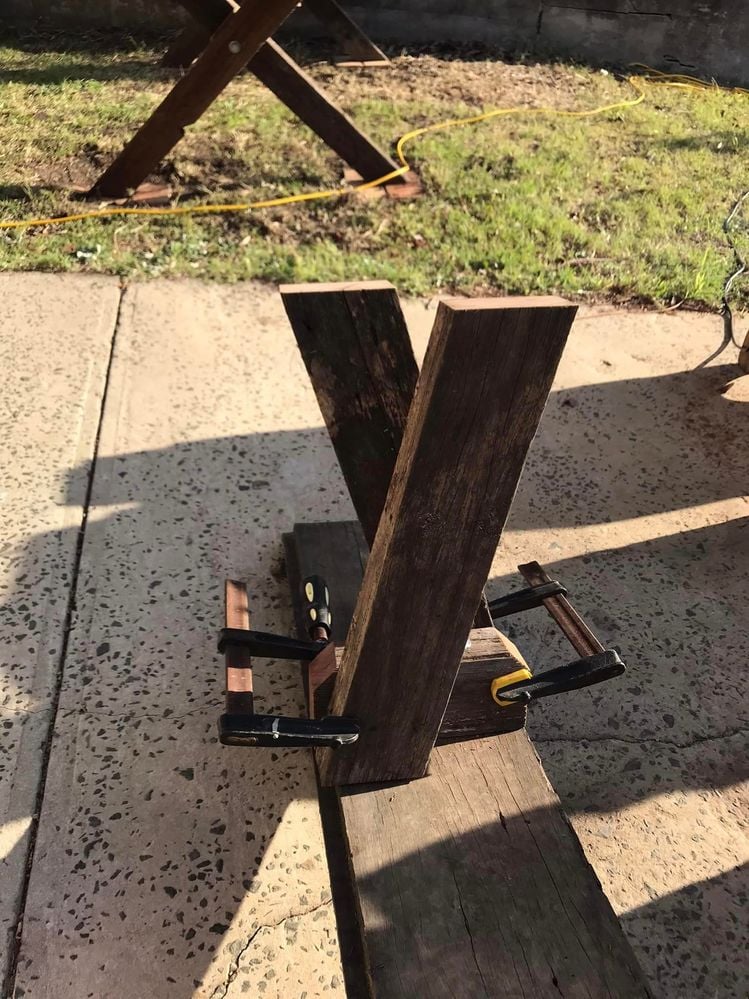

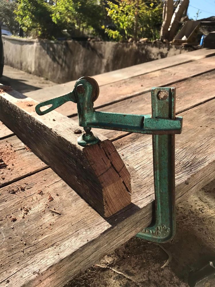

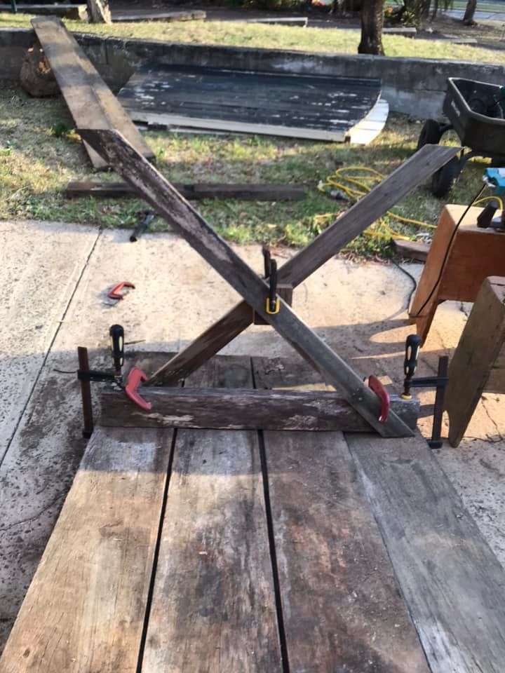

This is the base plate. I decided to give each end an angled cut to stop knees from banging against them so easily.

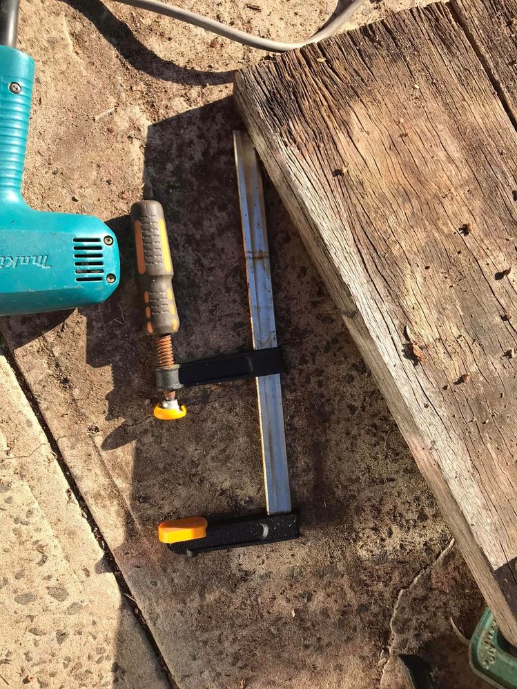

And, of course, the angled cut comes back to haunt me. Trying to clamp on the end of the timber plus drill down was problematic after I cut that tiny bit. Luckily, I had this old school clamp that was low profile. It worked a treat.
The depth that the F clamp can go in is limited to the distance between the orange plastic foot and the silver metal edge of the bracket.

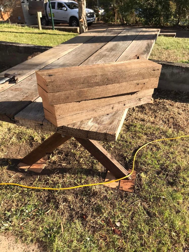

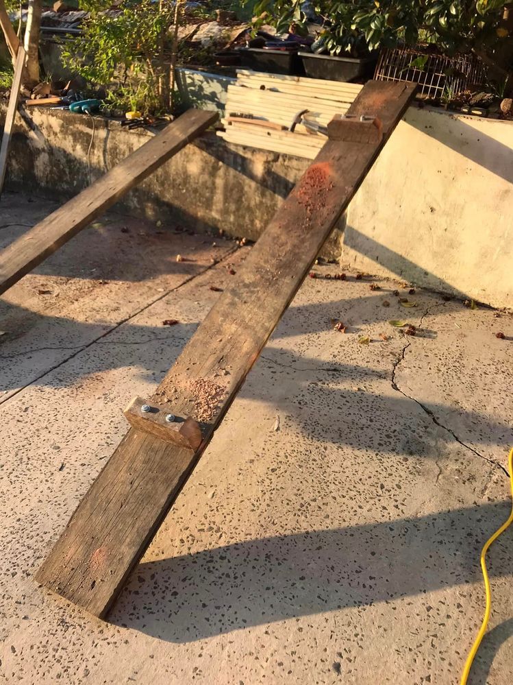

First half done. This table is going to be heavy.
This shows the spacing block at the cross point.
Step 5

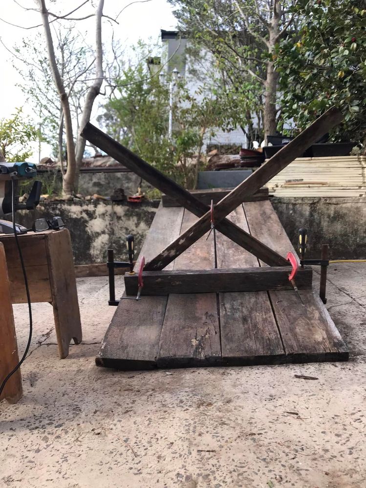

The second set of legs, 450mm in from the edge.
Using my test pieces as templates. It made life a lot easier.
Both done. I was cheering.
750mm to the underside of the table, 790mm to the top.

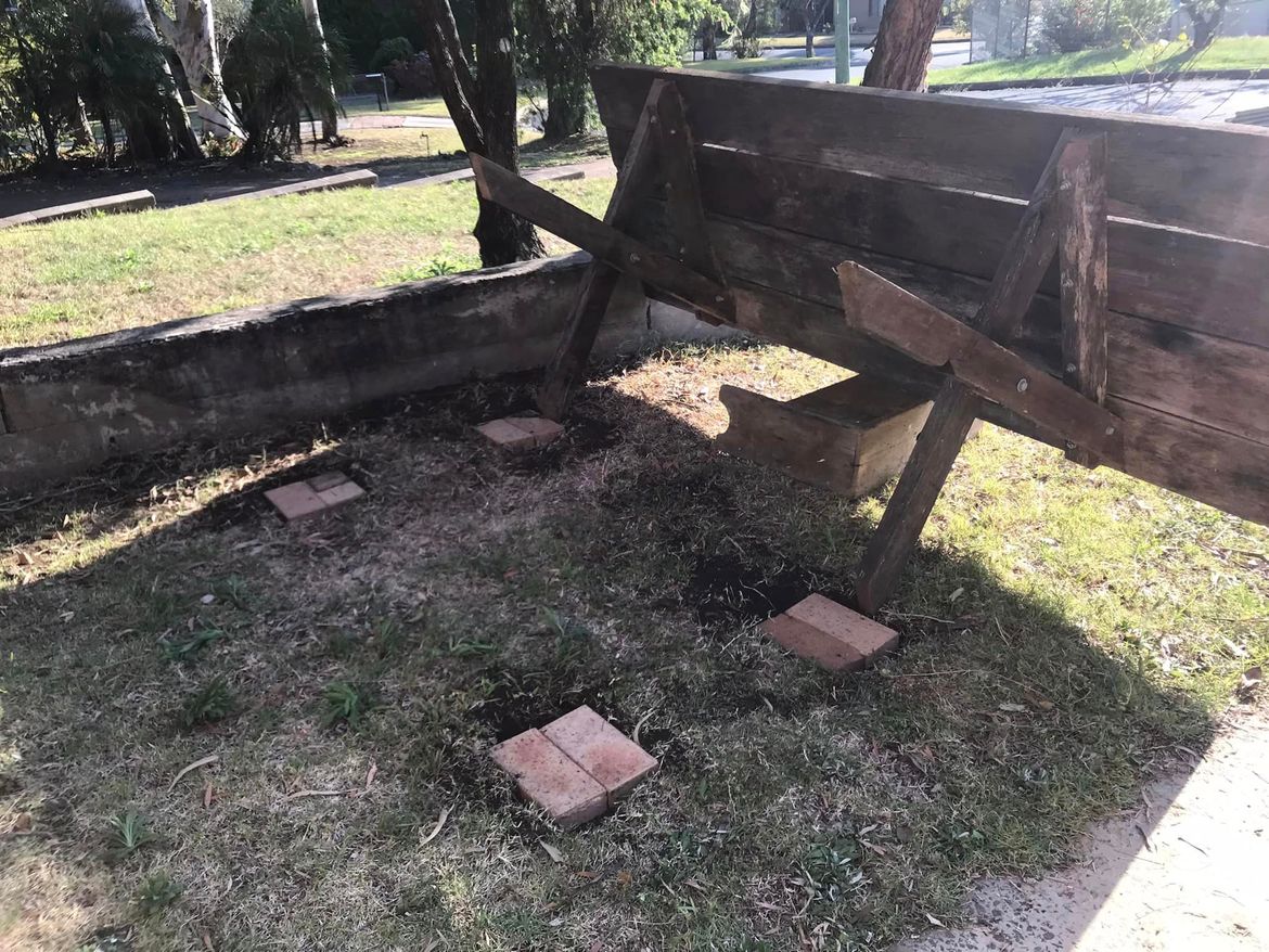

Once I placed it on the ground, it really showed up how uneven the ground was.
Step 6

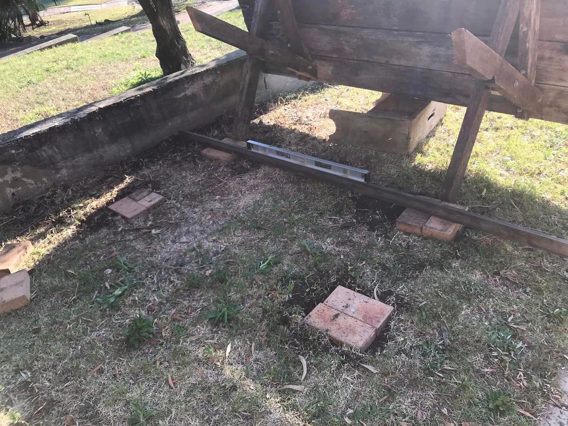

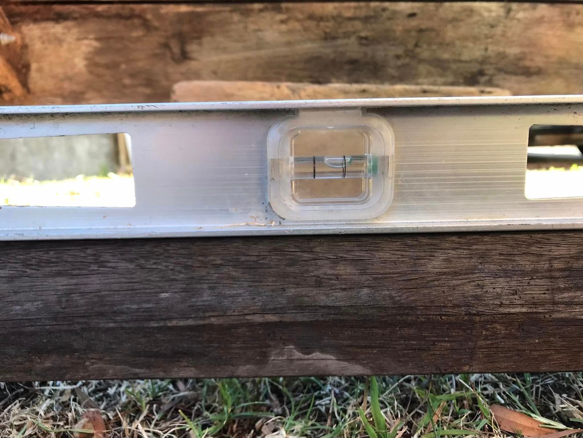

I also did not want to rest the timber feet directly on the ground, so I placed some pavers down first.
Levelling the pavers.

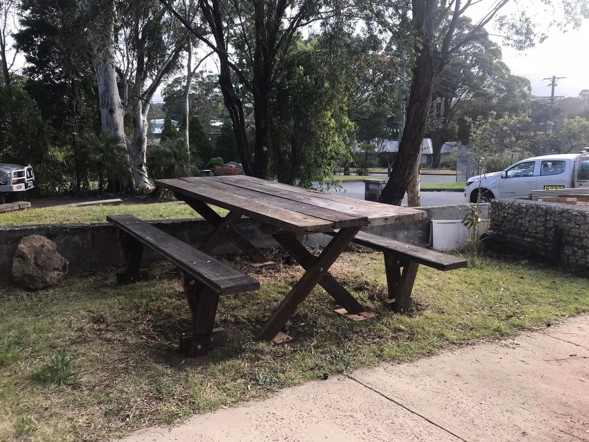

All done. The ground needs to be levelled and the table/legs/benches need to be oiled.
The best bit is it blends in to the garden nicely. You can walk past and the greyness of the table doesn't catch the eyes. If I had planed or sanded, then the red would have been bright.
Step 10
Later, I oiled the table. I had half a can of clear timber oil that I used on the underside of the table. I ran out before I could do the tabletop and the top of the seats. I used Merbau natural decking oil as I was going cheap and figured I'd use a little for the table and the rest on the patio timbers when I put them up. I'd already gone through a third of the can and that was just the first coat. The red Merbau really comes up nicely on the grey, aged timber.
