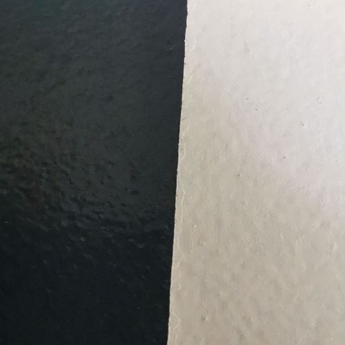

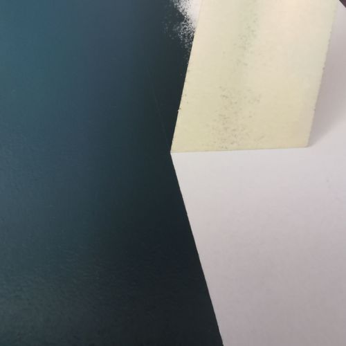

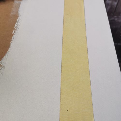

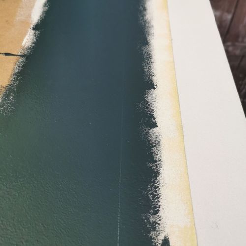

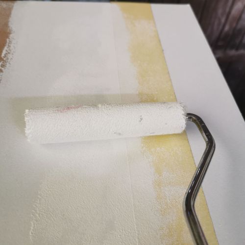

Ever wondered why home improvement shows never show a close-up of striped or geometric patterned walls after they are done? It's because bleeding under the tape is typically unavoidable due to the paint's stippled surface. The paint just creeps under the tape. This can be somewhat avoided by ensuring it is rubbed over and adhered very well. You can also use a brush and stipple the taped edge, making sure to keep the brush perpendicular to the wall.
Here's the best tip I've ever learned, which will give you near-perfect results. I've gone and taken some images for you of the process to better illustrate.
You'll get the crispiest lines you've ever seen. The last image is at a near-microscopic level. You can see the bleeding my sealing coat did, but it's unnoticeable.
