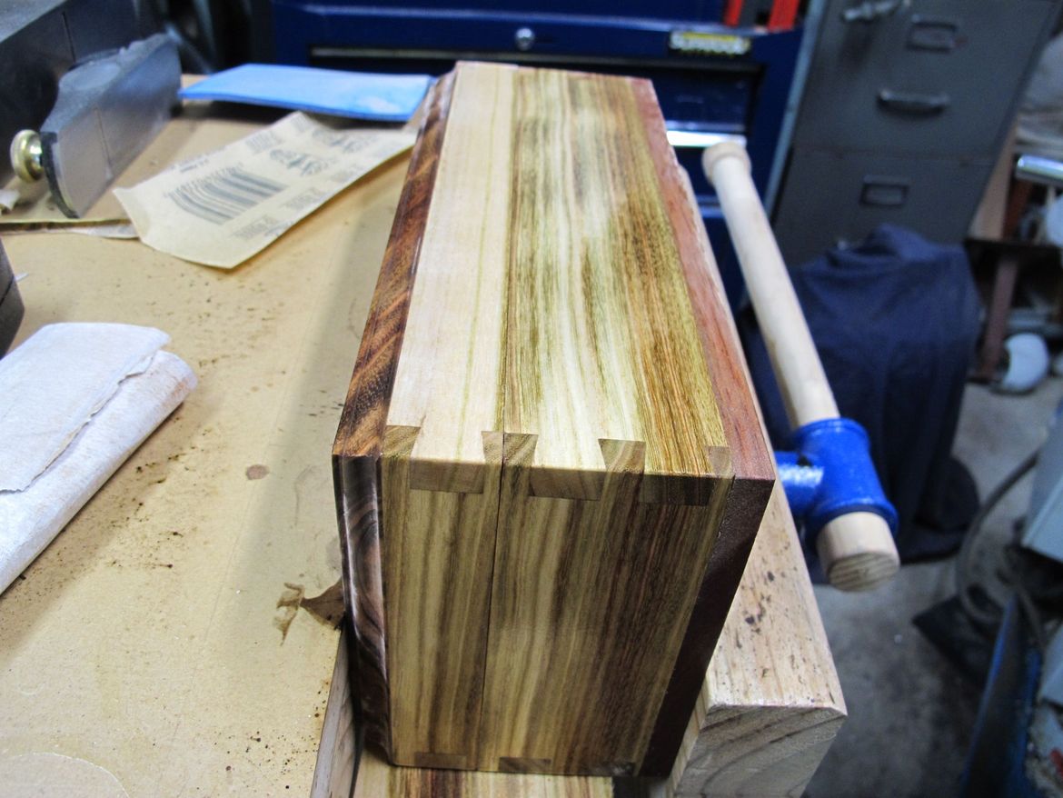

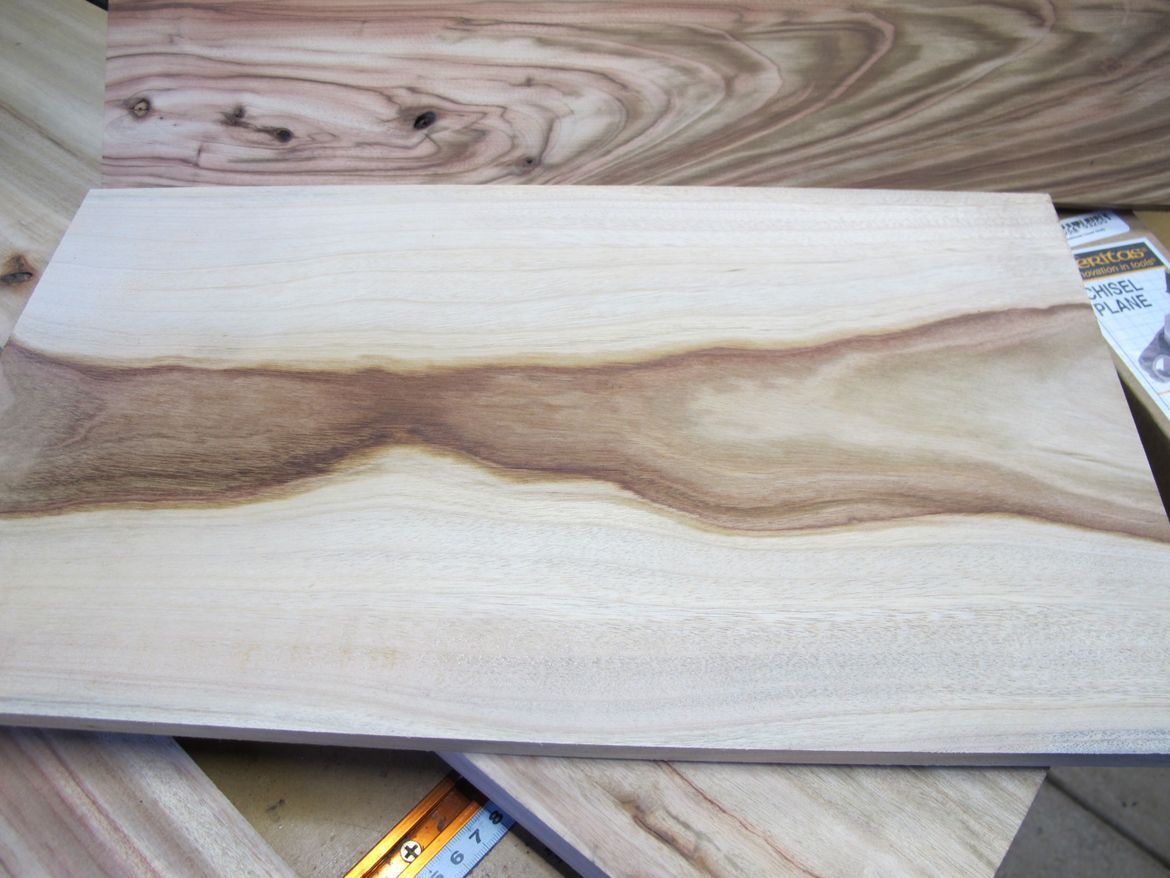

A couple of months ago I managed to grab a hold of some camphor laurel with some great colours. The hardest bit was working out what material I was going to use to finish the job with. The next task was what to do? I have decided to make another jewellery box and handcraft the whole unit where possible.
I am going to do Dovetail joints and use hide glue. I have not used camphor laurel before so it’s going to be interesting how it finishes.

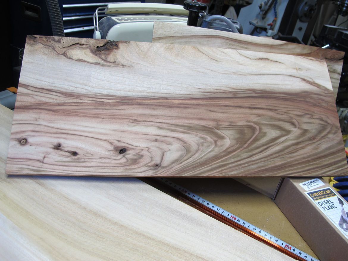

The lid will be made from the pinkish material as it present more of a challenge, because of its colours.

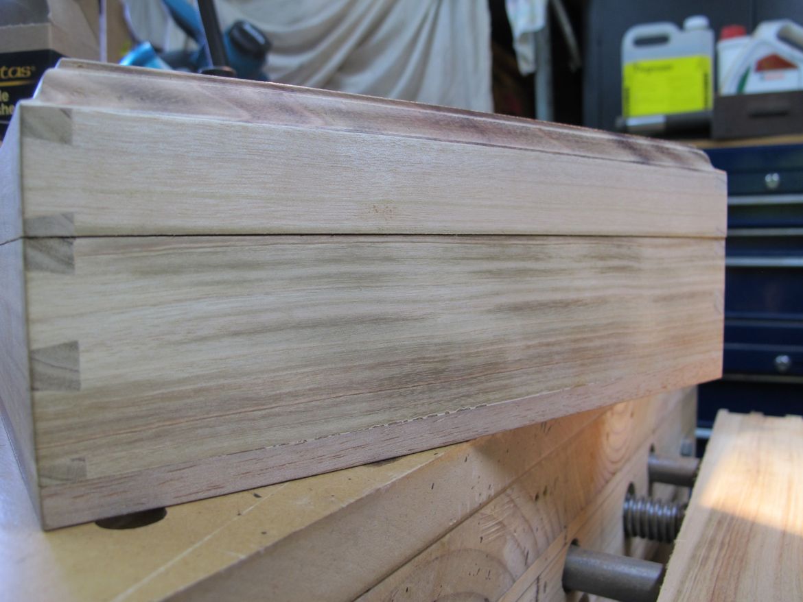

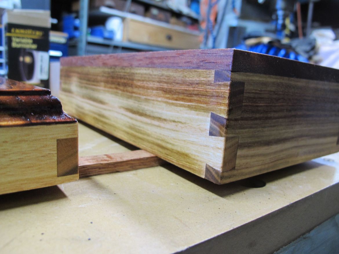

After cutting the dovetails and gluing and squaring the box it was set aside to dry. I cut the material for the lid. This is where things get a bit tricky if the box is not squar, cutting the lid will be out and not fit correctly. I set the saw table so the blade cuts just deep enough so as not to cut through leaving a very small amount of maretial in place so the lid will not c;lose up on the saw. Using a box cutter to release the lid.

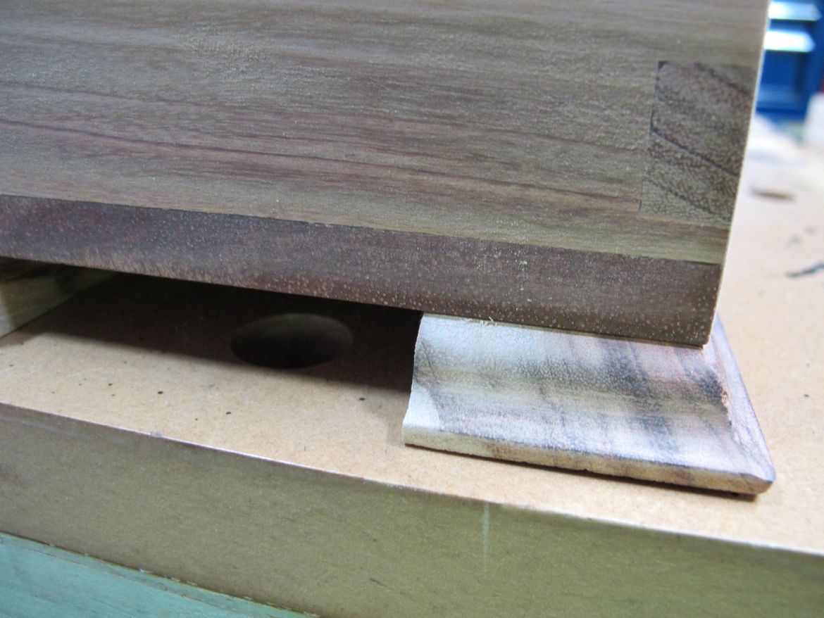

The bottom has been fitted and planed to ensure a good finish I have used a scraper to ensure all faces are square and readry for sanding.

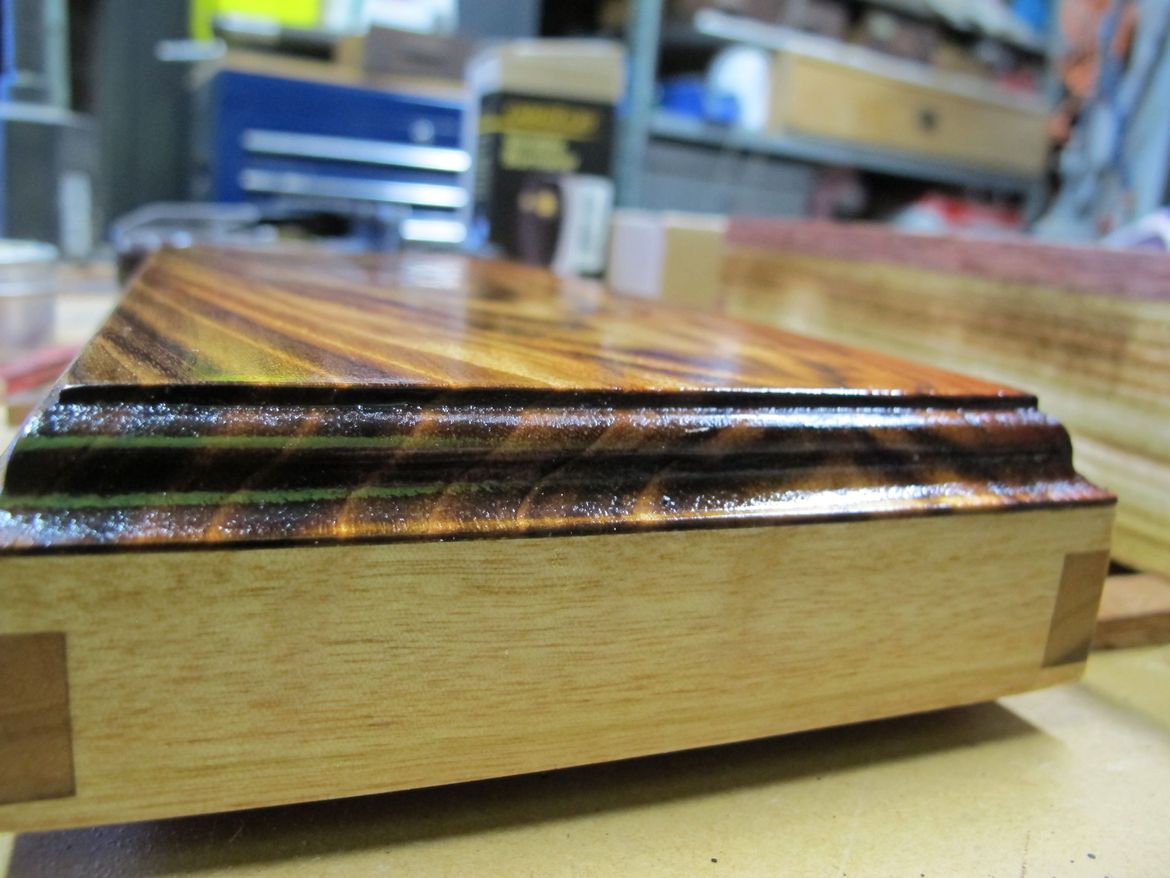

After scraping and sanding a good spray of metho to release all the small fibers that stick up after appling a varnish or what ever one uses. Using metho drys out not leaving moisture in the timber.

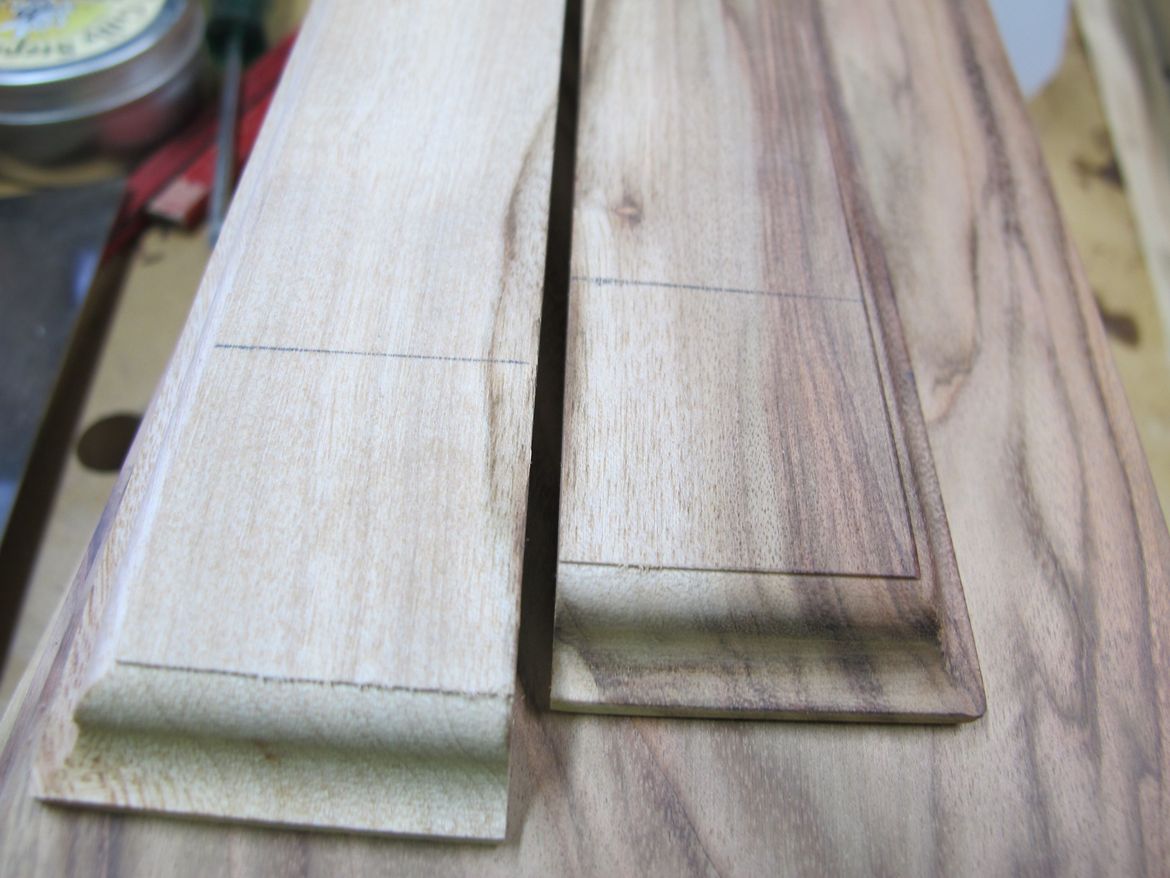

I this next photo I am going to make a set of feet using the same router form as the lid

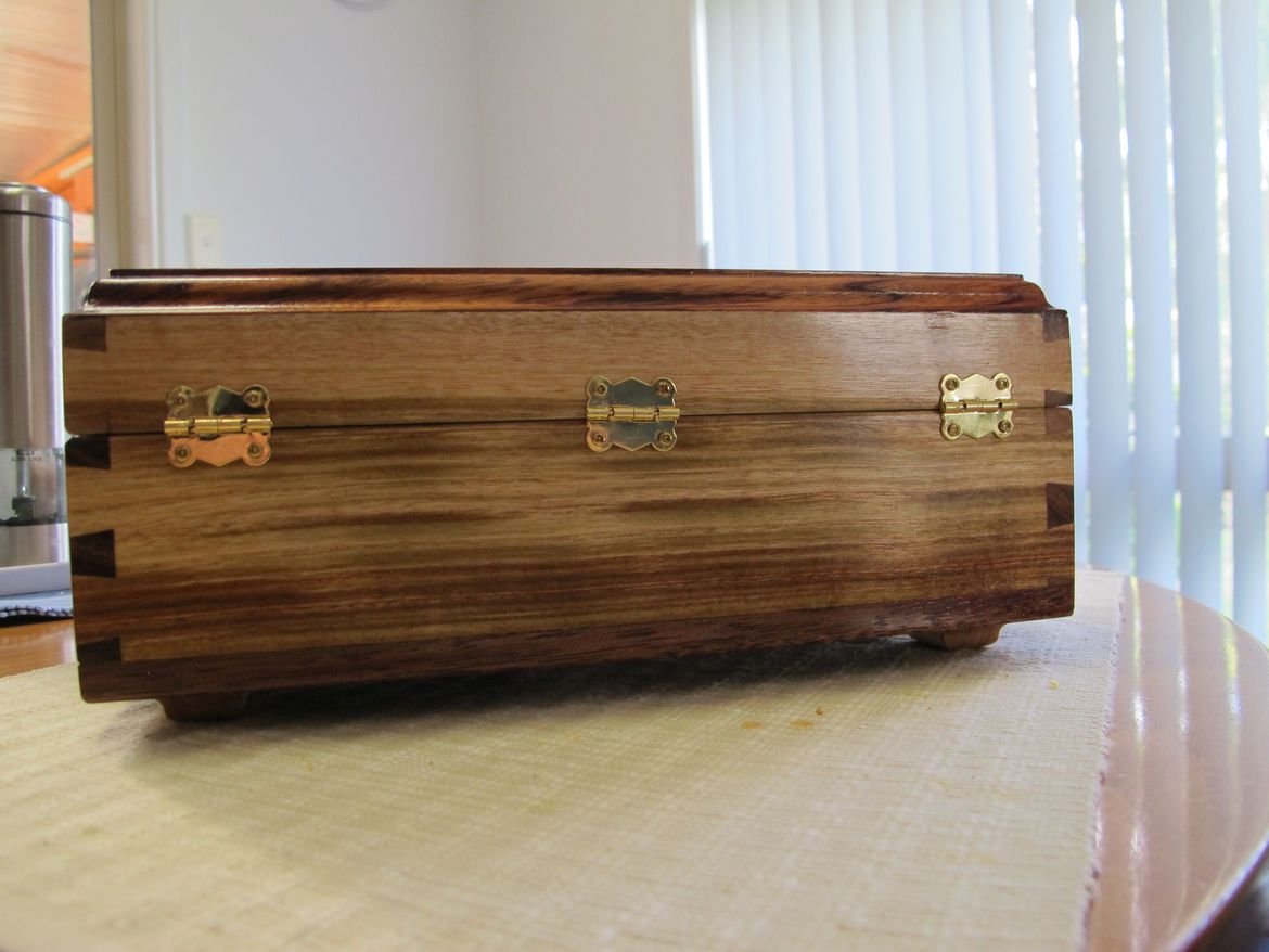

Hinges and latches to be fitted the the final coat of sealer
I am looking forward to the fininshed product after spraying the metho on the box the colours are looking great.

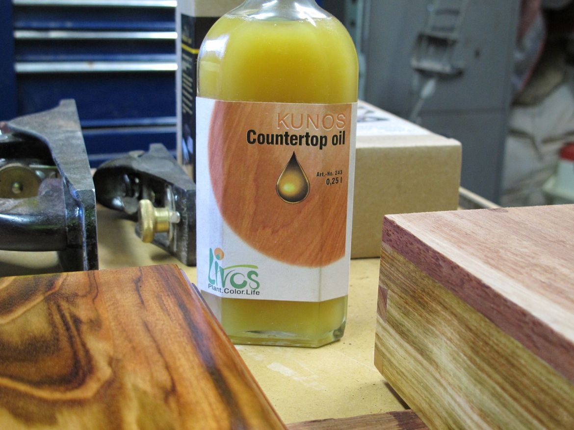

I have now given the box a coat of Kunos oil The pinks are not standing out as I though they might but happy with enhancment of grain

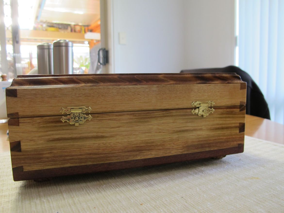

After a short delay and a bit of rework I am now ready to line the box and perhaps fit an extra tray inside the box.
I am impressed with the Kunos oil and the finish. The only issue is the cost factor and that it takes up to 24hr to dry after the first coat
