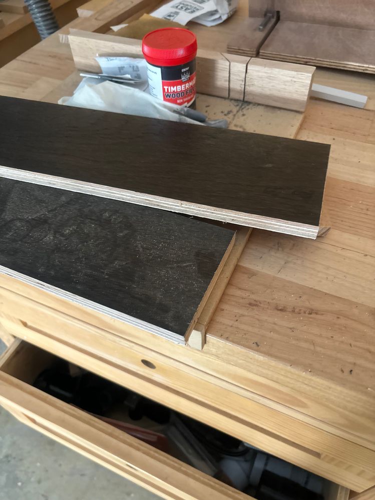

Cut floorboards to the size of tray required. Glue boards to the required width - mine is 285mm wide. Cut the tray sides to fit around the outside of the base.

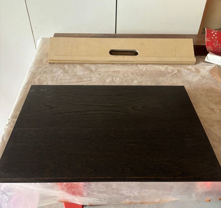

I cut out the slots for the handles using a jigsaw and router to clean up. I made a template to get a neat finish.

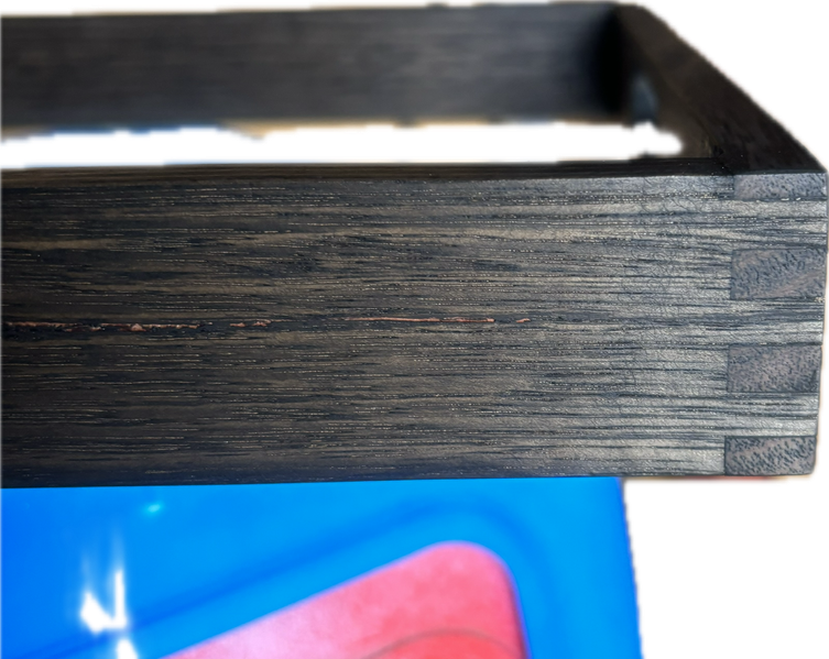

I also joined the ends of the timber by making the joints as a box joint, then glued.

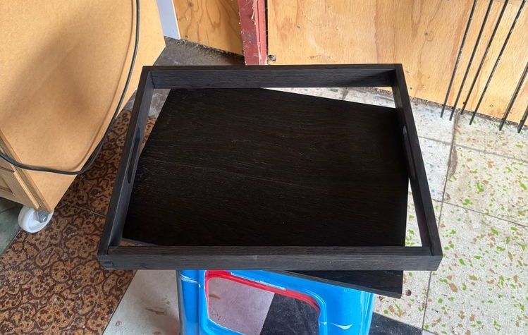

I pre-drilled the mounting holes on the side rails. I sanded the sides and stained to match the base. I used Japan black stain and clear varnish.

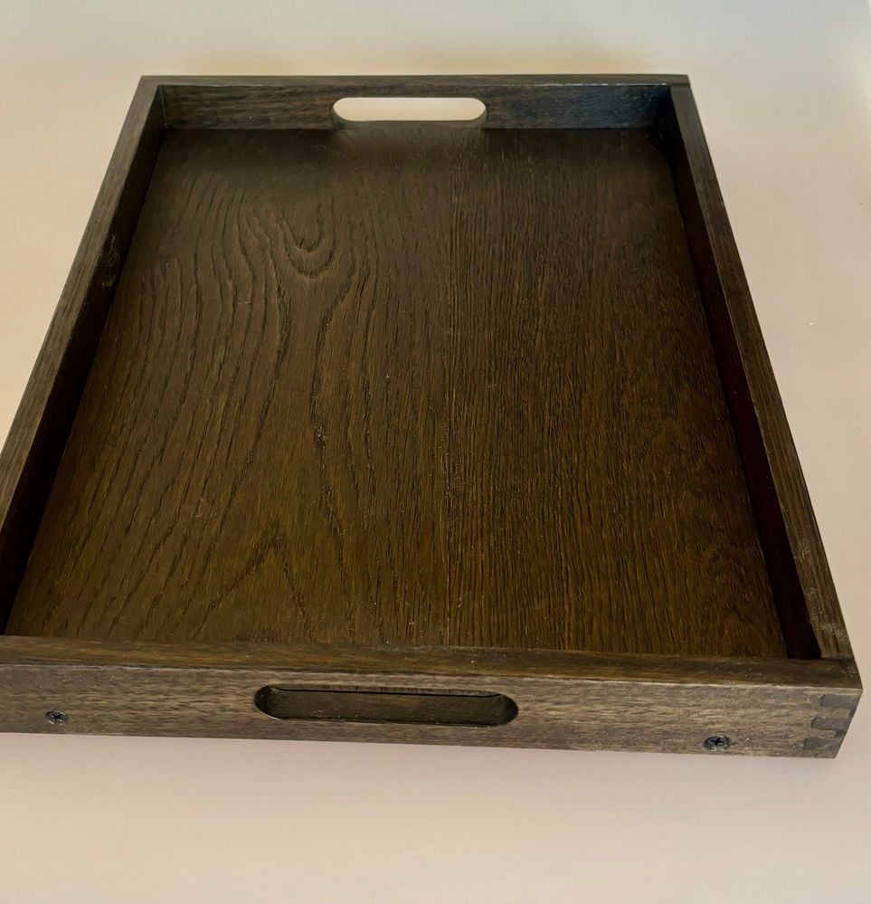

Once dried, I fitted the side to the base using black countersunk screws.
