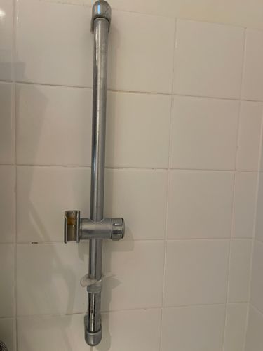

Hi can anyone tell me how to remove this bar? As you can see we need to replace the shower head and soap holder. I tried to take the top cap off Incase I can access any sort of screws but it doesn’t seem to budge, help please
Hello @april3
Welcome to the Bunnings Workshop community. It's sensational to have you join us, and thanks for sharing your question about your shower bar.
This particular model has the fixings cleverly hidden at the top and bottom fixings. The top housing is actually the cover, I suggest holding on to the top of the shower bar wall connection and sliding it outwards. Please note that it could be clipped in tightly, so hold firmly and pull.
I've placed an image below to give you an idea in which direction the cover cap is supposed to go. Repeat the same method for the bottom of the shower bar. Once you have the covers off, you'll easily see the screw fixings.
You’re amazing! It worked and I have managed to change this after 2 years of putting it off because I didn’t know how to take it off haha thank you so much! The best workshop!
