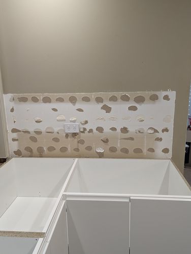

We've replaced our kitchen and pulled down the wall tiles, though we are now unsure if the gyprock should be replaced or plastered and sanded? We are replacing the tiles with stone, though it'll sit below the Powerpoint.

Hello @aaronrobertson welcome to the Workshop Community, have you tried sanding the area behind where the tiles were?This is the least intrusive approach but will generate lots of dust and take a bit of elbow grease (or an electrical sander) 😉

It's great to see you've already received some advice from @DIYGnome, who I agree with but would like to add a few points.A combination of sanding with a Trojan 120 Grit Angled Sanding Sponge and scraping with a Hyde 6" Plasterboard Joint Knife should get you back to bare plasterboard. If you find that the tile adhesive has ripped the white paper off the plasterboard exposing a brown cardboard like layer, you will need to skim coat these sections with a topping compound such as Gyprock Less Mess Topping Compound as paint will not adhere well to this part of the plasterboard.
Once this skim coat is done, you can sand the surface perfectly smooth before painting with a suitable interior paint.
Please remember to wear a mask, and eye protection when sanding as plaster dust is extremely fine and will hang in the air. It's not fun to breathe in and definitely not fun to get in your eyes so all precautionary measures should be taken.
