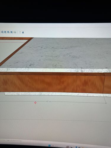

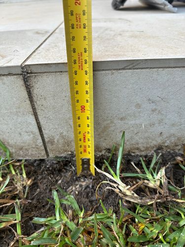

I’ve been thinking to deck the whole area of my backyard (see photo). The area is around 25 m2. I have a few questions:
1. Should I still dig the grass or just put a weed mat on top?
2. The clearance from the finish level (tiled area) is around 130-150mm. I am planning to use 90x45 H3 for my joist and bearers and Merbau for my decking. I will also use Builder’s Edge Pedestal and put some pavers and blue metal underneath to play with my level as some areas are not even.
Will this be okay?
3. In terms of connecting the timber to the existing concrete, what is the best way to do it?
4. Would you recommend to connect the deck to the blockwork retaining wall as well?
5. I will space the joist at 450mm and planning to put the Builders’s Edge Pedestal at 1000mm spacing. Is this enough?
