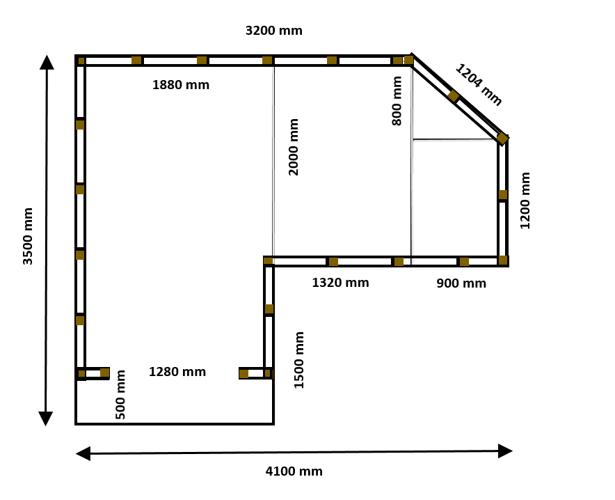

I want to build a garden house with a frame construction. One-storey, flat roof with ~ 30° angle.

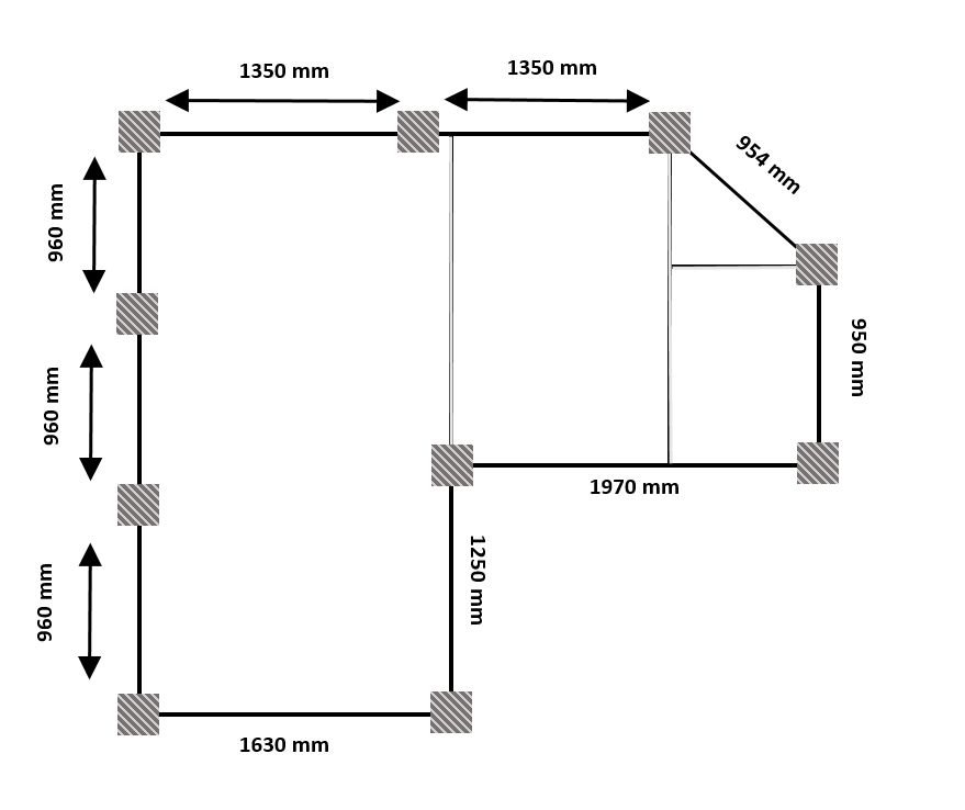

The garden terrain is rather uneven so the idea is to put the construction on brick or concrete poles to level the floor.
Now my question is, how do I calculate the number of poles needed respectively their distances from each other and
their dimensions. And what should be the dimensions of the joists to bear the load of floor, frame construction and roof
and how should they be connecting the poles.
The 1st image shows the frame construction, the 2nd image is an example of how the poles could be distributed but it is not based on any calculations or legal regulations so probably insufficient/wrong.
